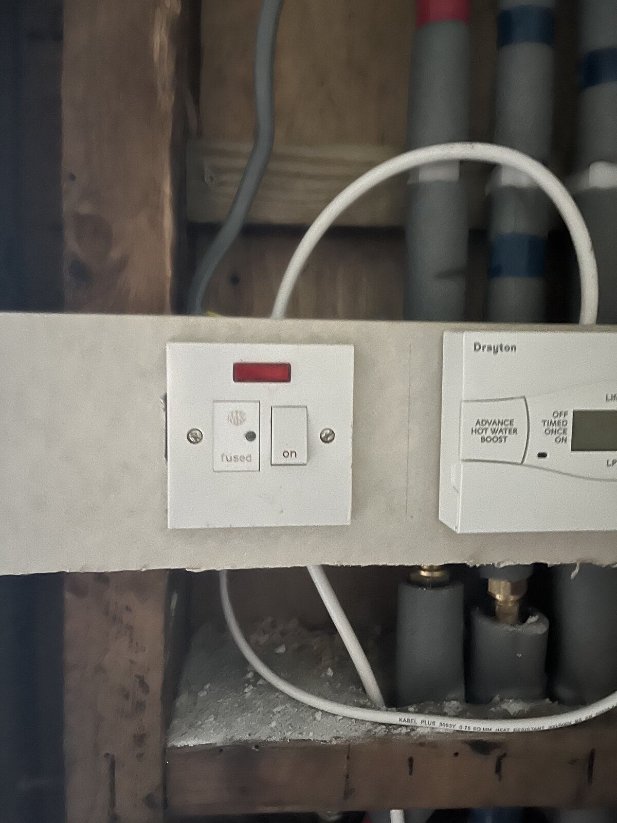

Hi,
I am looking to remove an old HW boost timer, but we still want the power to go to a fused switch for the new boiler and timer.

Do you have a photo of where (assuming the Horstmann is being removed) is a bit further back? I can’t see the flex cable, so can’t work it out in relation to the spur and Drayton.
The Horstmann is below the fuse box in a hallway and the cable runs through the loft to the spur at the other side of the cottage.
Sorry, just re-read, the boost will be for the immersion heater(s), so shouldn’t be linked to that spur. So should be removable without affecting the boilers supply.

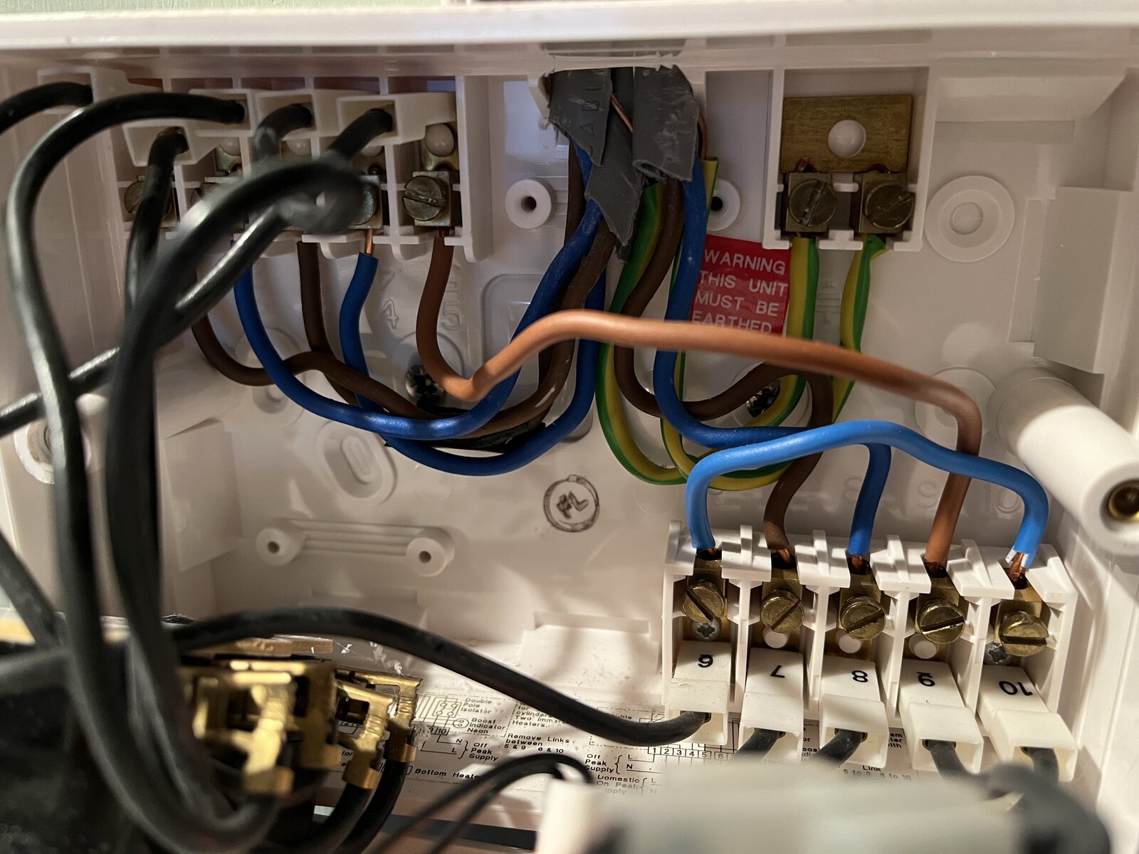

Hi CBW,
Thank you for the reply. I just need to figure out which cable is which as they run behind the consumer unit, then how to re wire.

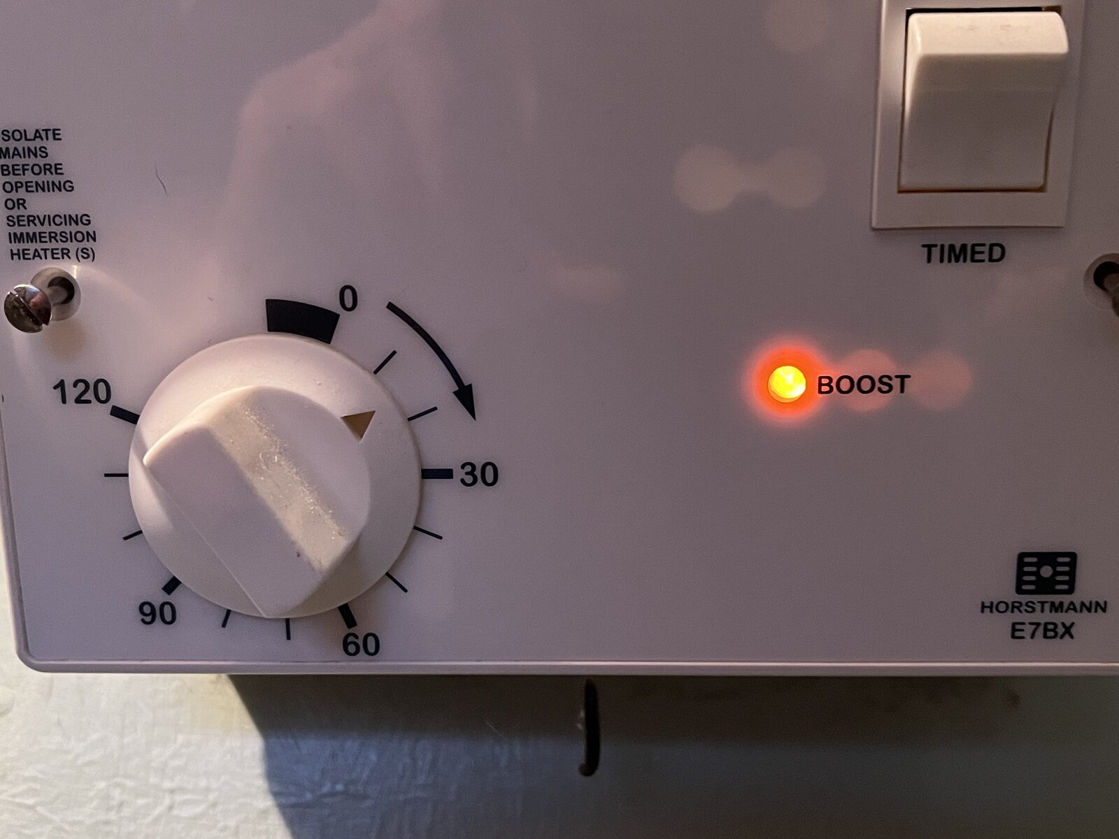

Can we confirm you wish to remove the Drayton timer and the cabling to the immersion heaters.
We have fitted a new combi boiler and the Drayton will be controls for that, but the feed to the spur is on the old horstmann timer. So only has power when the timer is put on.
You're saying the switched fuse in the pic is controlled by the Horstmann?
Prior to the Horstmann there should be some sort of isolator/fuse

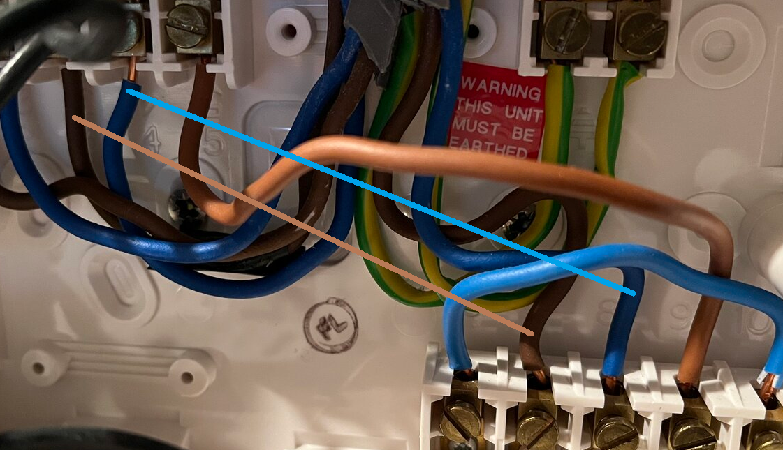

It might need to be tested/traced with testing equipment, but possibly terminals 3 and 4 which are the on peak demands.
As Chris says it needs testing to verify what you have there, but the basic expectation is the wires in 3&4 need to be connected to the wires in 7&8
and the wires in 1&2 (the off peak feed) is to be removed.

Thanks everyone….. we are going to use a single socket for the feed to the new controls and remove the old spur and wiring all together.
If that existing fused switch is in the right place.
If it is controlled by the Horstmann,
If all the cables pass behind the consumer unit.
Then while removing the Horstmann and the 2 cables from the consumer units, it makes perfect sense to divert the cable into the vacated MCB/RCBO rather than plug into a less convenient socket and lose other use of that socket.
