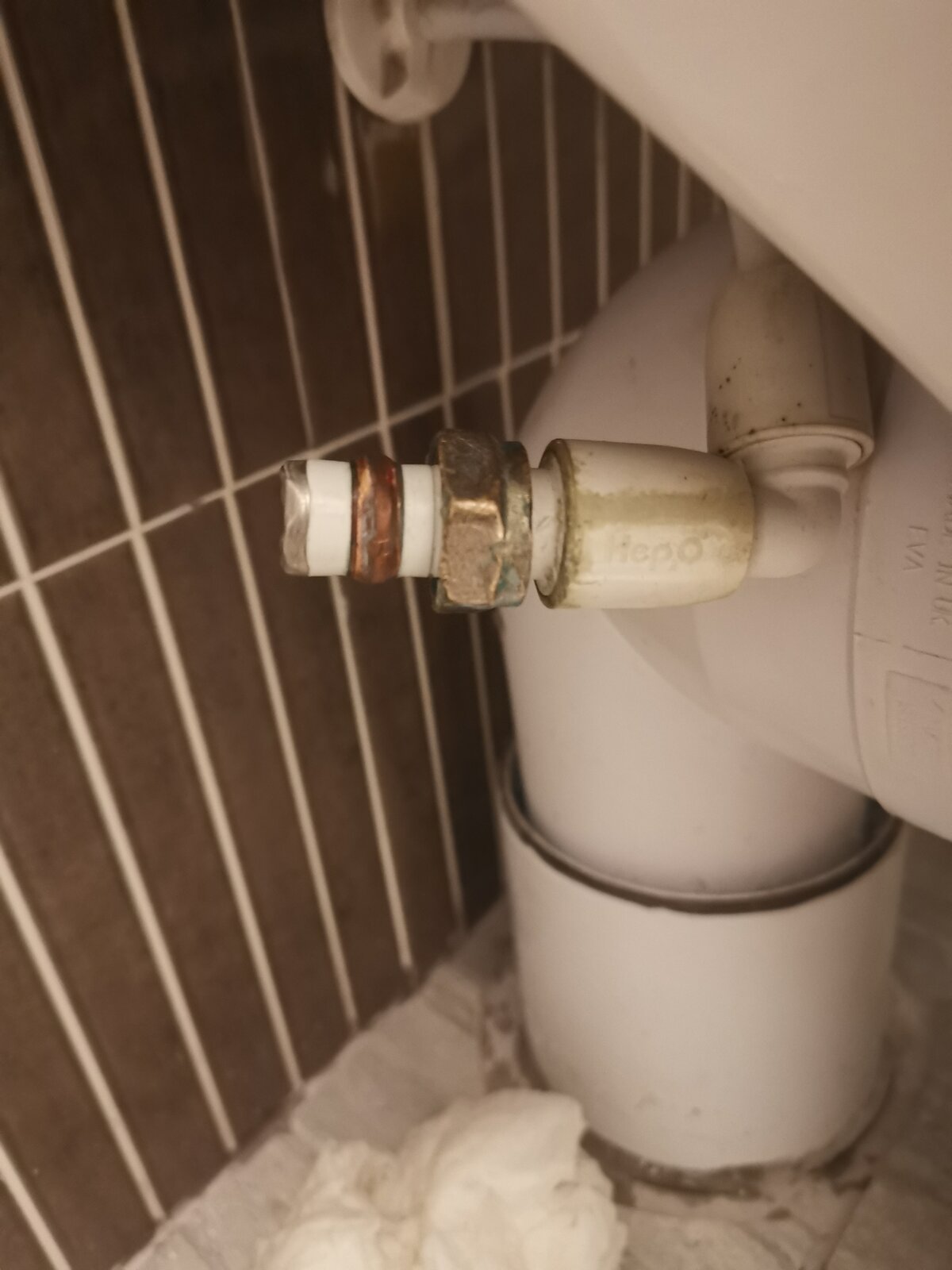

Hi what would be the best way to remove an olive from an old isolation valve which is stuck on our toilet water pipe?
Was tempted to carefully use a junior hacksaw

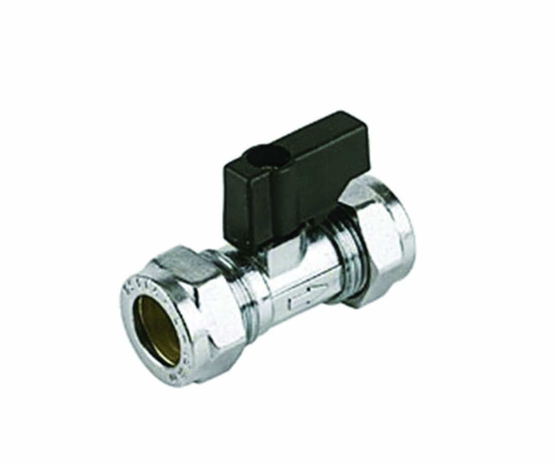

Also once off I bought a Lever isolation valve as it was a nightmare trying to turn the old one off once it started dripping with a screwdriver. Am I right in thinking I need a female coupler to connect to the other end of the valve and then to the toilet?

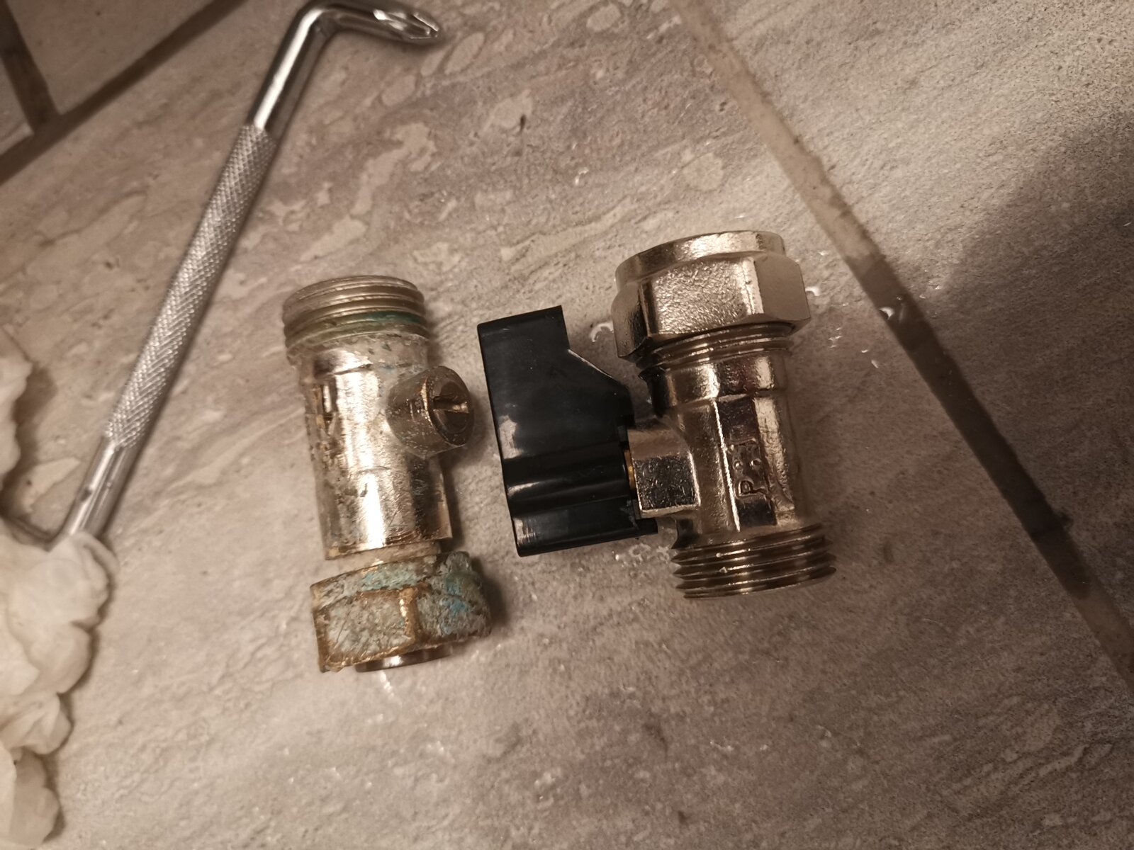

I've just used a new olive and the new Lever isolation valve trouble is I now need something to connect the end of the valve to the inlet valve as the ends different to what I used before.
Managed to get the old olive off and have attached the new valve.

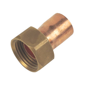

Would this be ok
Tighten to the other end of the iso valve and then should just screw onto the toilet valve
Would this be ok
Nice ideal but probably won't fit. That's fitting is designed to slip over a standard 15mm copper pipe and then be soldered onto it so a standard olive and fitting will probably be too small to take it.
