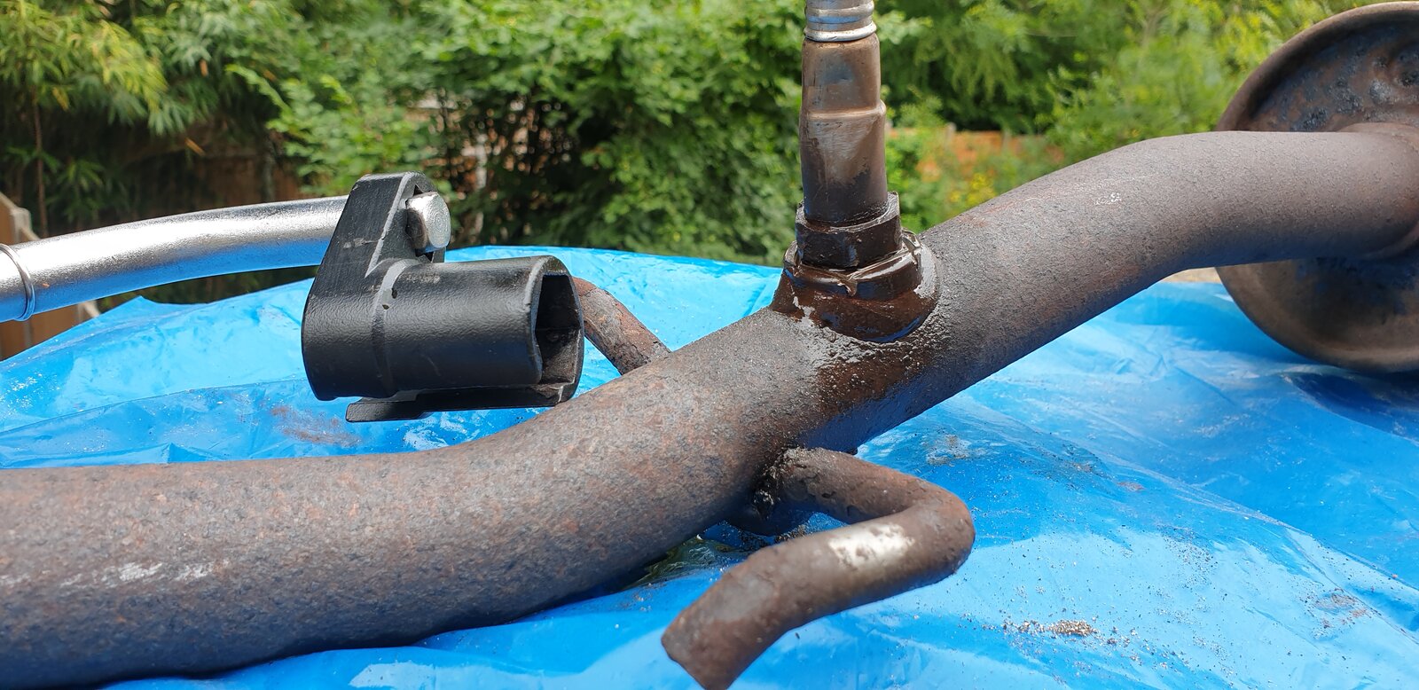

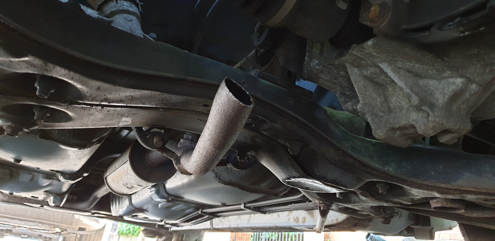

    I am trying to extract this oxygen sensor so that it can be used again in a replacement exhaust.
    There are many examples on YouTube of folk doing this but just about in all cases, contrary to my objective, they are attempting to replace a new sensor into an existing exhaust. So far I have avoided cutting the section of pipe that holds the sensor away from the exhaust in order that I have something substantial to turn the wheelbrace against. You can see that I have tried to saw vertically into the sensor seating hoping that this would weaken the connection. I have a heat gun, a blow torch and ultimately an angle grinder but so far have been reluctant to use these for fear of damaging the sensor. Anyone been confronted with this type of problem before?
    Any advice much appreciated. :cautious:

    For sure, these things can be ferociously tight, and those split spanners are a waste of time, 95% of the time.
    You need to get the pipe in a vice, really.....you may have a ring spanner that would fit, if the electrical connections would pass through. I have a huge adjustable spanner that I call on here - it must be 14" long :eek:.
    Anyway.....consider grinding the housing away down one edge, until the sensor threads are just visible and then trying to unscrew. Once the housing has split, the sensor will unwind. By all means heat the housing directly from below the sensor if you think it would help.
    If all else fails, the genuine sensors aren't so expensive but I wouldn't buy an aftermarket one.
    John :)

    A big pair of stillsons with a scaffold bar should do the trick.

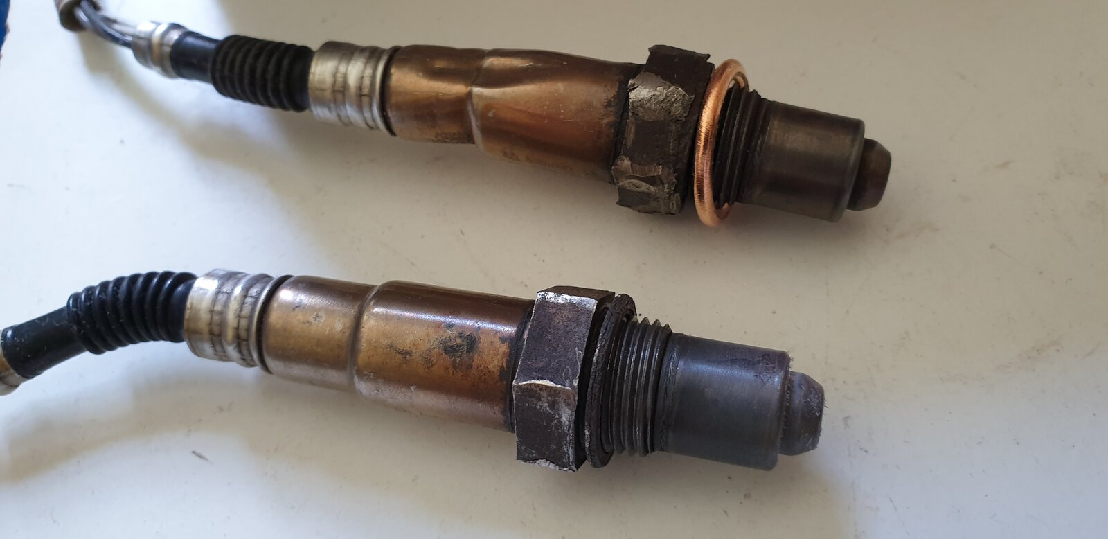

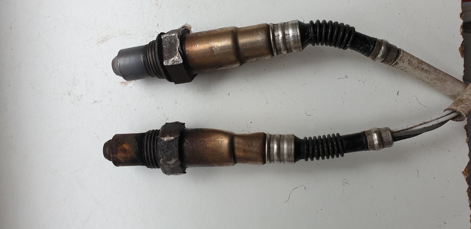

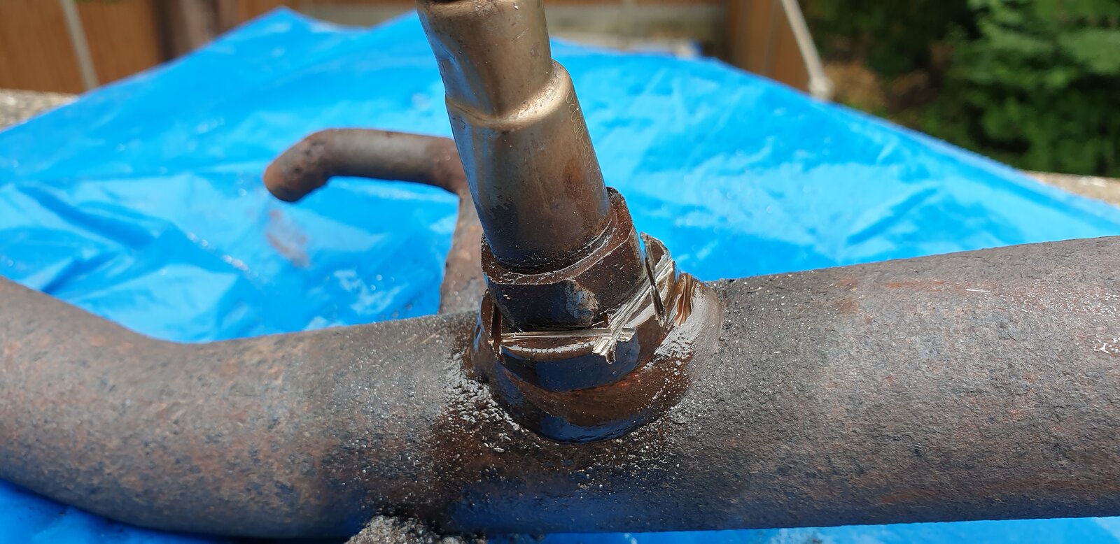

    Well with a combination of the 12" adjustables and with the basin spanner on the end plus some liberal use with the angle-grinder I managed to get them out. The exhaust sensor (the one below in photo) took about an hour and the one twixt manifold and catalyst a piffling 20 minutes. So thanks for your tips, guys.
    Just a couple other things, the front sensor was fitted with a small seal and presumably I require a replacement to go back into the new exhaust? Perhaps I can just buff up the existing for this? Also the received wisdom appears to be that I need to use dielectric grease when reinstalling the sensors – Permatex seems to be a regular product. Any views?

    Seal wise, I just use a copper washer if there's one missing......seriously you don't want any leaks.
    I can't say I've ever heard of dielectric grease, I just use ceramic brake grease and it seems to be fine - but once in the sensors stay there :mrgreen:
    Well done for persevering with this - it does make you wonder just how they can be so tight! I've never had success with my split socket to remove them but I do use it to screw them back in.
    John :)

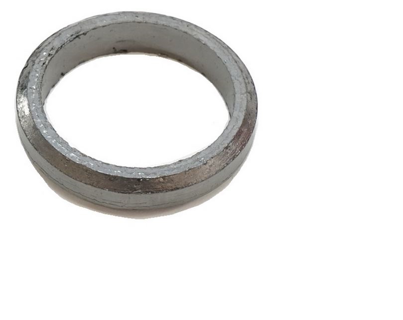

    Well given that there appears to be a week or so delay with getting stuff from the bay I ventured out yesterday to our (seemingly) one sole motor factor – Halfords. Absolutely buġġer all cbg, though be reassured, they have around 12 varieties of car wash soap and 28 different types of body polish. I will try somewhere else today. :rolleyes:
    Yes, so I understand. What is confusing, though, is that the sealing gaskets that go between each of the bolted unions of the replacement exhaust are also referred to as crush washers. It would be more meaningful if they were called doughnut gaskets etc. Maybe it’s just me? :unsure:
    The silicone is on the way through the post evidently. There appears to be about a week’s wait on all things ebay currently so I am sitting by the letterbox.

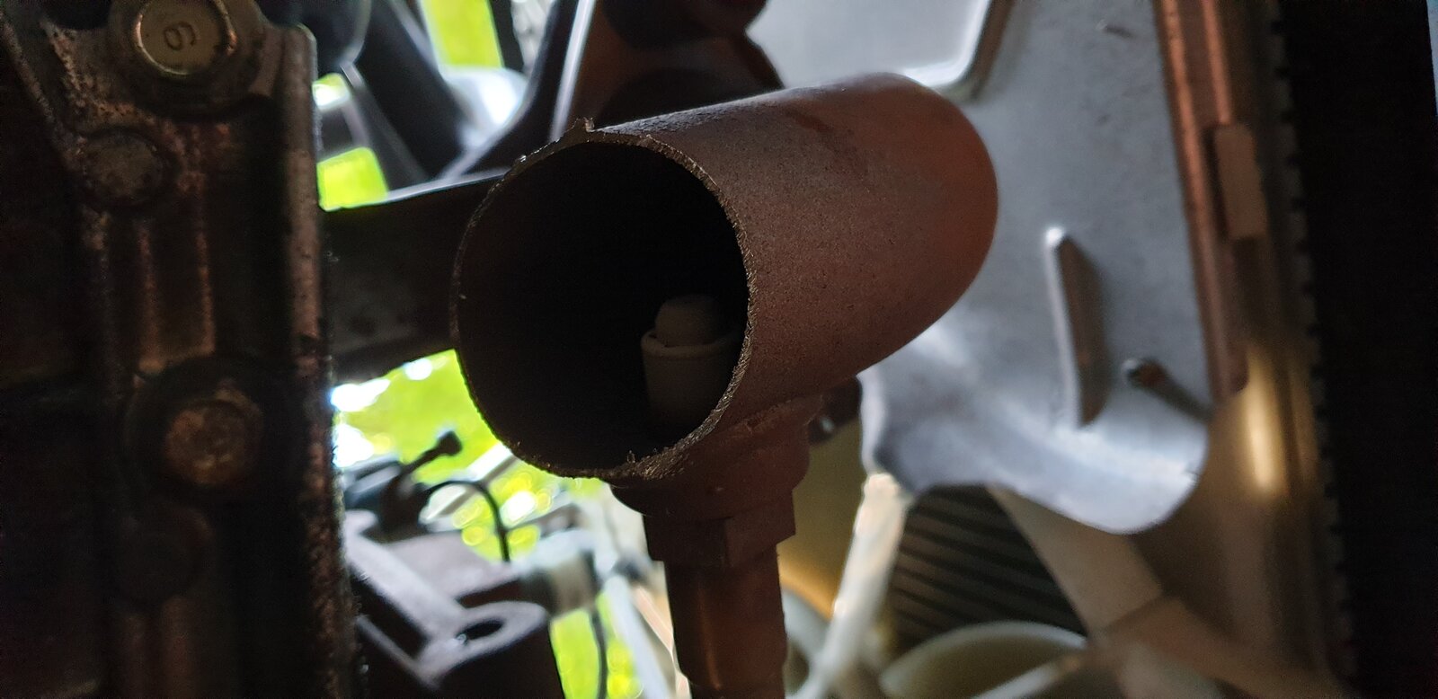

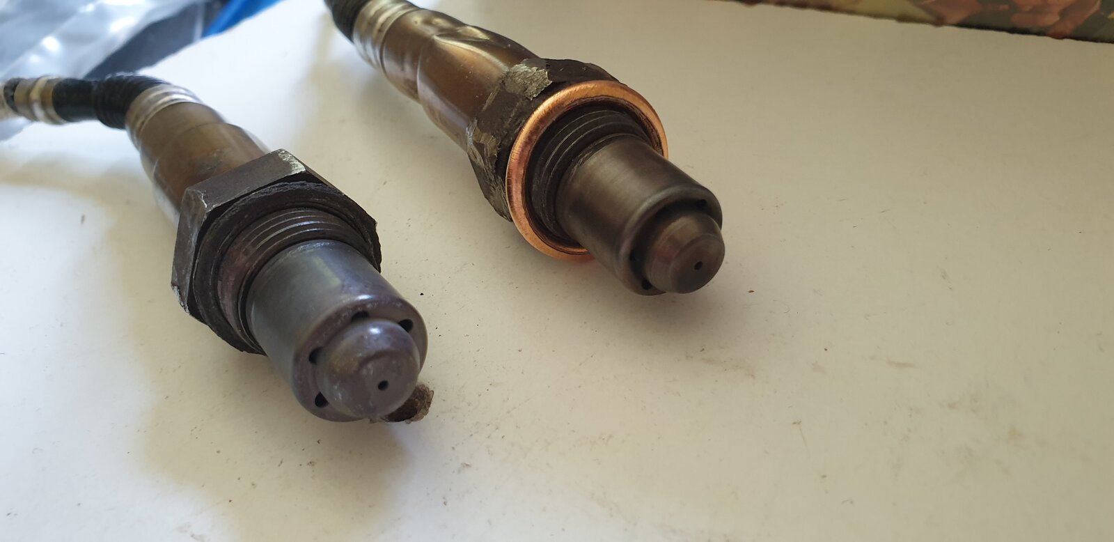

    Guys, I still have a couple of questions that I would like your advice on. The crush washers turned up today but they are quite different from the washer (seemingly captive as it does not unscrew from the thread).
    1) There never was any washer on the sensor between the manifold and catalyst - should I put one of these on or just rely on the sealant?
    2) The ceramic brake grease has yet to arrive but could I use Visbella gasket maker around the sensors instead? I was planning to run a thin ream around the provided gasket (made of wire mesh) but you may think this unwise in anycase.

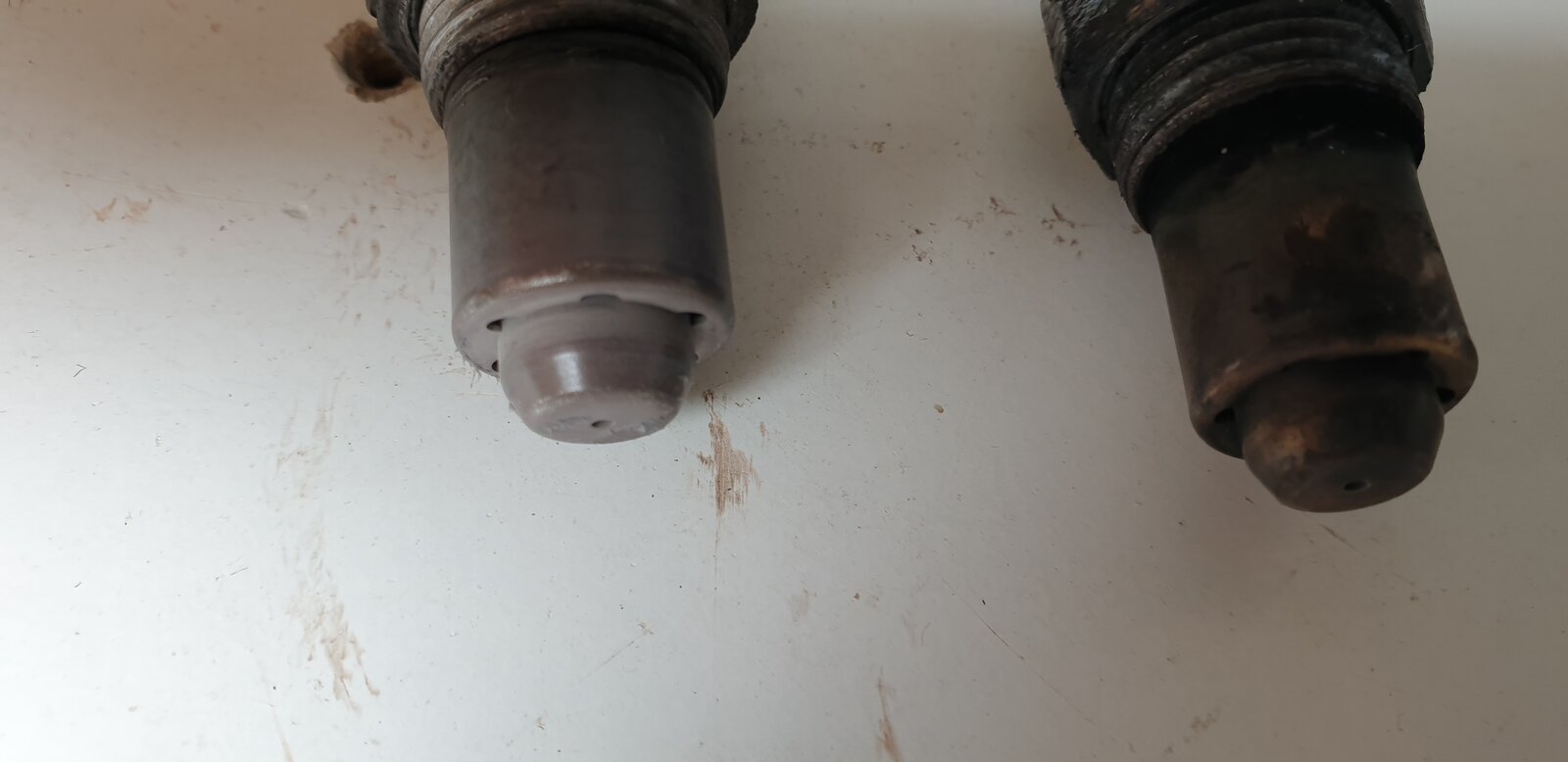

    3) It is necessary to clean the sensors before being reinstalled? There exists of YT a slew of vids demonstrating the need to remove the existing carbon. Some just recommend soaking in petrol, others spraying with carburettor cleaner, one guy even uses water – soaking and spraying.

    The crush washer is probably now captive as it's diameter may have been reduced slightly when crushing.....I'm sure you could shift it by using some side cutting pliers or whatever just to weaken it enough to remove.
    Any sealant won't harm a thing - I've never had a sensor leak anyway, and if you have a spare washer to go on the pre cat sensor then that won't do any harm either.
    Cleaning wise, I lightly wire brush the threads and tip of the sensor, then flush clean with carb or brake cleaner to clear the crap away.

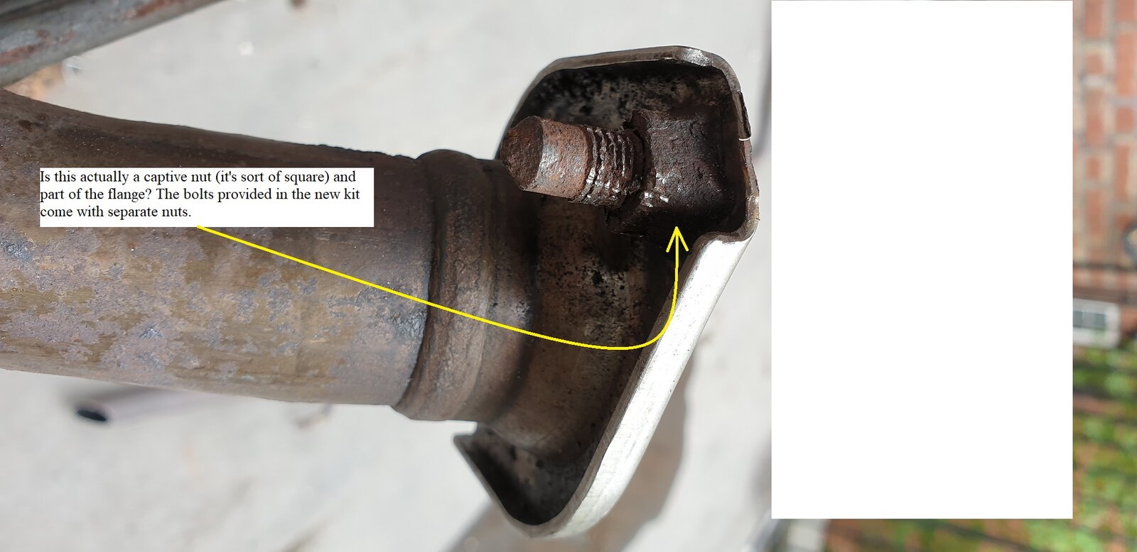

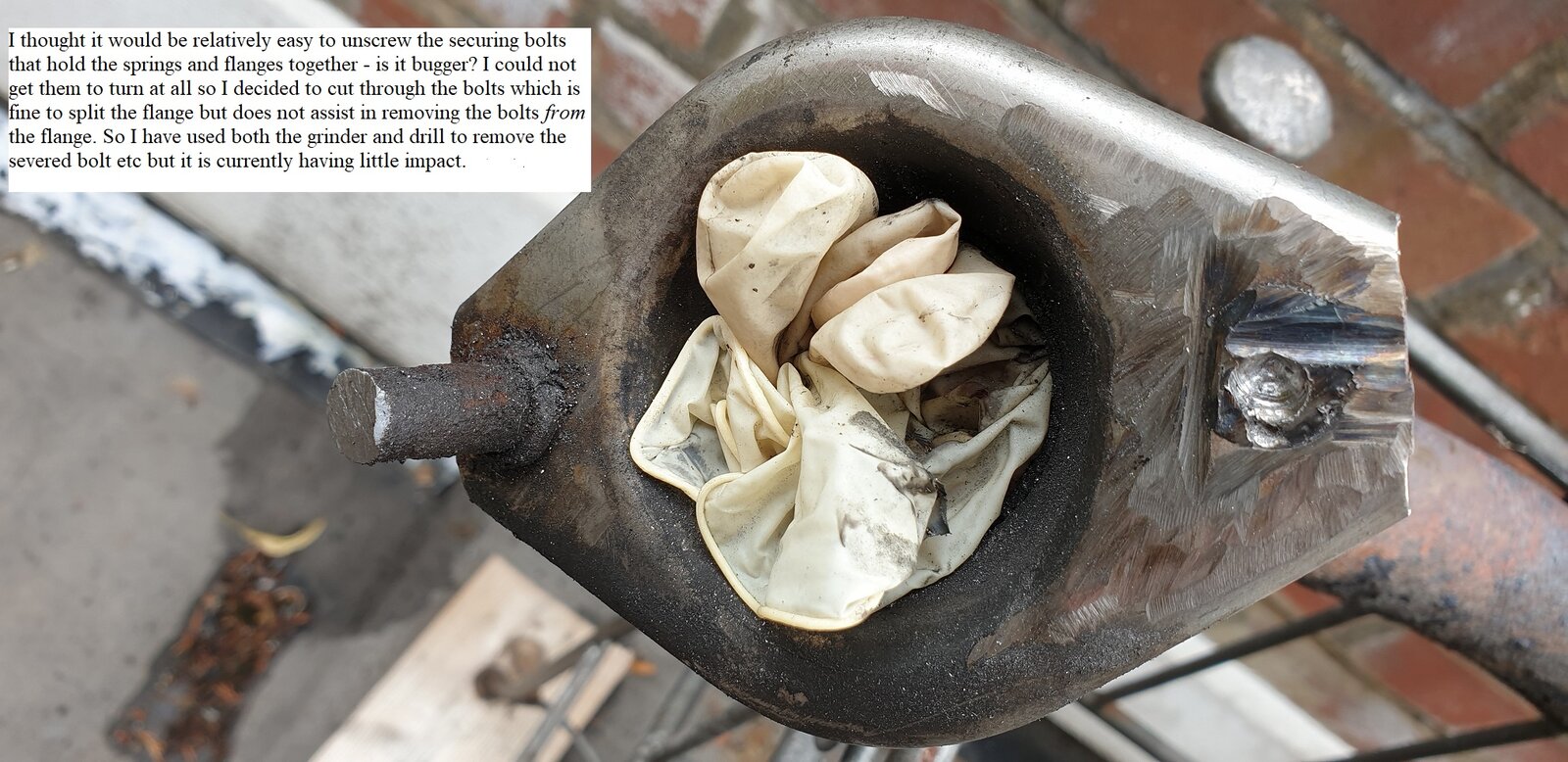

    Meanwhile I have had further problems with trying to separate the back-box section from the mid-section. I thought I could unscrew the bolts using wheel wrench etc but ended up sawing through the bolts.
    Am I likely to be able to salvage this flange? I have a blowtorch which I have yet to use. If anyone feels inclined to say, "Why don't you just get a new back-box, you tight bxxxxxd?", then that is absolutely fine, it is just that it appeared to be in pretty good shape . Thanks.

    That looks like the original manufacturer system, and yes that is a welded on nut - they are often that shape. Occasionally the manufacturers - in their infinite wisdom - use metric fine bolts too which are very difficult to replace :eek:
    The flange could be salvaged, but only if it's off the car - you'll never get enough purchase on it otherwise. You can (picture 2) maybe hold the end of that stud firmly in the vice and try to unscrew it one way or the other - or drill the stud away. A bit of a faff, to be sure but new nuts and bolts with a flange gasket should sort it.
    Good luck with it!
