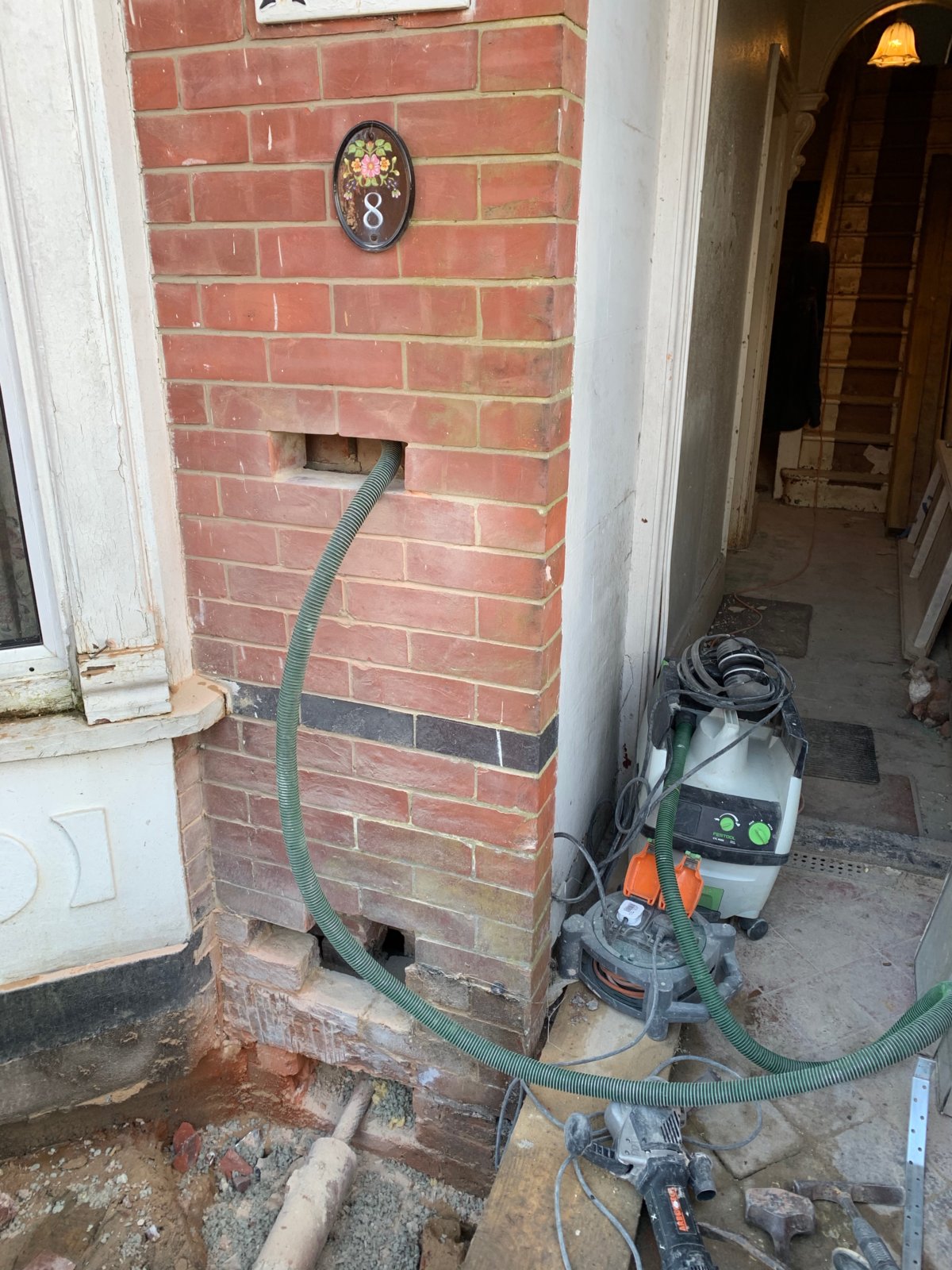

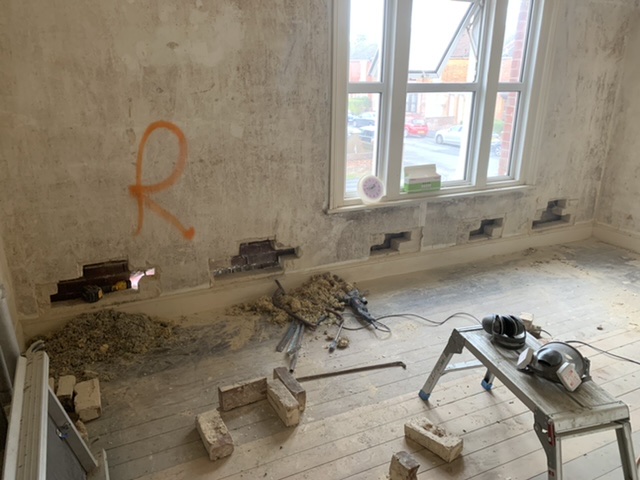

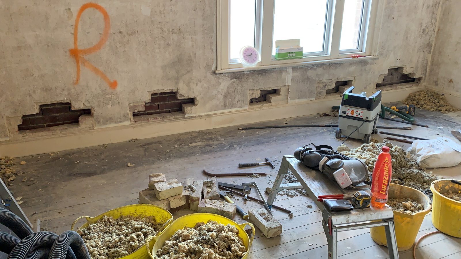

Ok... Well, after a bit of fussing I've got it all removed and have a stratergy.
So, the basic trick I found was, upstairs cut out some bricks ( I'm lucky I've got an Arbortech Saw ). Then use drain rods to dislodge the insulation ( and snots ) above. These will then come down to your level, then remove and dispose of then.
Then I used a work hoover and dropped it slowly down in to the cavity below. Below I found some more solid snots, so used a tape to determine how far down, then went outside, removed bricks and removed brick/tiles that were bridging the cavity.
Then got to the base of the house and dug down to remove the build up of soil / debris that was bridging the damp course.
