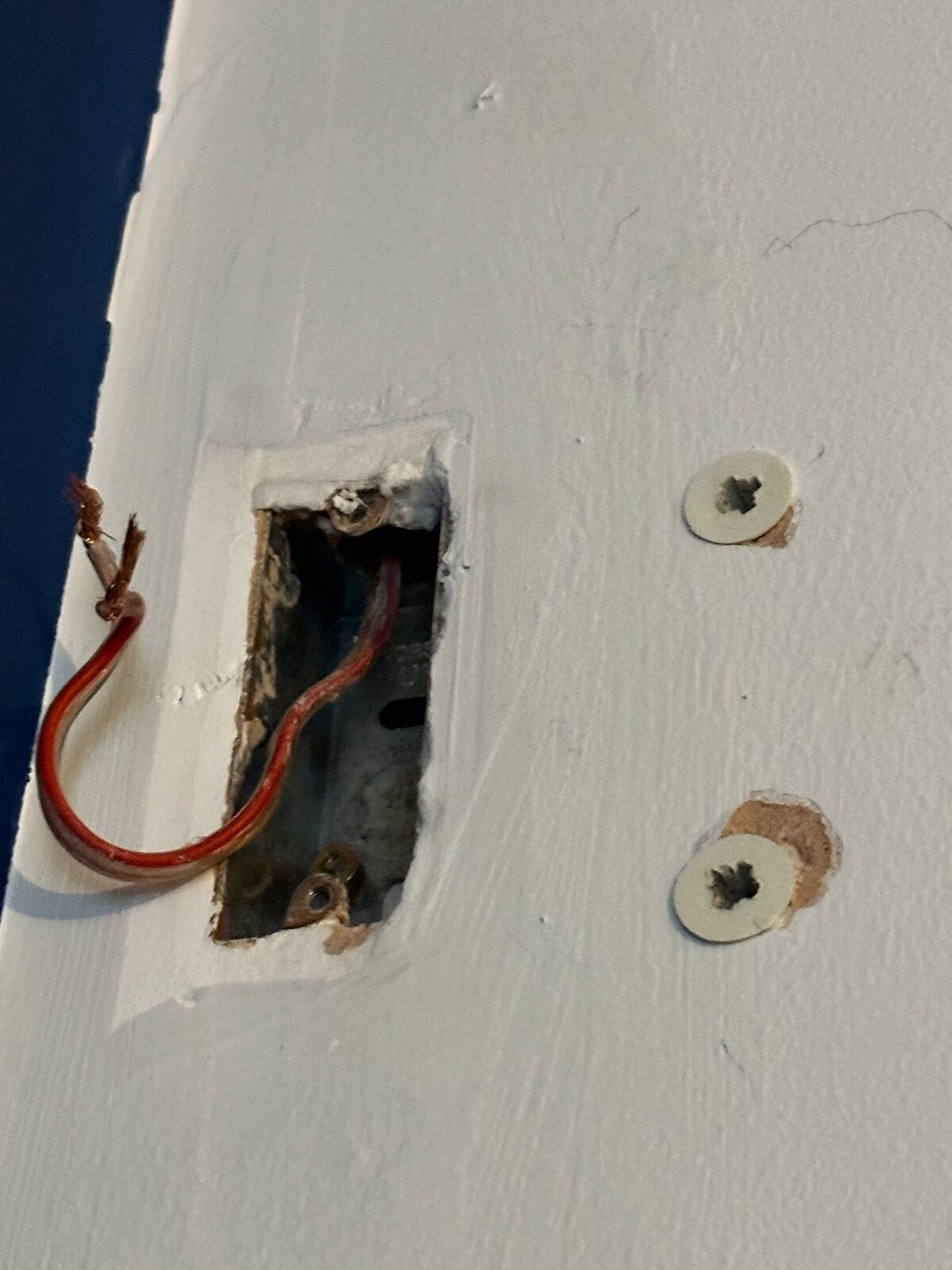

Hi everyone!
New to here so nice to meet you all

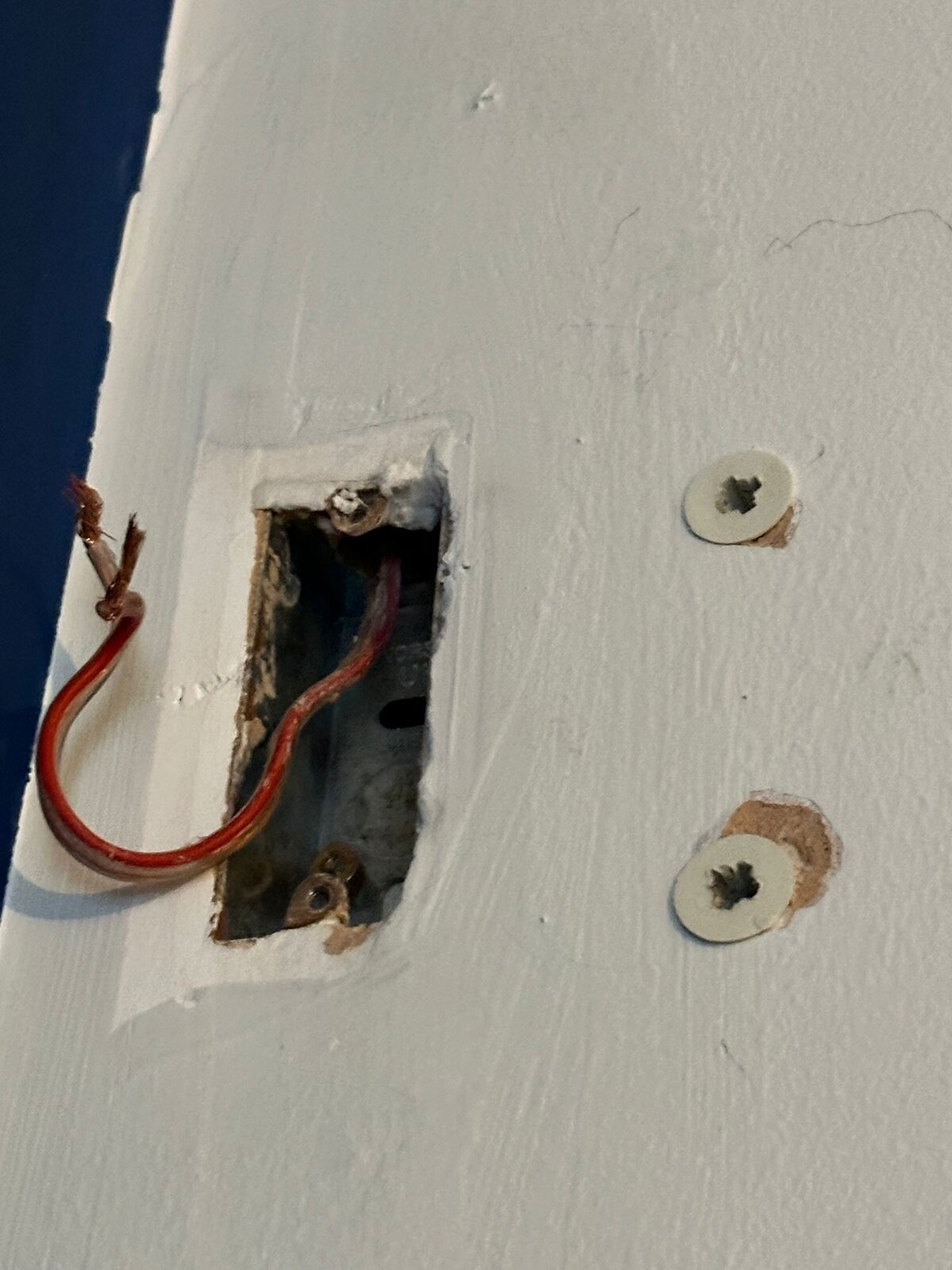

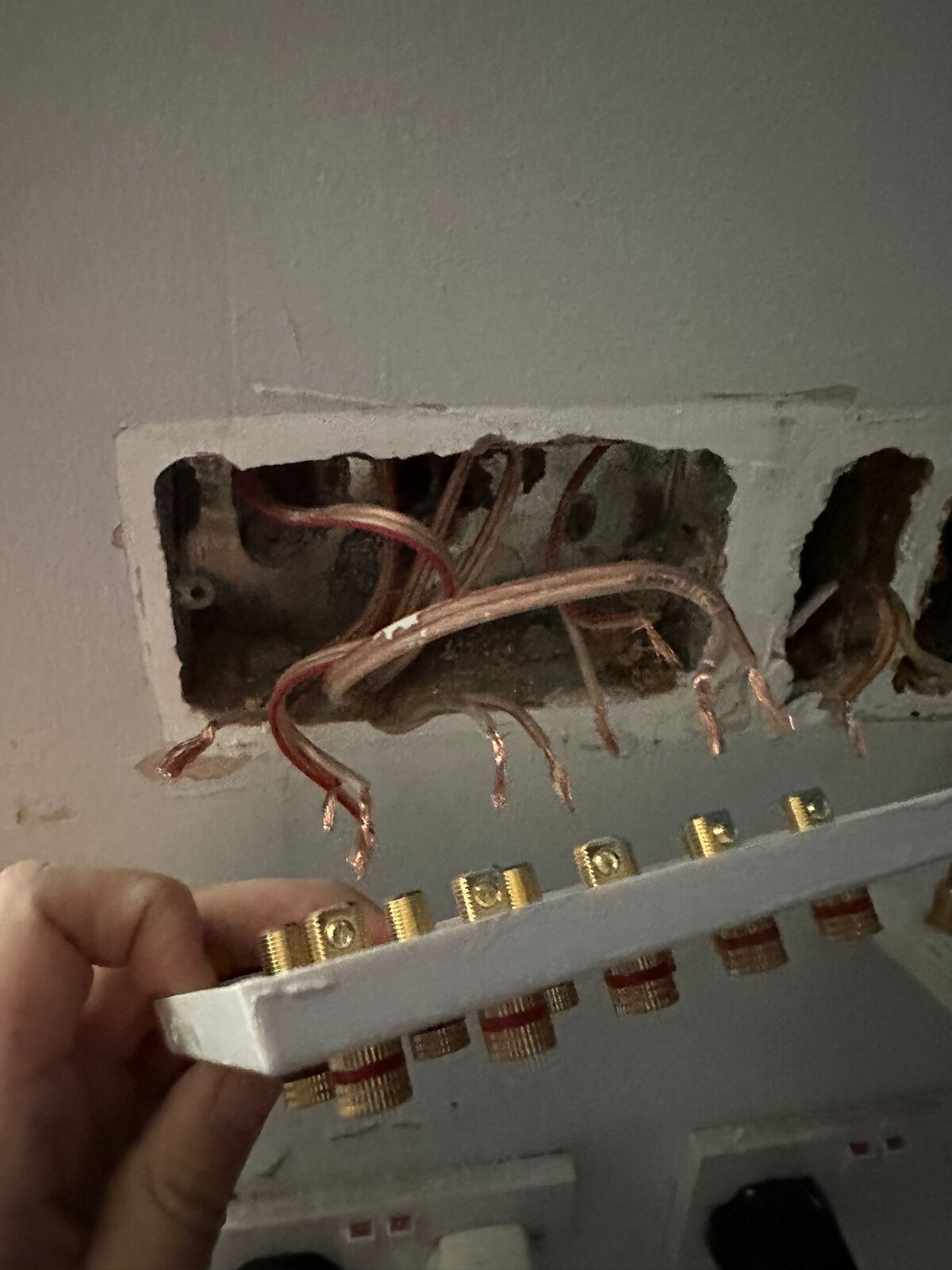

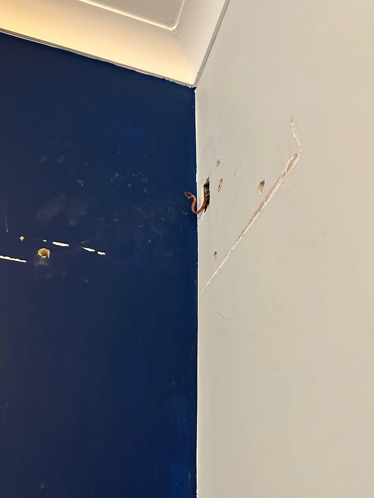

I am new to DIY... I just removed the previous owners surround sound system and now hoping to get some pointes.
1) what I should do to make safe the leftover black/red wires?
2) I also want to be able to fill, sand and paint over the holes from where the speakers sat (4 corners of the room) and also the wall socket which was used to control the speakers in different parts of the house.

so no chance of having anything in the future where that wiring maybe useful
it looks like just wiring to connect speakers front/back maybe a baseunit
i would see if i can get a small piece of plasterboard and cut to size over the gaps and fill
I did this myself only 3 weeks ago when redoing our lounge and managed to get a small piece of plasterboard from homebase
well, 6ft x 3ft and only needed 12"x12"
Image 2- You can unscrew those plastic wall plugs.
There are many ways to fill the old back boxes. @ETAF 's will work, or use a basecoat plaster such as browning and fill over the top with a filler of your choice.
One problem that you will have is that your walls have been painted pretty badly. You will end up with flat areas that meet heavy paint build up.
Thanks both - and do you have any pointers on what to do with the wires sitting in the back boxes? Can these just be left there?
Cut them off, as they will never be used again for anything.
Hoik the backboxes out of the wall as well if you want to fill it in.

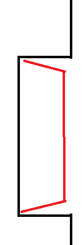

I usually go for thick cardboard before plastering. Fold it inwards to give a space for the plaster to key to the box. Just leave the cables coiled behind.
