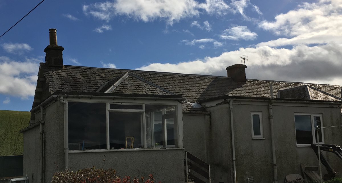

Want to remove the horizontal beams in the small extension bits of my cottage. So we can high open plan room with new bigger skylight.
Now question is are supports needed?

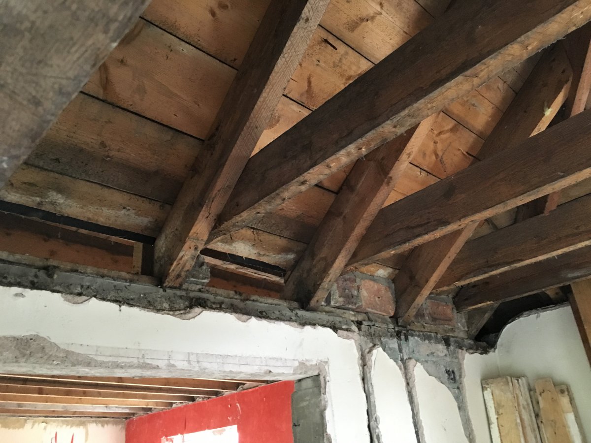

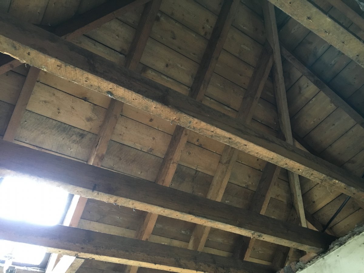

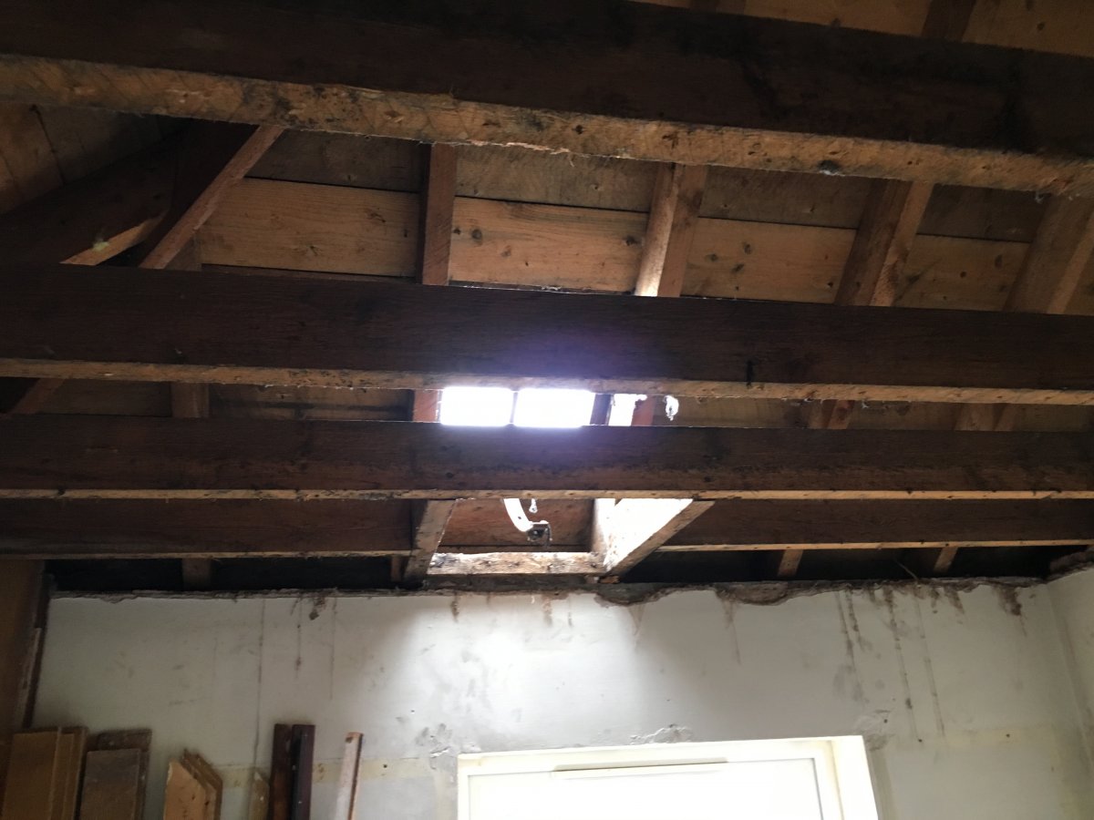

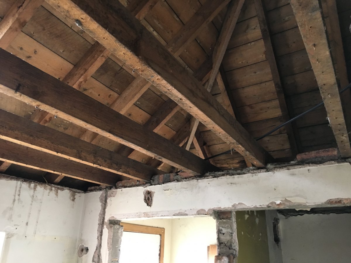

I have two of these in the cottage.
There are more than two there. What two are you talking about?
In any case they look like they are bracing the roof and stopping the walls from being pushed apart.
Building control would need to be involved
Two extension bits built exactly the same I mean.
That was my though they tie the roof in. Will seek builder for advise.
