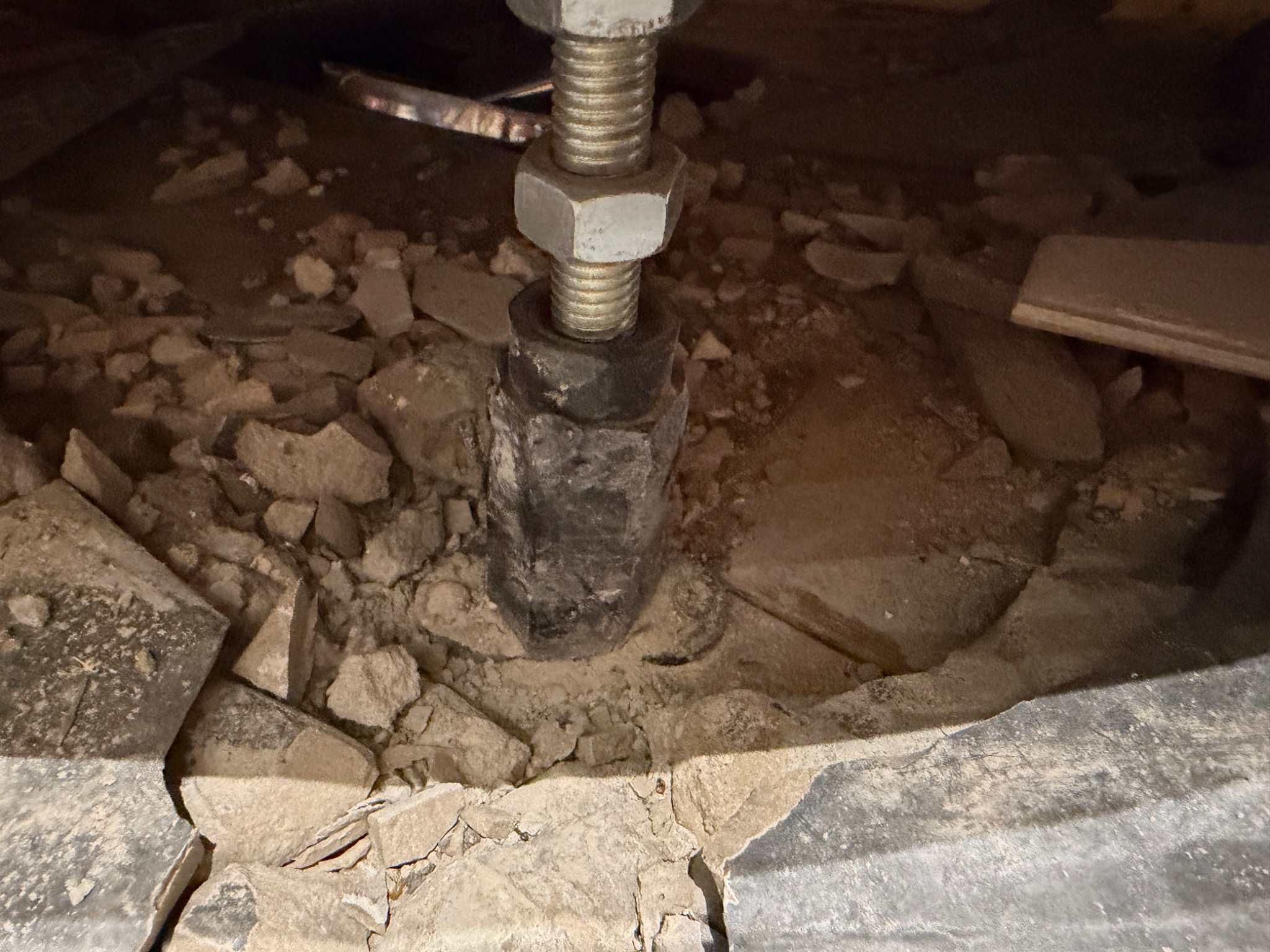

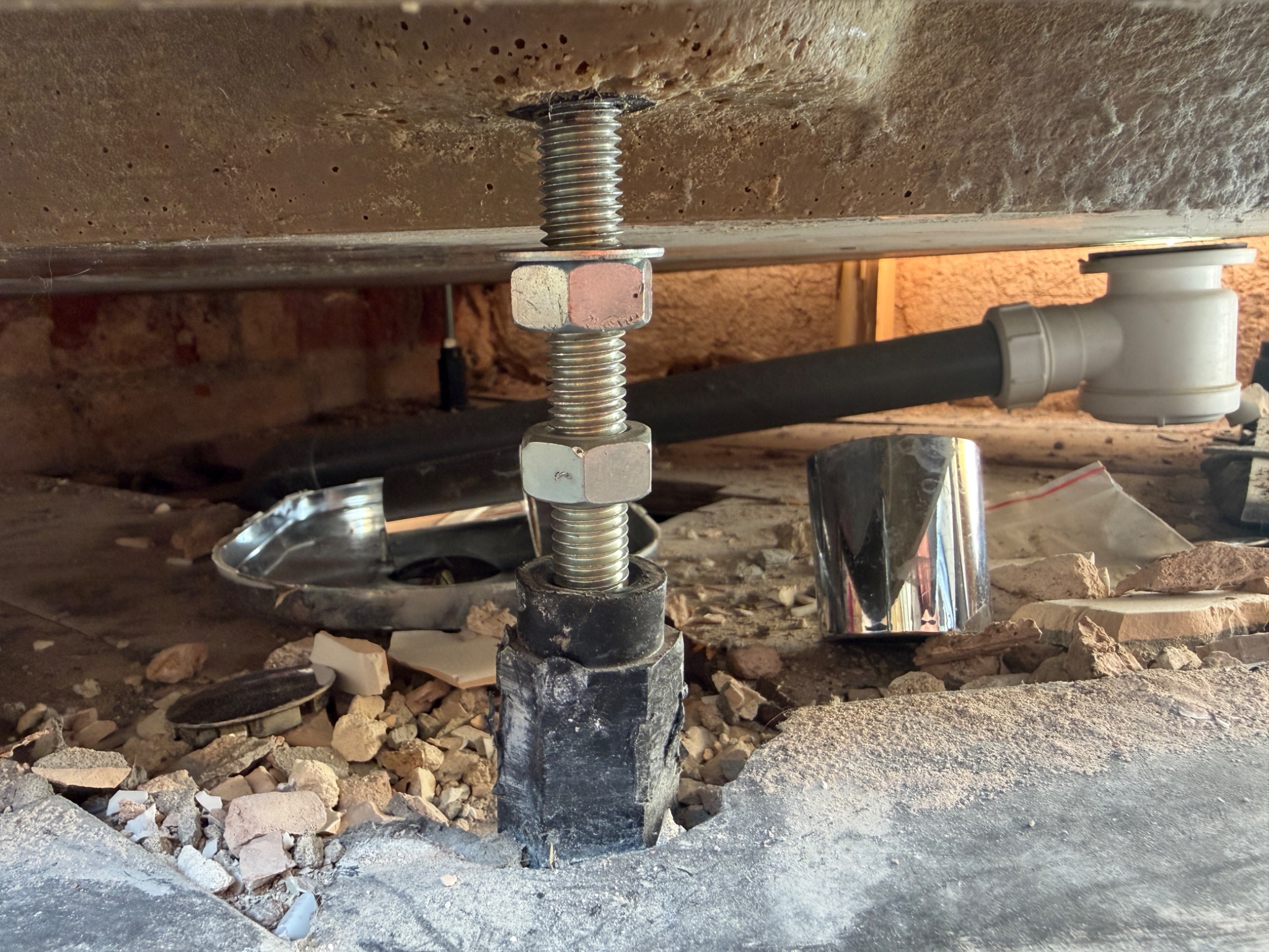

How do I remove this shower tray.
Have you removed all the wall, tiles, it should just lift out? The feet may just be stuck/catching on something on the floor.
You don't think is bolted to stuck to the floor?. I'll knock out the tiles close to the legs.
Thanks!
Looks like that standard foot has been covered in tile adhesive? Hammer and chisels and break it out?

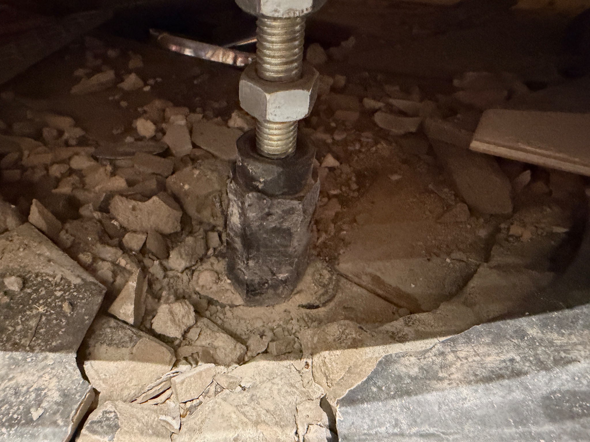

I found what's holding it in there were screws that are screwed into the wood in the floor.
How do you get a screwdriver in there and get any leverage in there,especially the ones at the back? How are they screwed in the first place?
They would normally be screwed in at an angle, so get a small screwdriver or the sharp end of a screw and clear out the slots in the heads of the screws, see what type of screw they are - phillips 2 or pozi 2 - and then use a battery gun with the correct bit to get them out.
