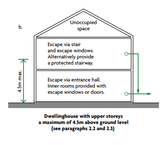

Apologies for hi-jacking this thread but its on the same lines, a protected stairway in a two storey house, ground and a first floor only.
No means of escape via windows, does the ground floor and 1st floor ceilings need to offer 30 minutes or is it just the tube of the protected stairway leading to a final exit.

If the windows on the first floor do not comply as escape windows then you need a protected staircase enclosure, walls, doors ceilings etc.
Generally the ceilings to the ground floor rooms need to be half hour fire resistance as well to protect the first floor joists as an element of structure. Irrespective of the protected staircase.
Seems a bit blunt that the document states this only applies to floors over 4.5m, the protected staircase can be upgraded to provide 30mins but the ceilings to the bedrooms and lounge floor are

Looking at part B fire resisting ceiling only come into play if floors are over 4.5m.

Smoke alarms and a 30min protected stair is adequate? You would only need to upgrade the existing ceilings if you are doing work that means the fire resistance of the ceiling would be less compliant than it was before. Off the top of my head I cannot think of any circumstance when that would apply.
Looking at part B fire resisting ceiling only come into play if floors are over 4.5m. Nope - that applies to dwellings under 4.5m too. But it is not retrospective so if the floor and ceilings are existing then it is not a problem.
A protected route is a route that has fire doors as well as 30 minutes walls, floors and ceilings.
This is not required in two storey houses.

The point is, the regulations do not require a protected exit route in a two storey. The risk is different to three storeys and above
I thought they did if there were no escape windows?
Is the OP building a new house?
No its a two storey extension on to an existing two storey detached house. Means of escape windows are not feasible in the new room.
The three other bedroom windows do not have escape windows, but they are existing and not being changed.
