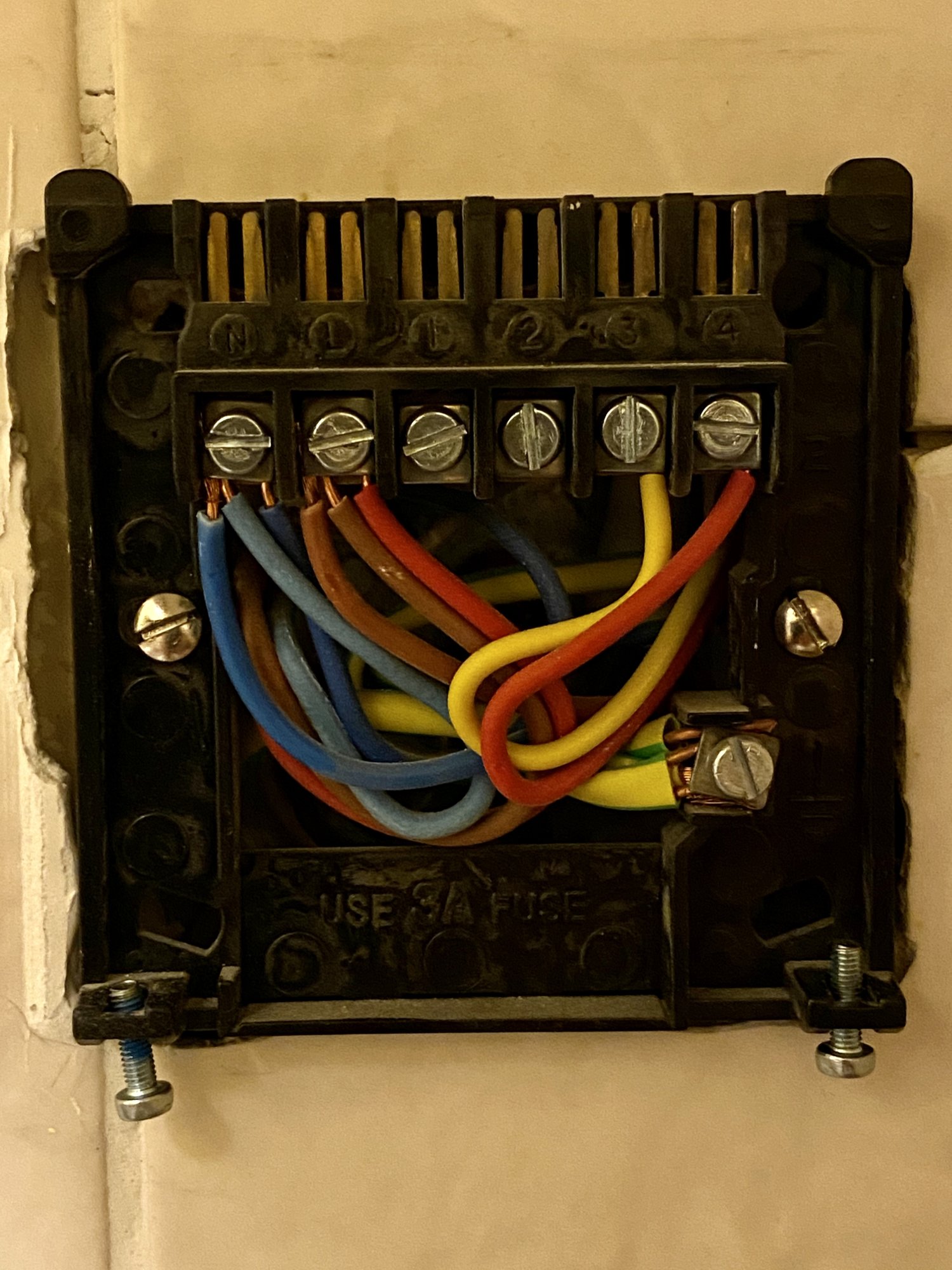

i understand I need to bridge the connections after removing existing wiring at the junction box. I’ve taken a few pics of existing writing which should hopefully give an idea of my setup.
thanks in advance.

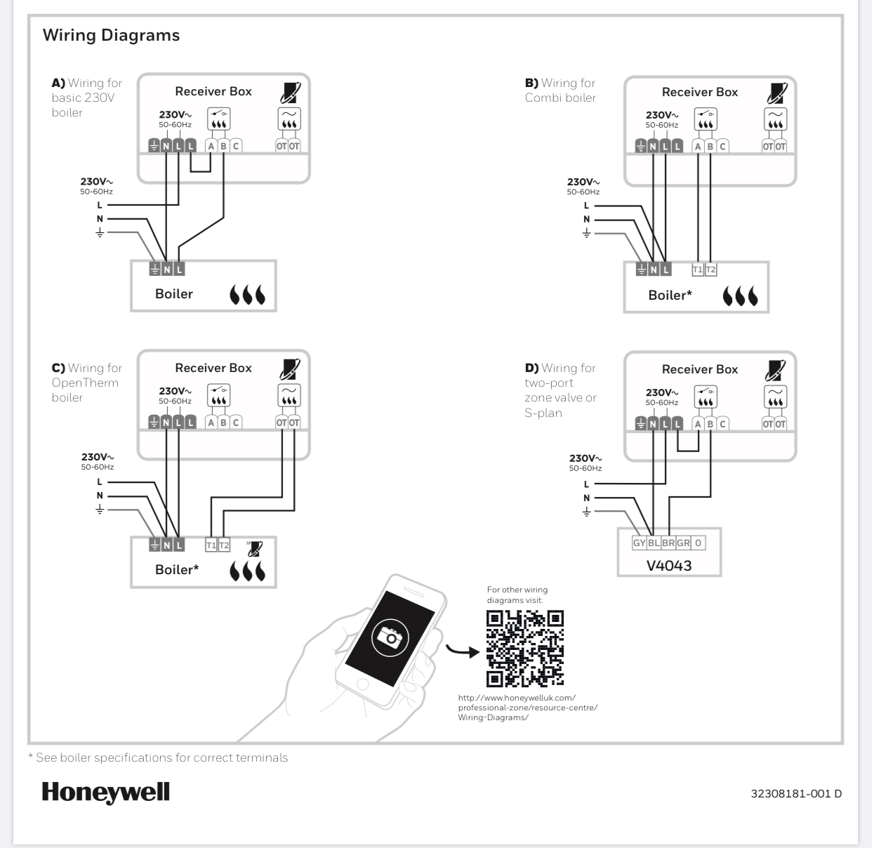

I can't see the wiring in the Honeywell receiver clearly. Is the brown wire in the right hand (L) terminal connected to (A) next to it with a link wire?
Also, is the other end of the yellow wire in Honeywell (A) connected to terminal (2) in the wiring centre marked roomstat call?

- yes, the brown wire at the receiver is a link (I realised that pic might cause a bit of confusion as its not entirley clear)
- yes, the other end of the yellow wire (B) is connected to terminal (2).
