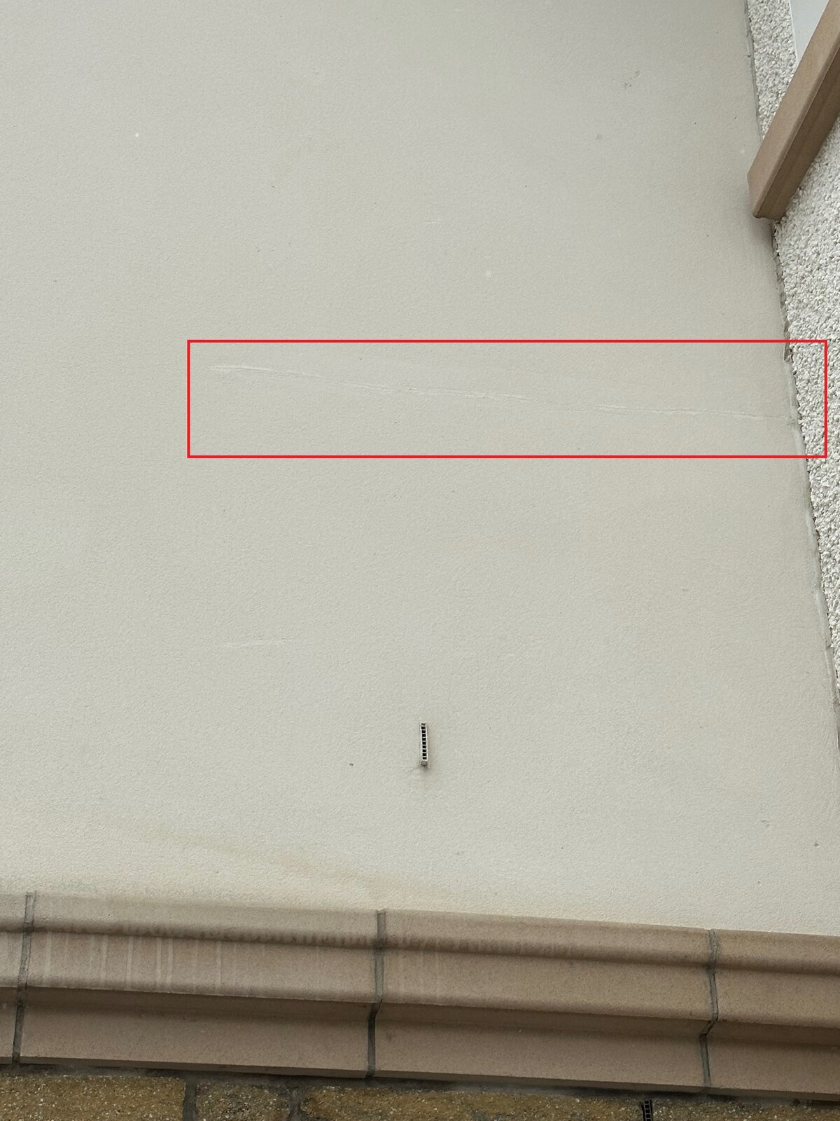

We have some areas of smooth white render (monocouche?) at the front elevation of our property, and the remaining is roughcast (pebbledash). Its a new build about 9 years old.
We're looking to get the smooth render cleaned as well as the roughcast (chemical and doff steam cleaning).
The smooth render requires some minor repairs (i.e. small holes / cracks to be filled etc).

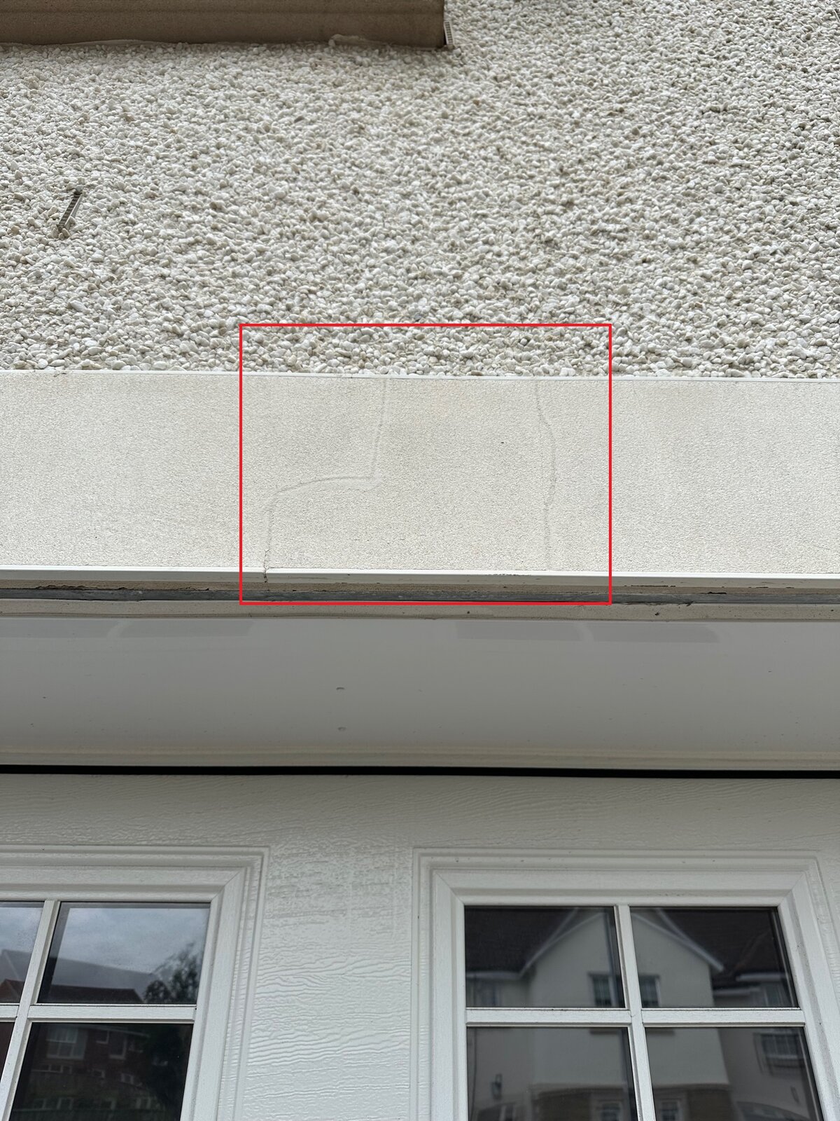

However I'm in a bit of a dilemma as whenever we should use this also on our smooth render or not? As i've stated, we looking to get repairs carried out (patching up any minor cracks and holes as part of the cleaning process). I believe a colour based rendering filler will be used (k rend fill). But from experience colour matches on render repairs are difficult at best.
We also have existing repairs carried out in the past which are still visible (see photos below). These are some what blended in due to weathering, but they may become more noticeable once the areas are properly cleaned.
