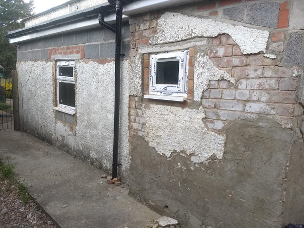

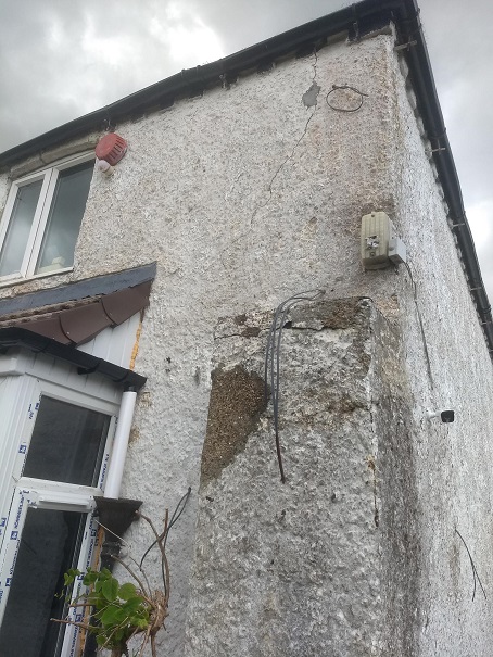

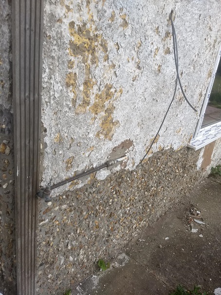

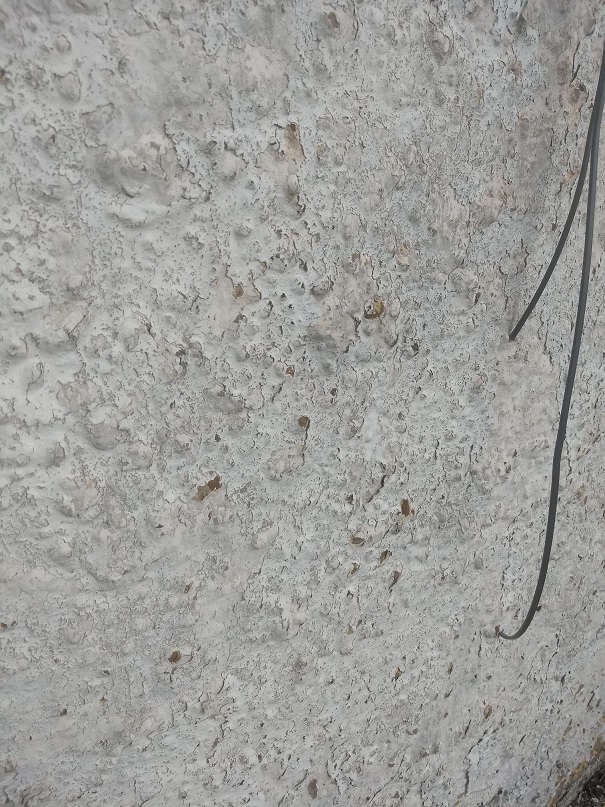

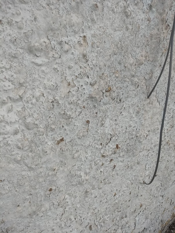

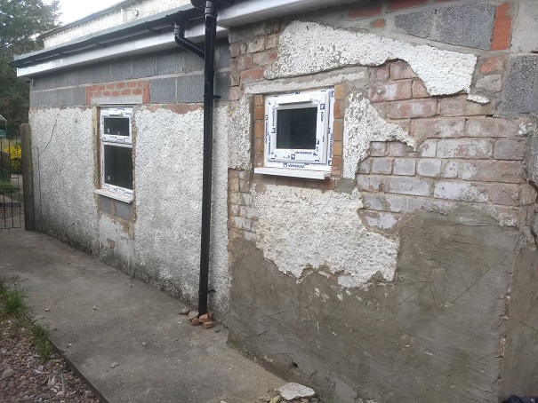

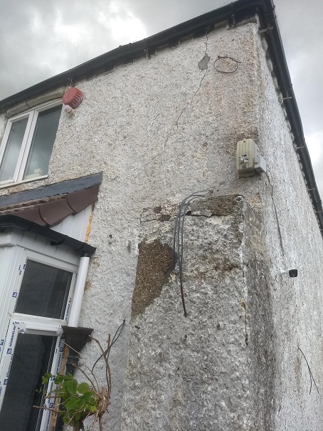

Here are a few pics - cracks to repair, surfaces needing new render, flaking paint ... you mention it, it needs doing!

Didn’t see that one coming:D.
All needs redoing.
Yup thats for sure. So is Lukes description of the methodology still good for today (his post was very old)? Cheers! :-)
What’s your intention? hack off and re-do or patch it up?
patch it up.
I anticipate being here for max 5 years .. Im already at the end of my tether with the place.
Today ive been taking off loose render up to my head height. And although quite a bit has come off, that which is still in place seems to pretty firmly stuck.
