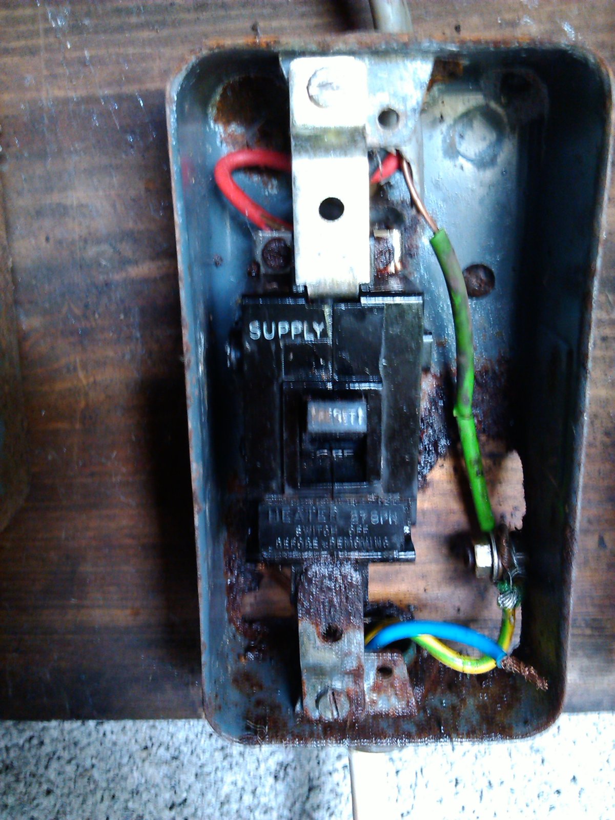

>TTC..thanks..yes you're quite right about the photo..apologies! Here is one of the rectangular MEM "switch" taken earlier this Summer when I was working on the pump...the power was off at the meter and the first (LH) switch!! I had disconnected the blue N wire.
As you may be able to discern the switch has "Reset" on the end of the switch itself and underneath is the word "Heater"(?
This "kit" was in place when we bought the house thirty odd years ago and as I said it has worked without any problems all that time. The only change is that the (dedicated) meter was replaced free, presumably due to its age, relatively recently.

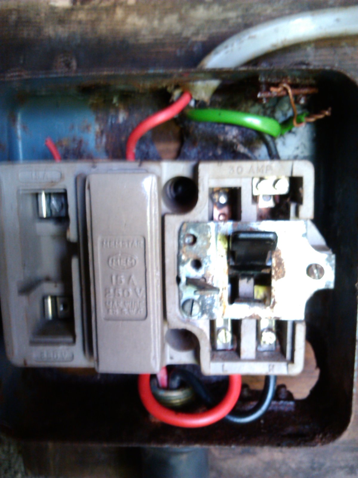

Been very busy but I found time today to take a closer look at the setup down at the pump-house and have uploaded a few pics. The cable in to the grey MEM box in the first post is, as I think can be seen, 2-core SWA (with the armour being used as the CPC?).

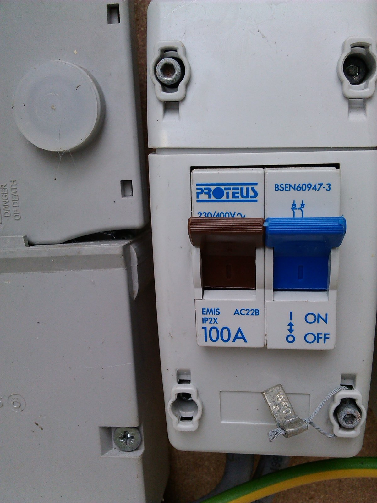

I have also added a pic of the isolator switch at the new (dedicated) meter. I know Proteus make RCD switches but this isn't one is it...anyone??
http://proteusswitchgear.com/index.php/100-amp-1-pole-neutral-electricity-meter-isolator-switch.html
Taylortc guessed correctly at the outset and there are 2 fuse ways in that box ..but currently only one fuse holder (15A). Looks like the second way has been used previously at some time and the wires just snipped off (and the fuse removed?)..that wasn't me! All pretty archaic but it has worked with no problems for 30 odd years!

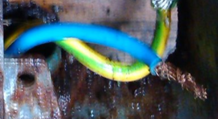

thanks sheds..yes I absolutely agree..the earthing does look flaky...which is why I have decided to have it all re-done professionally..probably in January. However, the close-up you show is the N wire in the second (rectangular) isolating switch that I had removed before taking the shot..the wire is now securely connected back in place and pump and pressure tank are working fine.

That cable needs reglanding and fitted with a proper Banjo plus Earth Strap, I take it it's pretty tight and doesn't spin as it pretty much looks rusted on?
Have you a picture of that Cable at the Meter end?
thanks for the advice chivers..I have read a round a little and see what you mean (I think!) re surface area and adequate earthing e.g.
https://talk.electricianforum.co.uk/topic/31889-swa-earthing/. However, I won't be doing the job, as I have said. Nonetheless I'll make sure I mention to whoever gets the job that they look to that aspect..especially if they don't mention it!
Re the cable at the Meter end..no I don't have a photo of that..in fact there's very little to see as far as I remember it's all so neatly done (but what lurks behind?)...I don't remember seeing the meter end of the SWA ..and that's a bit of a concern. I'll take a pic of meter installation tomorrow but I don't think it'll shed much light on that matter.

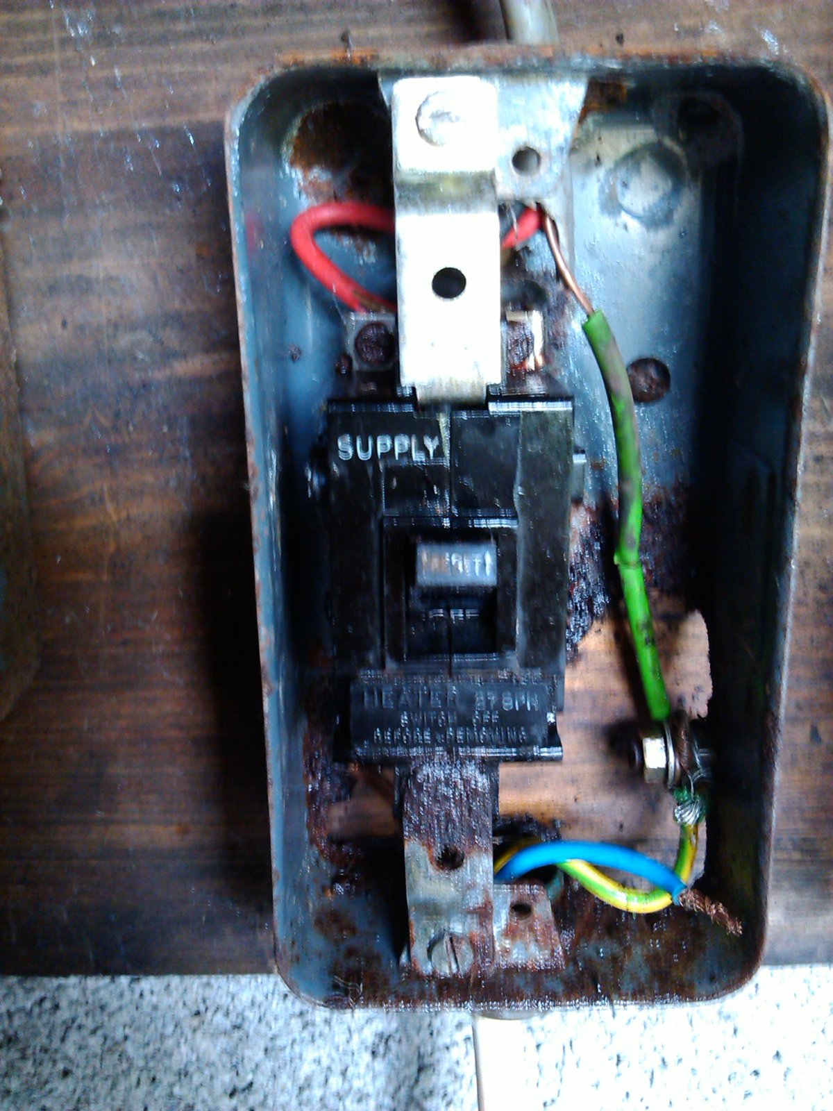

As you may be able to discern the switch has "Reset" on the end of the switch itself and underneath is the word "Heater"(?View attachment 146327 ?).
Later I'll go take a picture of the LH switch with cover off too...and post it here.
This is a trip rather than an isolator but I can't remember whether it's an overcurrent or RCD device. Last one I saw was a rip out pre 1994
many thanks Sunray.. makes sense..with the "reset" marking clearly visible on the end of the switch "lever" and all..maybe someone else knows? Did you also see on the photo in post #4 that I uploaded that it says "heater" below the switch itself?
whatever it is ..it has been there since we bought the place in 1985..that I can say..well almost 100% - despite memory fading with old age!.
