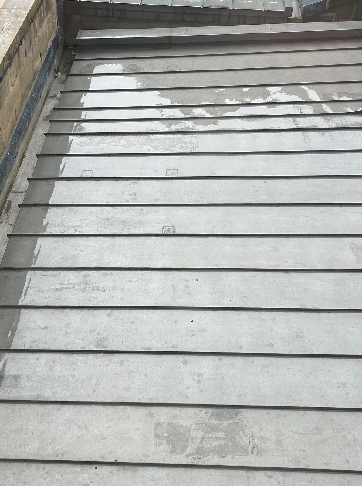

Thanks! The cause of the leak was debris blocking the drainage. We would greatly appreciate any advice on the correct internal repair procedure, and what to look out for during the reinstatement process to avoid any potential shortcuts or oversights carried out by the contractors.

Please see attached the photo. The old roof was covered in newly installed zinc roof with a slight angle. The verdic is that the overflowing water found its way down the vent when the drainage was blocked by debris.

I can't see a vent, or a gutter, or an outlet, or a drain.
A vent at the end of a significant roof fall doesn't seem right, blocked drainage or not. Have asked mods to transfer to roofing forum

Looks like staining and unless it is leaking it is still doing it's job. You could clean it and give it a coat of aluminium roof paint if it is visible and you want to improve the look.
The correct procedure involves a detailed assessment of the damage, not possible in the absence of more information. It is important to let damp dry out, just plastering over and painting, or otherwise covering it over will likely see the problem return.
