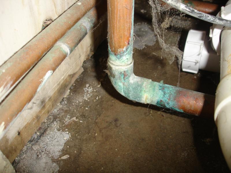

It turns out we may have a more urgent leak under the bathtub anyway! (photo attached). If there's lots of corrosion on a copper pipe joint, is that usually evidence that it's leaking? (Other sources could be condensation on the cold pipe or bad sealing around the side of the tub.)

Chemical toilet :LOL: or elsOn..... as to the bath. It might be just a new fibre washer needed on the tap connector that`s out of shot @ the top of the pic.. That looks like surface corrosion , and it`ll clean off . Worst case renew that bit of pipe with a flexi connector. Should be a 1 hour job and a few parts ...for any plumber ;)
I finally got a chance to dig deeper, and yes indeed, the faucet was not properly tightened down to the tub, so water was getting under it and running down the hot pipe. The locknut on the bottom of the faucet wasn't even finger-tight on the hot side. I tightened it up, and that seems to have taken care of that part of the problem. Good thing the cold side is already tight, because there's no room to swing a wrench between the wall and tub on that side!
Now I just have to re-seal the tub to the tiles. It turns out that is the biggest leak of all in this house (so far!). Water has been running down the side walls under the tub and creating a pool that seeps invisibly under the adjacent walls, eating away at plasterboard and trim in the living room and kitchen. Better fix that before we put in the laminate floors! :eek: Now my only concern is how we will find out when the new caulk pulls away ten years from now. (It was pure coincidence that I found these problems, while figuring out the plumbing for a clothes washer installation.)
