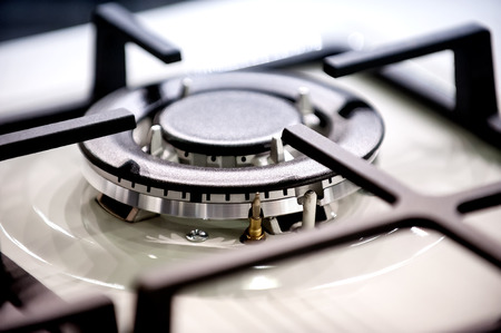

The white insulated spark ignition to the right and the bronze thermocouple tip in the middle, that's the FSD. If it only has the white sparker and no bronze tip then it doesn't have an FSD and shouldn't have failed.
