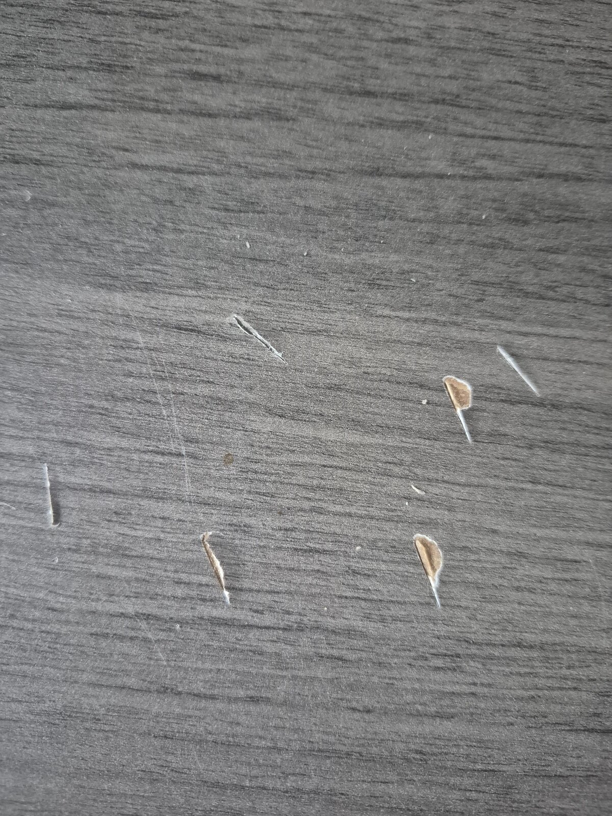

Anyone recommend anything I can use to repair or smooth over some dints into kitchen work top please that I made accidently.
Here's a photo
Cutout any loose material , fill with two part car filler( after masking off each section of damage) sand back smooth and use black and white permanent pens to patch colours.

I often use acrylic paints in 2 pack filler to change the colour. Far from perfect though.
