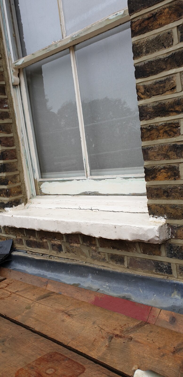

The following sandstone sill had loads of loose material after I started working on it, some of which was deeper than your damage.
I had to insert several helifix bars, you don't need to because yours already has reinforcing bars. I filled with Murex.

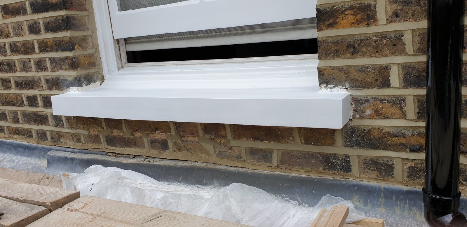

The benefits of using timber wrapped in poly are as follows (2 pack filler was used). Again, a sandstone sill.
If you were thus inclined, it would take about 5 hours (incl painting) to get yours up to that standard. If you are not that fussed, it should take you 10 mins to clamp and fill. You may need a slight face fill after sanding. All in, less than an hour (incl painting, and ignoring time to move the ladder).
