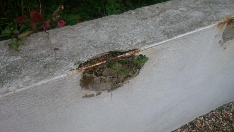

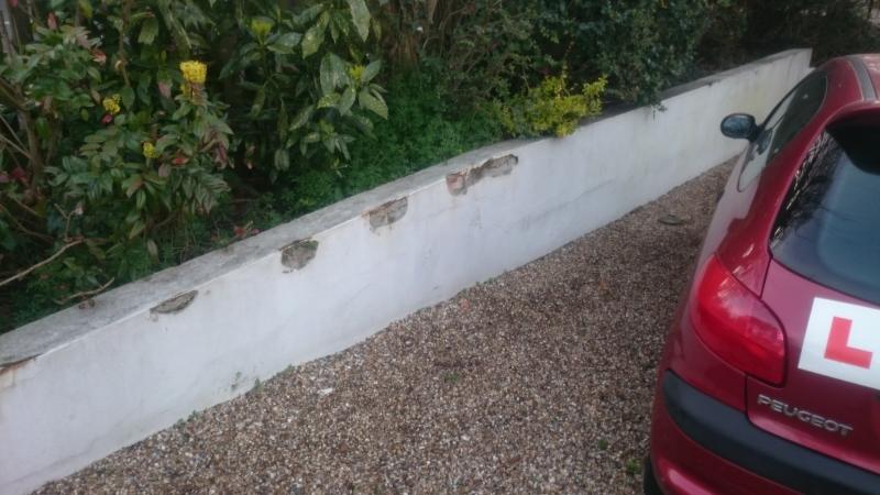

At the front of my new house is a low garden wall which looks like it was built from brick and then covered in smooth render. In the last year there have been holes appearing where the plaster has popped off.
How easy would it be to repair as a DIY job? I've never done plastering or work with cement, but am willing to try.

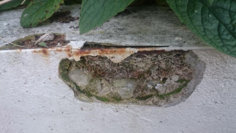

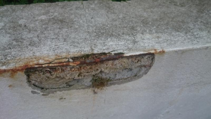

There seems to be a metal ridge along the top and this is corroded. Does that need to be replaced?
Some pics below:
There are a number of faults in the retaining wall:
1. the wall should have been capped with coping's.
2. plastic angle beads ("metal ridge") should have been used.
3. The top edge (without coping's) should have been sloped to shed water.
4. the regular pattern of spelching render patches indicates some kind of underlying fault - in the brickwork, or pressure from the back soil etc?
5. the render should stop short of ground contact.
6. no weepholes are evident?
You could patch with a simple 3:1 mix of sand and cement (buy a bag from a plumbing supplies) but it would only be a temporary fix.
