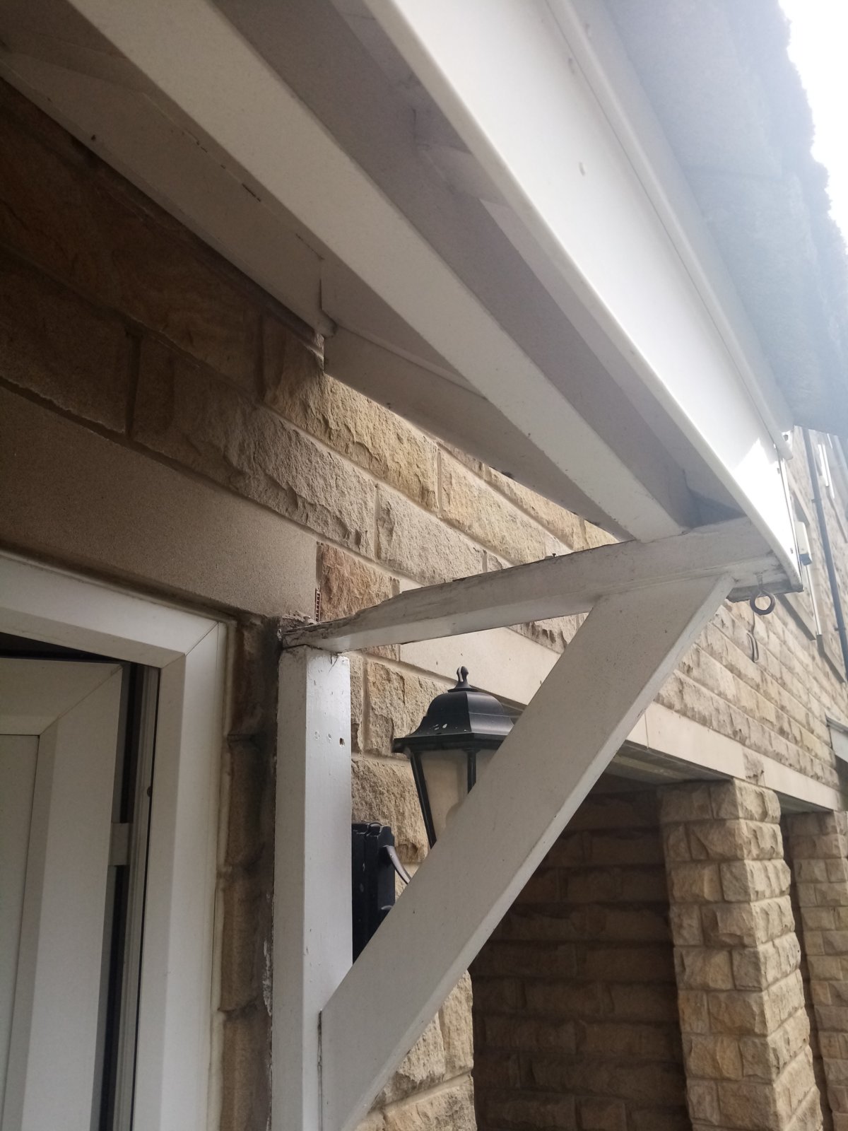

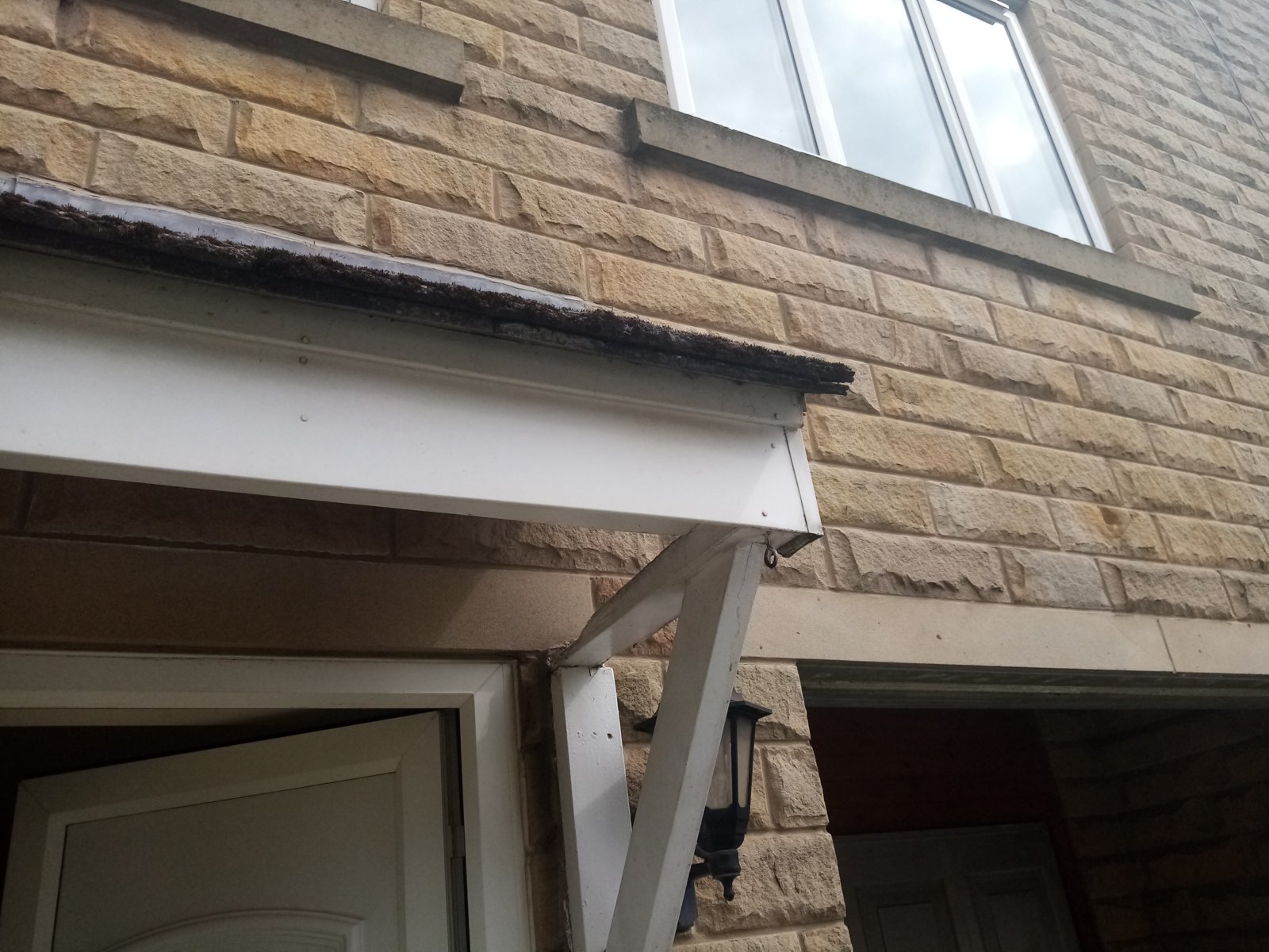

Can anyone advise if there's a way to replace this timber that has nearly rotten through on a porch roof. Thanks I've attached pictures.

Make exactly the same brackets in new kd treated wood.
Dip the ends in preserver, then paint to your taste.
Rent 2 acrow props, hold the roof, dismantle old bracket, fit new ones, remove props.
Done.
