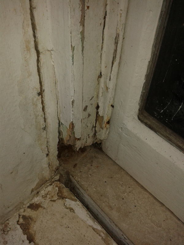

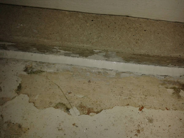

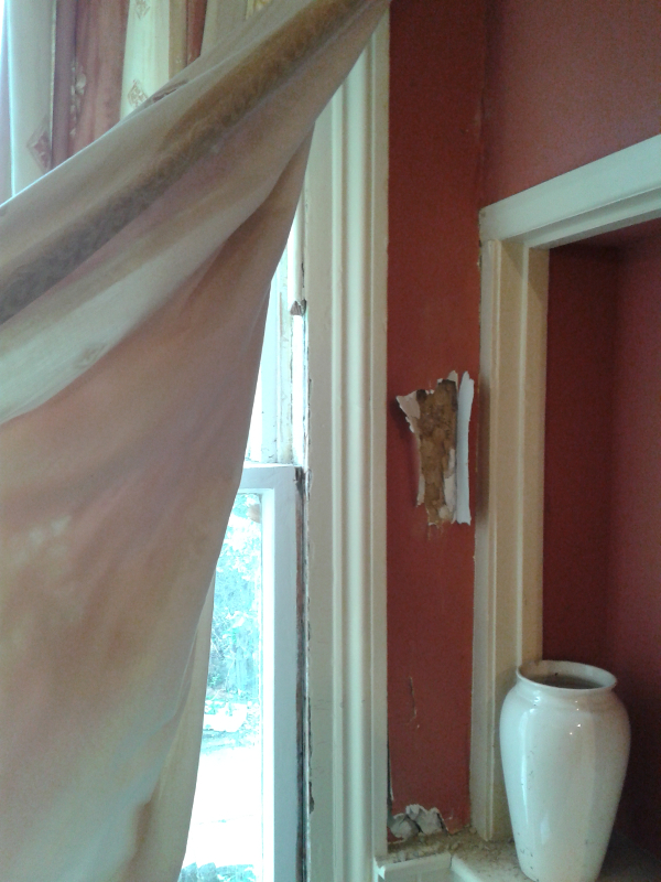

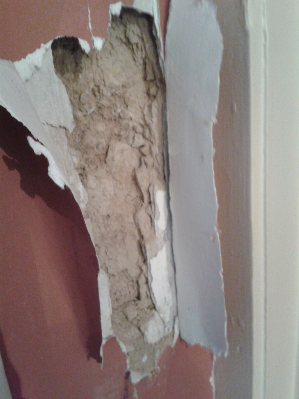

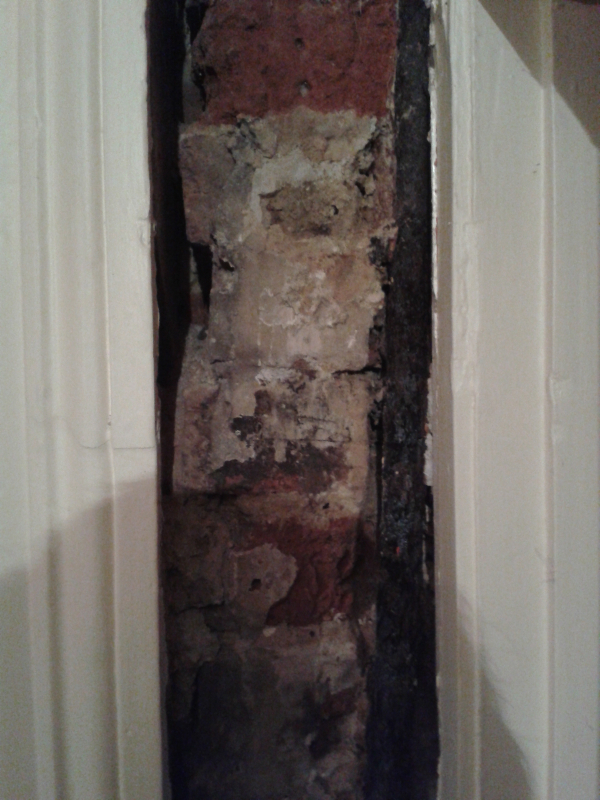

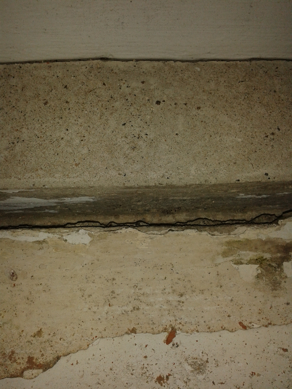

Hi,
My house has got various cracked or crumbling bits of render both inside and out (mainly just cracks outside, a couple of crumbling bits inside). I can't afford to get builder to fix them so I'm going to have to attempt it myself. I've attached a couple of pictures of one bit that needs doing. The whole strip of plaster next to the window has crumbled with the worst bit being where I've pulled the paper back. I would like to repair it using lime since that's what it's currently made of. How exactly would I go about doing it? I think I'm a fairly competent DIYer but I've never worked with lime plaster before. Many thanks in advance!
James
Crumbling render like in the pics is typically caused by penetrating damp.
Hack off that panel of render back to masonry, and post a pic of the bare masonry surface.

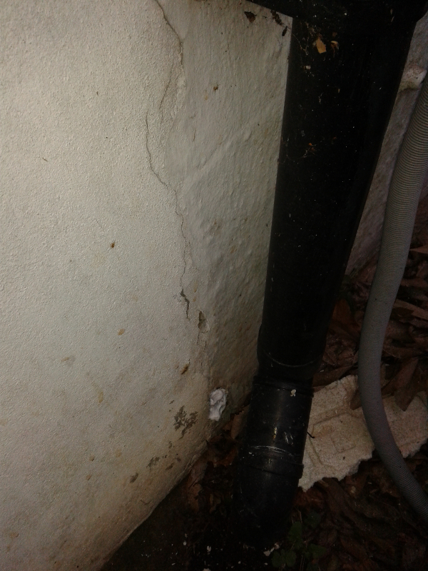

Post pics showing the exterior render cracks and of any other internal crumbling patches.
Are your walls solid?
Do you have a wainscot panelling on the lower part of the external walls?

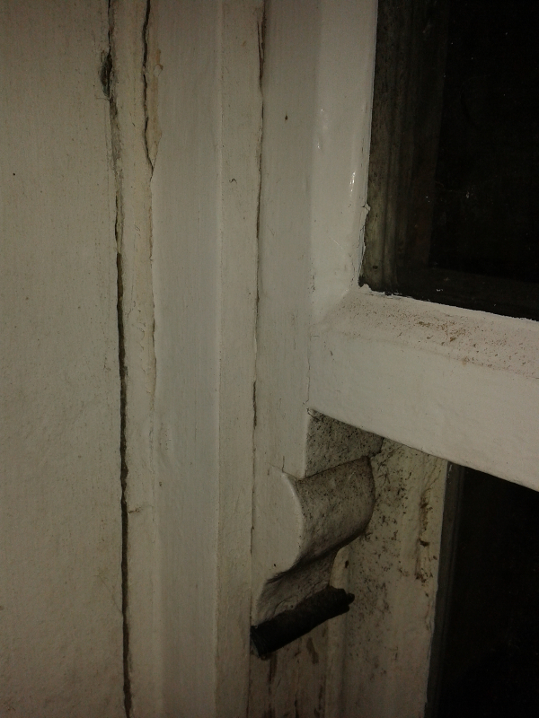

FWIW: you are missing a piece of the window frame staff bead - this will possibly make the lower sash unsafe.
Hi,
Thanks for the reply. The walls are solid and there is 4' of hardboard panelling around the room. I'll get some pictures of the outside as soon as I can. Before I start hacking off render though, is it going to be possible to re plaster at this time of year? The house does have central heating.
That staff bead has been missing for a while now as I started renovating the windows and din't get round to finishing them before the winter. They're screwed in place though so don't pose any risk.

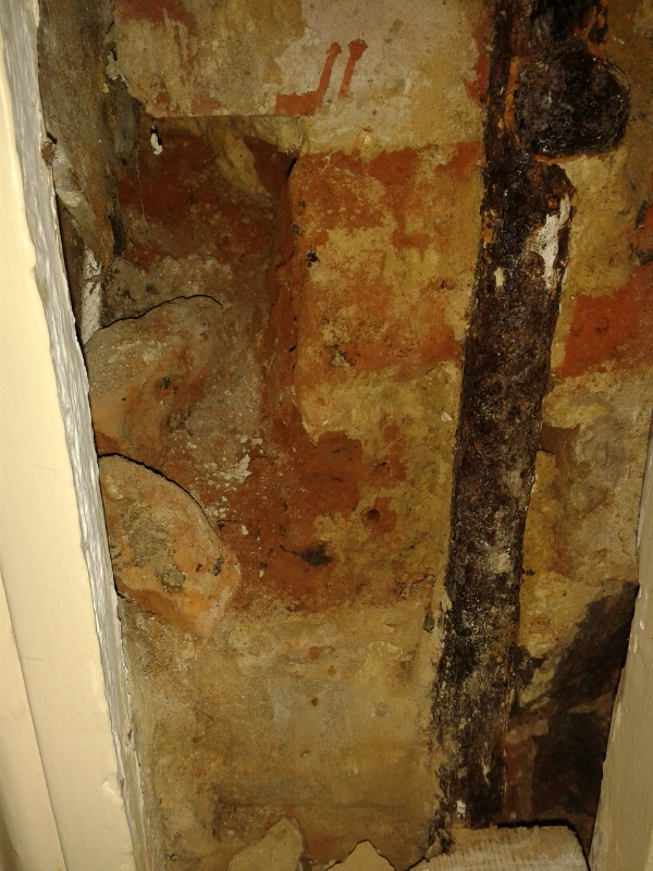

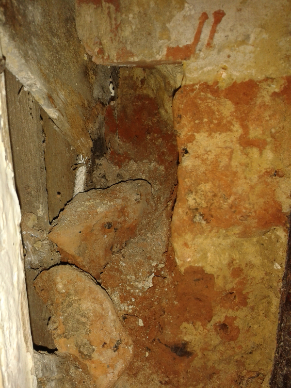

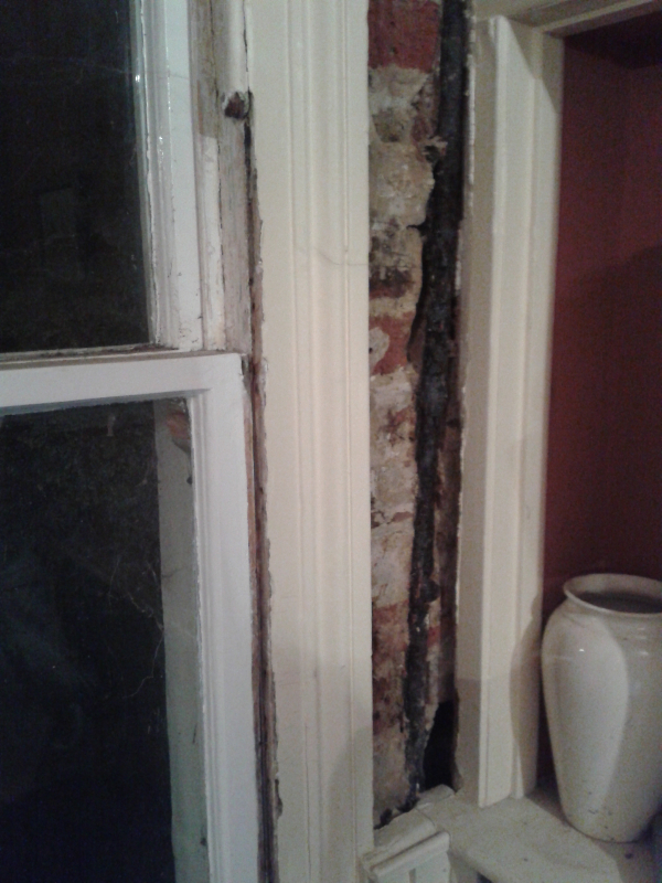

I've now hacked off the render and it's revealed what seems like quite a bad problem. The render all came off just by poking with a screwdriver along with q few chunks of brick and mortar. Some brick is crumbling and has turned into what resembles wet clay and one whole brick seems to be missing. I haven't removed the panelling but I can feel that it's rotted behind. I lifted the carpet too and the boards in the corner are rotting. I've attached pictures of everything. What do you reckon?

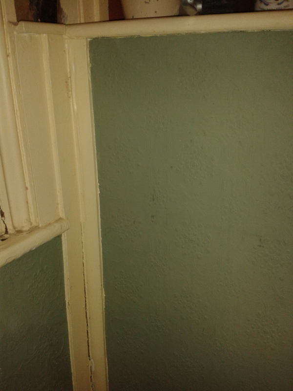

Thanks for the new photos.

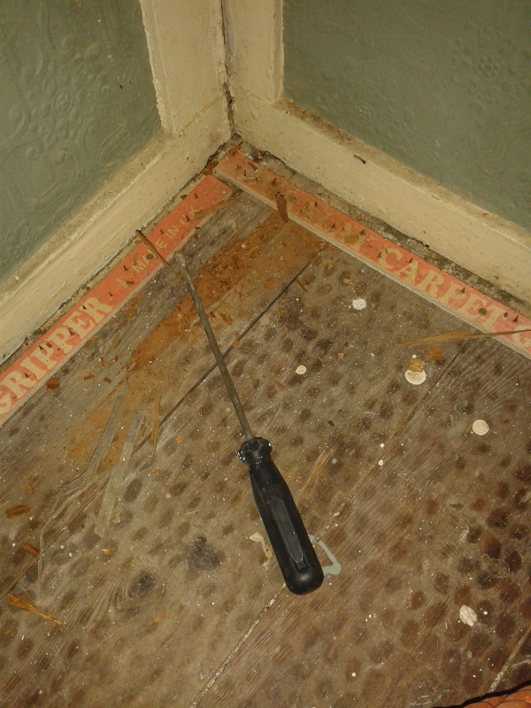

Remove the immediate carpet grippers - lever them up - and roll the carpet back or remove it from the room. Clear all chattels from the work space.
Use a utility knife to cut paint bonds to release the wood trim work around the panelling.
Gently lever the panelling off - you might see fixings behind the trim.
I can see what looks like bubbled surfaces on the panels but perhaps thats how they are meant to be?
This damp pentration might extend across the front (window) wall - see what you find when you have removed the left and right panels in the pics.
Remove all damp "slush" & debris from the wall - is there any fungal damage to the wood thats been exposed?
Does the damp appear to be ongoing behind the door lining - what about inside the recess?
Crawl under the floor and examine the joist tails that are going into pockets in the front wall masonry - probe them for rot with a small screwdriver. Carefully examine the corner where the T&G is damaged.
What is the metal pipe used for - or has it been abandoned?

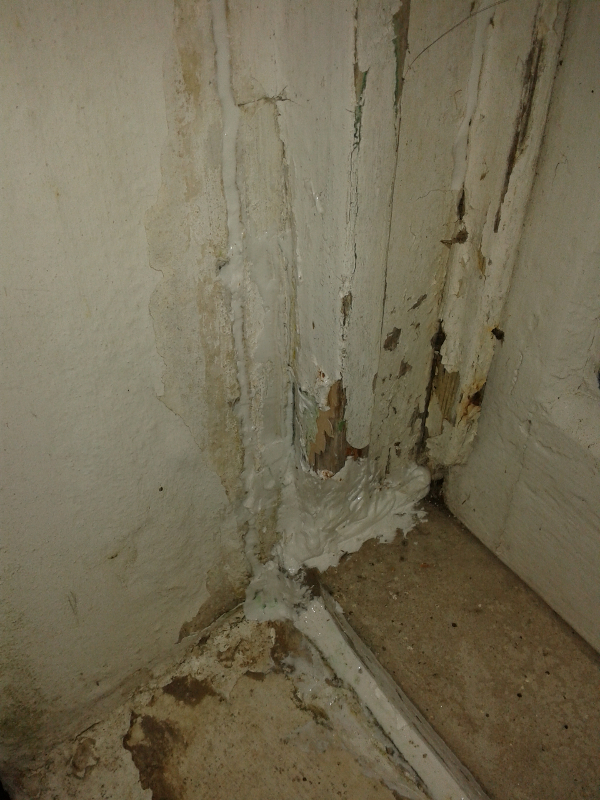

I had a look at the cracks outside today and there are several places where damp could possibly be getting in. The mortar around the window frame was cracked, the bottom of the frame has rotted quite badly and there is a gap in the concrete window cill. I dug out any loose mortar and cleaned out all the dust and then filled the cracks and gap with mastic. I also bodged the rotted frame full of mastic as a temporary measure until I get round to fixing it properly. I'm going to keep checking the wall to see if it dries out or stays wet (it's already dried out a bit just since I removed all the plaster). There was also a chunk of render missing from near the drain so I filled it in with a load of mastic as a temporary measure.
I've removed most of the crumbling brick and soil-like dust but I ran out of hoover bags so I couldn't get it all out. A few of the bricks have turned into wet, crumbly clay but most seem solid still. The inside of the sash window box has also rotted but hopefully not enough to need replacing. There is no fungal damage that I can see and what looks like bubbling in the picture is just patterned wallpaper. I haven't got round to removing the panelling or floor boards yet but should be able to at some point this week; the panelling on the outside wall is going to be a problem though since there's a radiator attached to it.
I can only guess that the metal pipe is abandoned as there is no plumbing anywhere near it.

All Wet Rot wood is fungal damaged. The whole window box will have to be removed for repair at some later date - its not difficult.
Dont cut the pipe or attempt to remove it unless you are certain its abandoned: it could be a dead-leg containing gas or water.

In terms of the wall repair, there are quite a few bricks that have turned to mush. Most bricks are okay but some have crumbled, why could this be? Could this be a structural problem too? I.e. How many crumbling bricks do I need to spot before it becomes a real problem?
The mastic outside is still not fully cured and I can't tell if it's solved the damp as it's been too cold for the bricks to dry out properly to start with. There's also a couple of bricks worth of mush that I'm worried about cleaning out.
I haven't managed to inspect under the floor yet. It's too narrow to crawl under at that point so I'm going to pull a few boards up tomorrow. There's a cellar under most of the room but it ends a few feet from the wall and then there is very little space under the boards.
