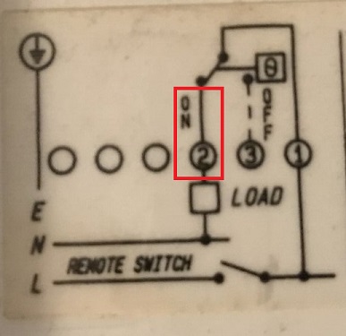

Replace a thermostat
Yes that would do. (y)
A corresponds with the existing thermostat 1 (L)
B corresponds with the existing thermostat 2 (ON)
C corresponds with the existing thermostat 3 (OFF)
The DT90 doesn't require an earth connection, so the earth wire should be insulated/isolated and tucked safely out of the way.
To the untrained eye this looks like off on my current diagram and hence, wire 3. Can I double-check this please.
Thanks again
