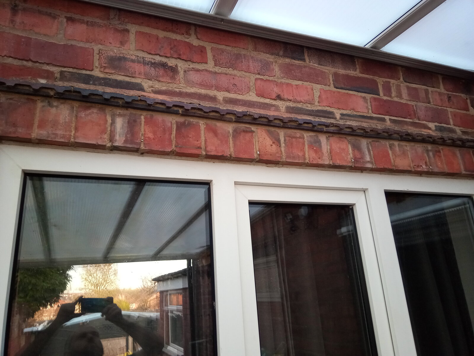

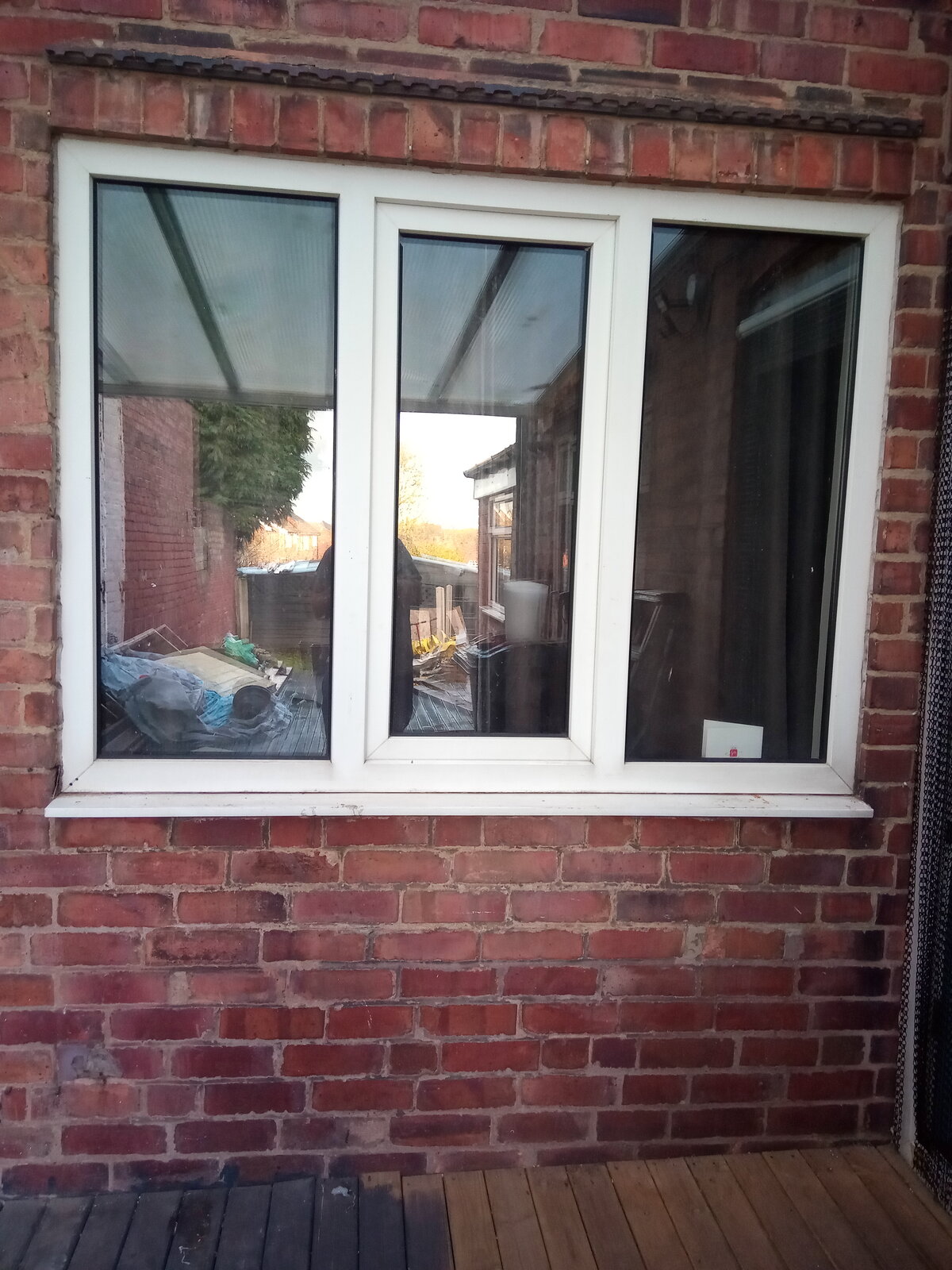

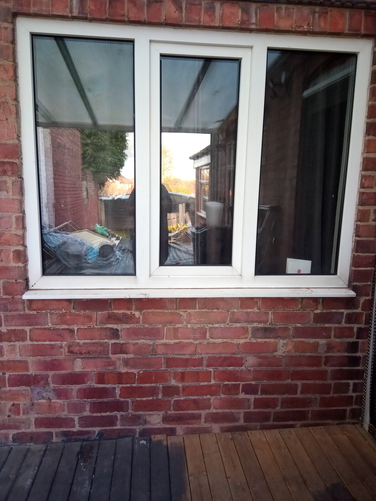

Hiya I just recently bought a house I want to change it a little was wondering is it possible to remove the window and slide in some pvc french doors without paying for builders etc it's on a corner of the house next to a alleyway

Yes. Lintel already in place
Remove window
Cut brickwork using 9inch grinder and diamond blade or Stil saw
Fit doors
