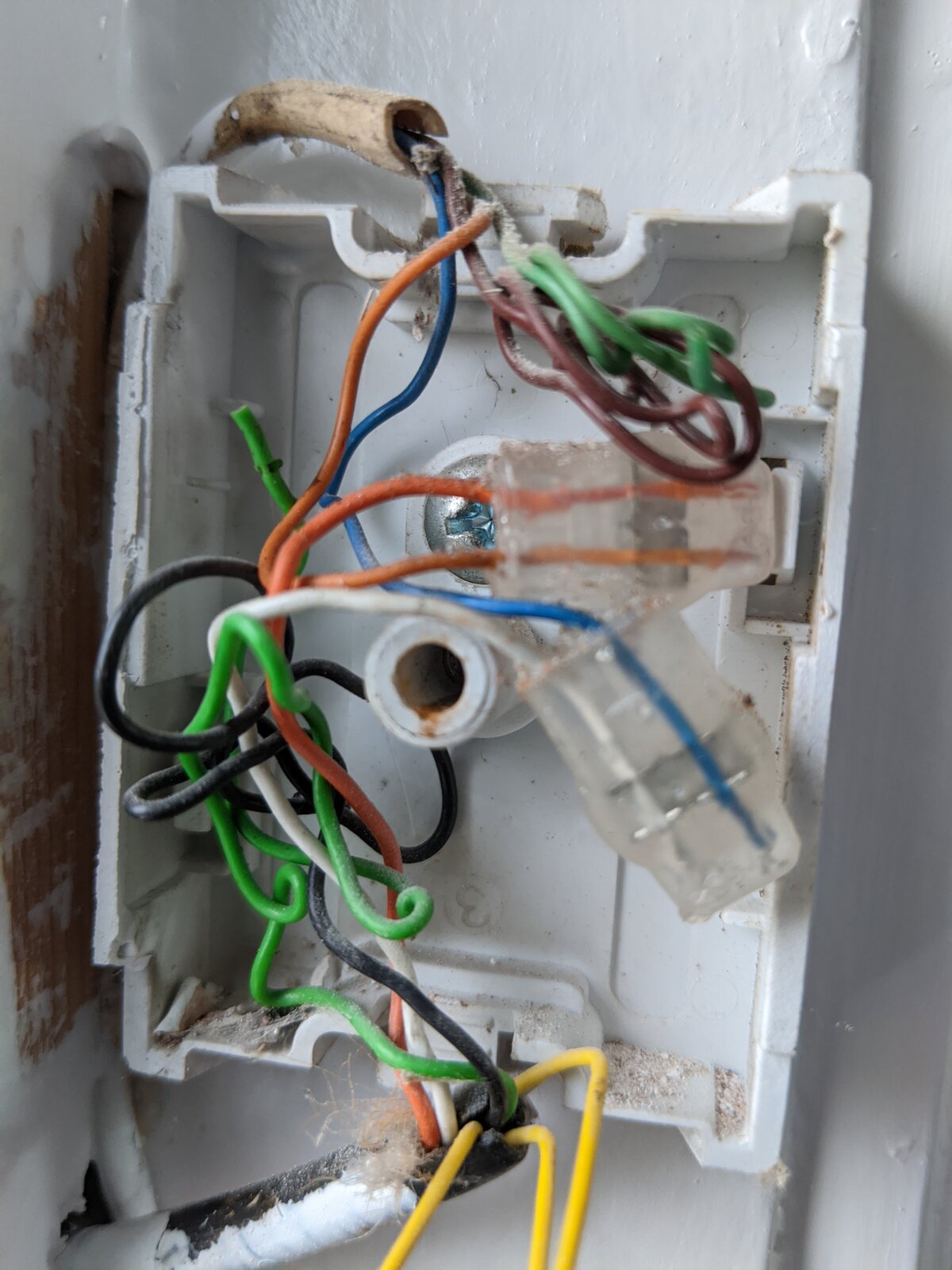

Hi, I need to move a master socket that enters via the top door frame. Currently connects via external black cable to a BT connection box and from this white cable runs down the doorframe to the master socket.
Black green white orange from external cable
This connects to orange green brown blue internal cable to master socket
Want to replace BT connector box and internal cable.
Which cable and connection box plus cable connectors should I buy
I've bought a BT Openreach Telephone Master Socket NTE5c MK2 & VDSL/ADSL Faceplate MK4
Thanks to anyone who can help.
I
Many thanks
Andy
A Block terminal 77A and CW1308 cable, two pair.
Oh, also, I better check:oops:, do you have a krone tool?
If you need to shorten those yellow "wires", use tin snips or wire rope cutters if you have them, not normal wire cutters. (Those 'wires' are steel strength members which help hold the cable up over long spans, very painful when you get your fingers spiked by them!)
Duly noted. Have a pair of snips around here somewhere.
Appreciate the heads up against spiked fingers and knowing me that would have happened!
