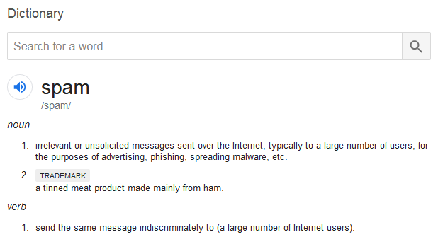

You are the embodiment of "spam".
And you're the embodiment of not knowing what the words you use mean.
