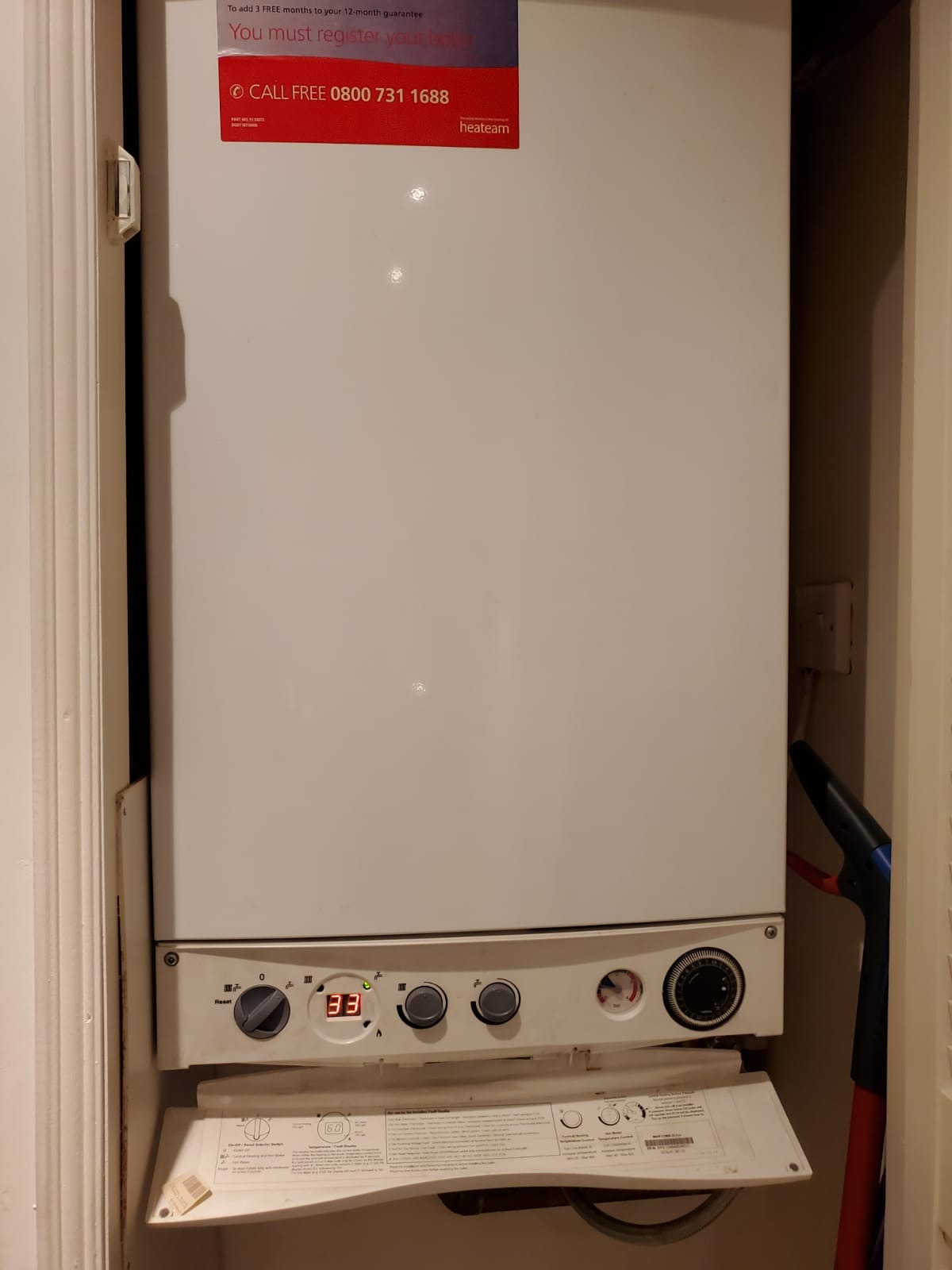

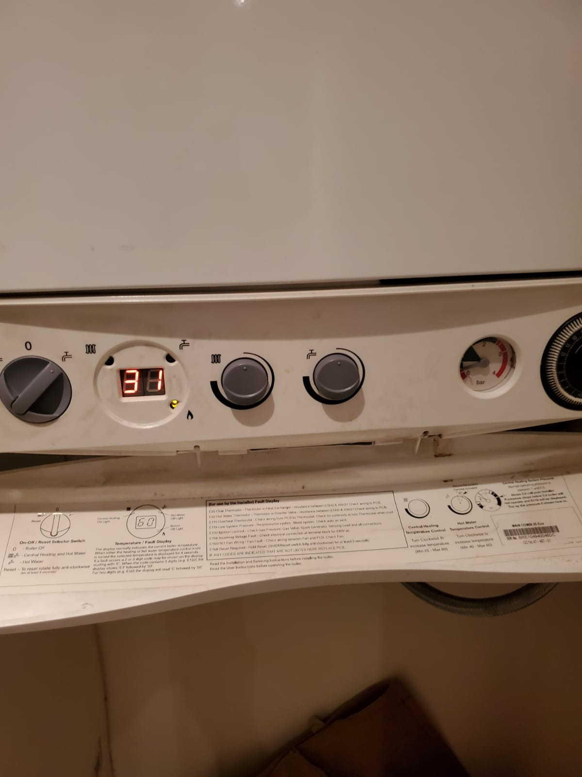

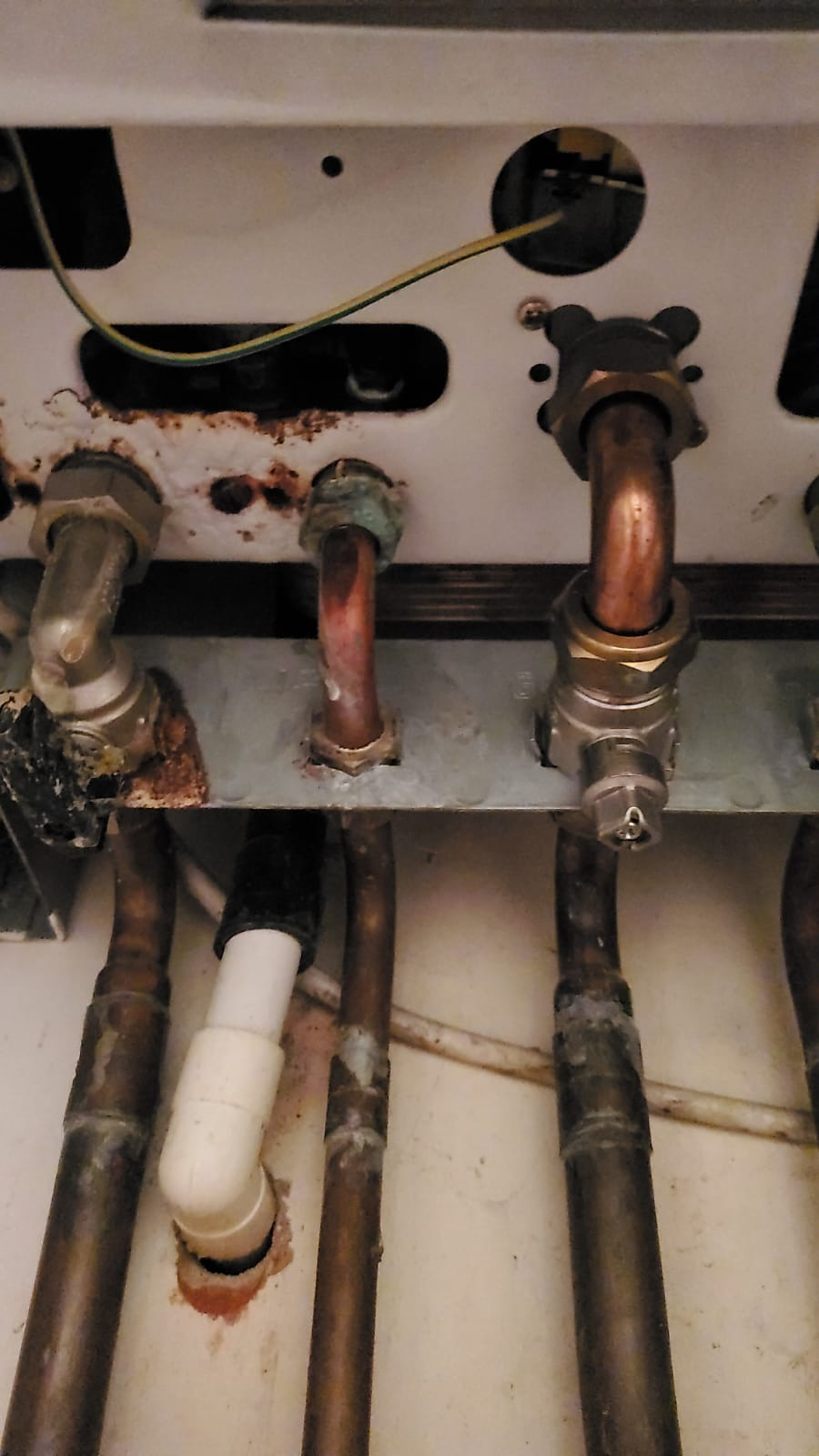

Here are some pictures - It needs a flush obviously
Im not sure what other info would be needed
Im thinking of replacing the Baxi 600 / Baxi 800 - Any ideas on the difference

1. There is nothing in the photographs which shouts "sludge!". Looks as if you have had a leak which has gone unchecked / unnoticed at services.
2. The boiler casing has rusted, so you are probably in need of a replacement.
3. When you get it replaced it would be sensible to:
3a. Have a power flush done anyway, although you might get away with a chemical flush done BEFORE the old boiler is removed. So a chemical + hot water flush.
3b. Make sure you get a magnetic filter fitted to the return pipe on the new boiler to catch any further sludge.
3c. I wouldn't replace the radiators. Provided they are sound and internally clean, why go to the extra expense. Also, it doesn't future proof anything, and add a good bit to the cost.
3d. You will probably need new controls to conform with current regulations.
4. Once it is installed, make sure it gets an annual service. Check with the installation manual what a service comprises, and make sure the attending engineer does it all.
5. Very rough guess on costs:
5a. Boiler and flue £1,200
5b. Filter and controls £450
5c Labour - installation £700
5d. Labour - power flush £500
6. Boiler make - down to personal preference, I like Vaillants but others will have their own views.
7. To a large extent it doesn't matter what boiler you have, the key to long life is in the installation.
