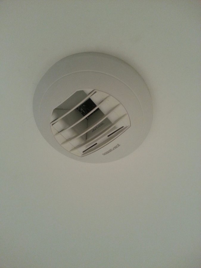

How can i test the vent? It's a Pasivent. Attached a picture. I've the same one in the kitchen and there is a switch in there that says ''Fan'' and ''Boost'' I've not seen another switch in this house for the bathroom. I had this off at the weekend when i was putting in some recessed lights. Inside the vent is connected to a foil tube and there is another plastic vent in the ceiling. This is not connected to the foil now that i think about it.
Comparing the two vents, the one in the kitchen is very dusty, the bathroom one has no dust on it at all but not sure if that's because it's in the bathroom.
No dust means it's not working - you need powered extraction. and yes you'll need to lift some flooring board.
