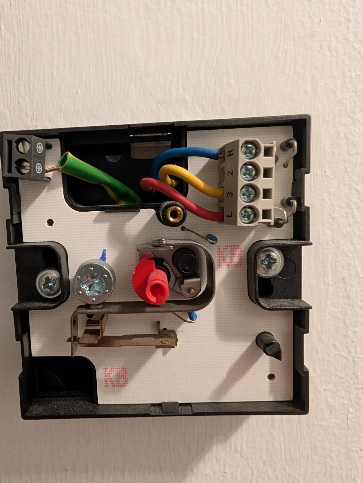

Hi all
Our Drayton combistat is not working so well and I'd like to replace it with a digital stat, perhaps Honeywell or hive
All controls are next to our boiler using the Drayton lp522. Water needs to be on for heating to come on. Cylinder in cupboard gets heated up and water passes through matrix to get warm (so I'm told)
If I wanted to replace just the thermostat, would this be simple enough like for like with either brand above? Wiring diagram is below.
Would be great to change it's location to the lounge (currently in hallway which is always a bit colder) but suspect that won't be easy to do
Also happy to replace the controller if it's easy enough and no major wiring involved

If you want it moving into the lounge without rewiring, then I suggest a wireless type. Have you considered a Drayton Digistat which would be battery operated and has app/Bluetooth connectivity?

The digistat 2290b is a battery operated programmable 2 wire thermostat, so it would be wired in place of the existing combistatand safely terminating the neutral wire, as it wouldn’t be needed. Everything else would remain the same.

Just so I'm understanding you properly, this stat could be a direct swap out for my current combistat? Just need to terminate the neutral wire?
Is there a sensor that comes with it which can be placed in a different room or have I got this wrong. Thanks
Yes, the above is correct.
No, not a sensor. You would put it there, but you could control it from the lounge with a compatible smartphone. If you wanted to move it altogether you’d need the wireless version RF901 or another branded wireless thermostat.

So if you wanted a hive or similar, you could place it where the existing programmer is located (should be straight swap, no wiring) or place it in the airing/cylinder cupboard, wiring required.

No, I think you’re misunderstanding me. The Hive can replace the controller, but can be used just as a wireless thermostat, but needs a receiver wiring in. This is either done at the programmer (easy) or wired into the wiring center in the cylinder cupboard (a little more than easy, but easy enough). This allows you to place the thermostat where you want it within reason.
Any battery powered thermostat such as the 2290b would just be wired to existing thermostat wires. An alternative you could go for is the Nest E smart thermostat or plenty of other battery operated types. This keeps the thermostat in the hallway. Hope this explains it better?

You can’t really do that, as the receiver needs a permanent live and permanent neutral. Existing thermostat only receives the live once it’s called for by the programmer. If you went with Hive 2 channel, you could replace the existing programmer (controller as you call it) and it would control your heating and hot water.
