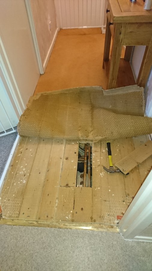

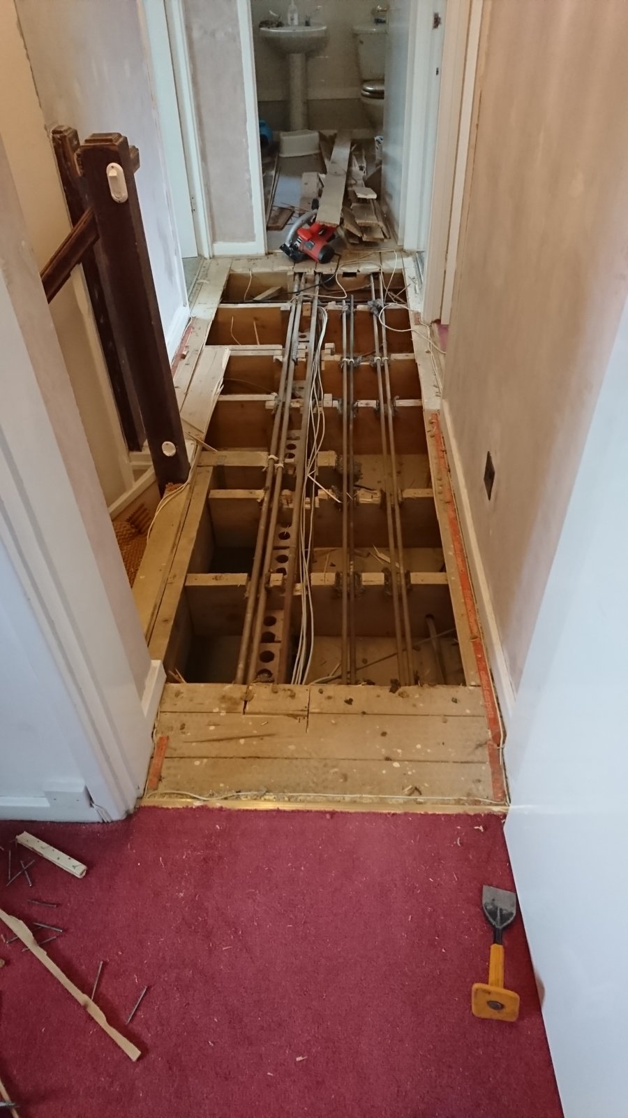

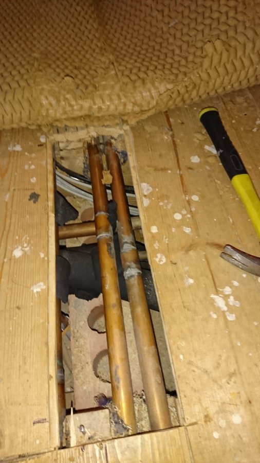

The problem is how the pipes have been installed. easier to explain from pic but they've been laid to one side of the floorboards (instead of down the middle) meaning one side of the floorboard cannot be secured down and/or in some parts practically resting on the pipes!
its the same for the floorboards to the left of the cutout i'd lifted in pic (previously cut/not by me, to repair pipe by the looks of it) hence the creaking! it's a bit of a mess tbh and wouldn't feel comfortable trying to secure any of the boards already in place (even if i could! without lifting up and seeing what other surprises are lurking.....)

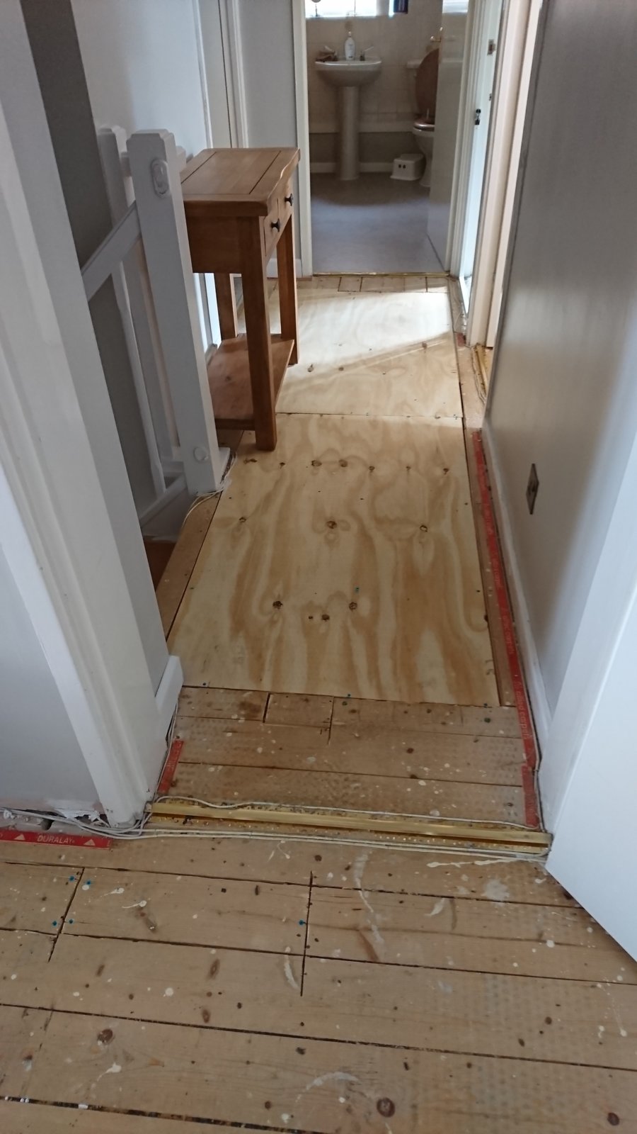

i'm tempted to replace the lot (leaving the boards that are under the walls) and replace with one/two pieces of structural 18mm ply so i can secure down properly to joist and avoid the pipes in the process. the floorboards are 18mm. can i just direct replace? i've read a lot of conflicting advise and no situation similar to my own (a landing) - unless anyone else has got any better ideas or advice? not really done much with sub-flooring before etc so want to not make a stupid/simple mistake...
the landing flooring area i want to replace is 1130mm by 2900mm (hence the idea just one full board)
i would also maybe cut the board in half (making sure it's cut/finishing on a supporting joist) just so it would be easier to lift flooring if any work needed doing later on? rather than having to lift the whole landing flooring
