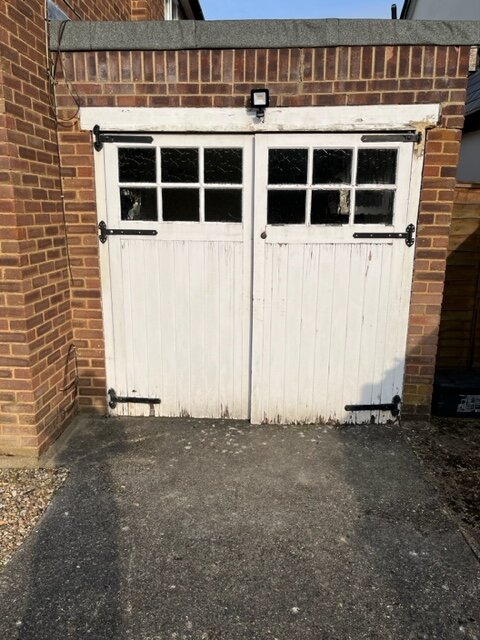

I need to change garage door frame, pls see pic.
The 2 x side jambs dimensions: L=2280mm , W=70mm, D=100mm
I want to only replace the side jambs, guess it's possible.
I think there is no head jamb anyway, only wood lentil as in pic.
What timber shall I look for? Assuming what I am trying is feasible.

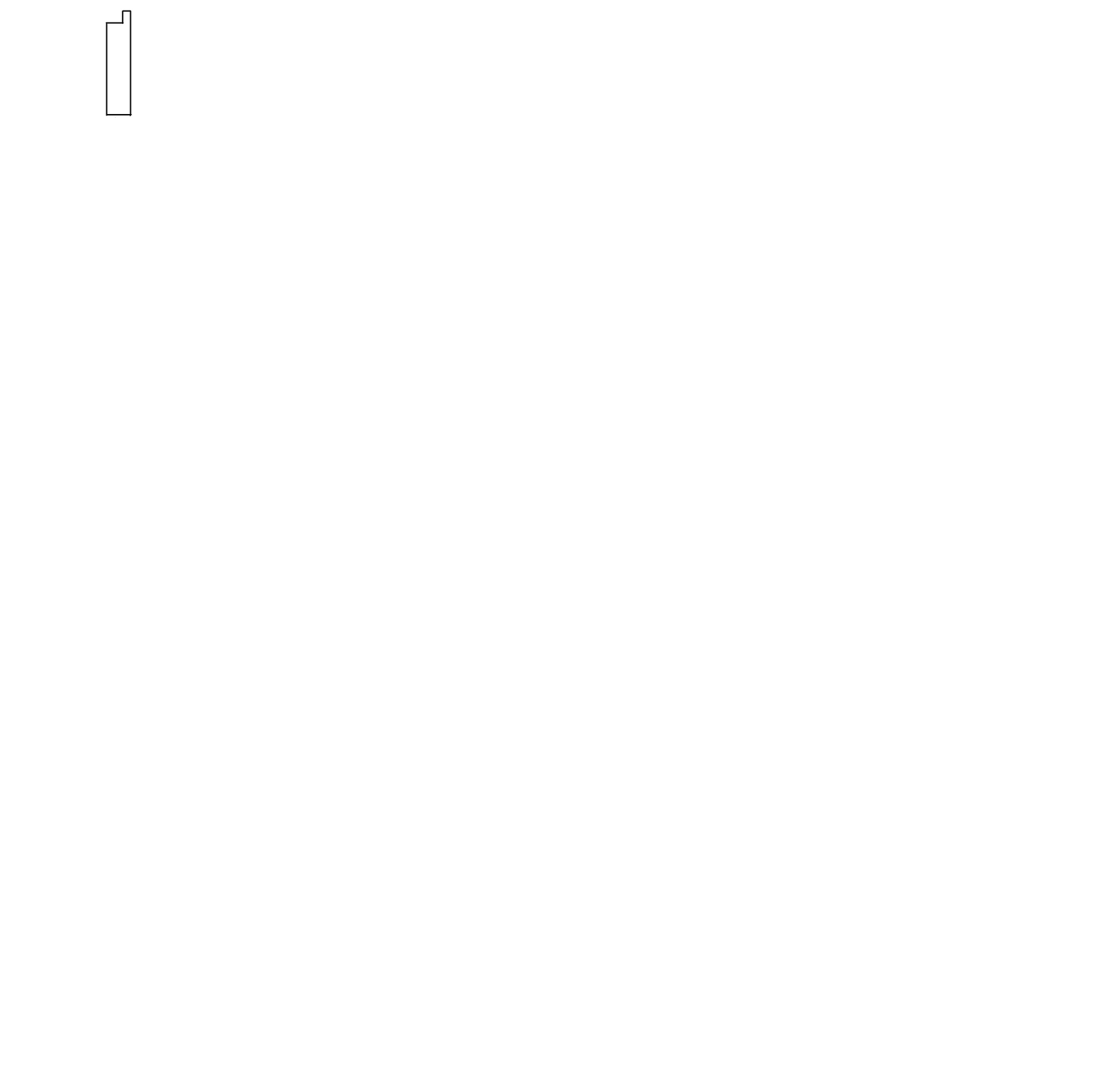

The 2 side jabs have cuts/groves to accommodate the wooden lentil as in my simple drawing, I guess I can cut this myself?

The "rebate" at the top is fairly straight forward to cut using a (circular) saw (and a square) to make a cross cut, then a sW tomake the rip cut along the grain. Clean up with a wide, sharp chisel

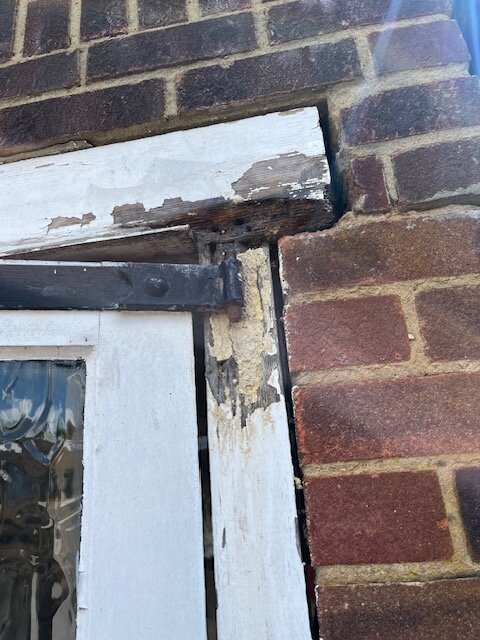

One more question:
The top hinge is fixed on the frame and the wooden lentil, pls see pic on first post. The frame will be new but am keeping same lentil but has rot in the part where the hinged is screwed to, is 2 part wood filler strong enough? The hinge is fixed by 4 screws, 2 on the frame and 2 on the lentil.
Filler, 2k or otherwise, has absolutely no strength to it. Better to cut any rot out, treat the exposed edges with wood hardener and then splice in a fresh piece of timber (glued and cramped in place, not just screwed)

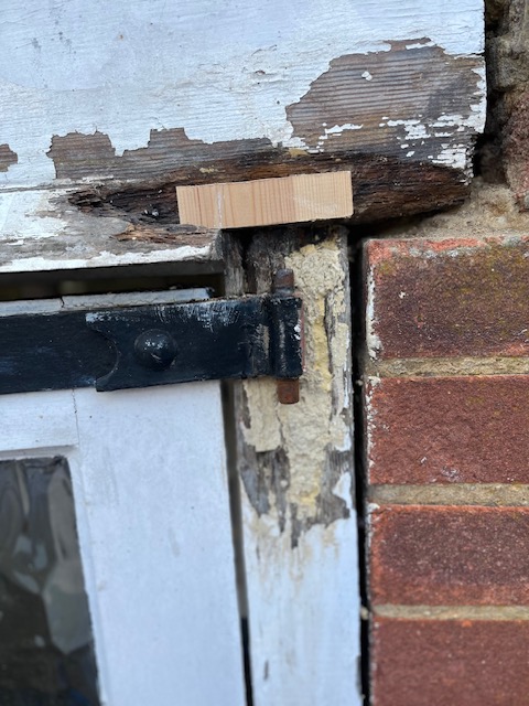

Pic of the rotten part below, I cleaned loose timber and applied wood hardener to kill the rot. The red area is where the top part of hinge bracket will be fixed to, depth of rot is about 15mm max at the deepest, I will pack the holes with wood and glue, I can't see much space to put fresh timber, do you think filling with 2 part wood filler should be enough? The top bracket has 4 screws from which 2 screws are fixed to this part of timber and the other 2 will be fixed to the new timber frame.
Any chance you could post a photo from a bit further back? It's difficult from such a tightly cropped photo to say anything other than, "Yes, that's rot". From your earlier post I'm not sure you understand what I have proposed, and I would like to clarify what I meant
Please do not duplicate your posts
I have shaped piece of timber to fit in the rotted area as in pic attached, if I fix this with filler and one screw and fill all around should be good enough?
