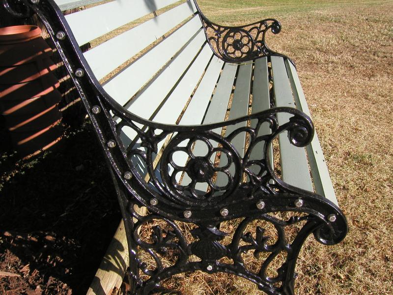

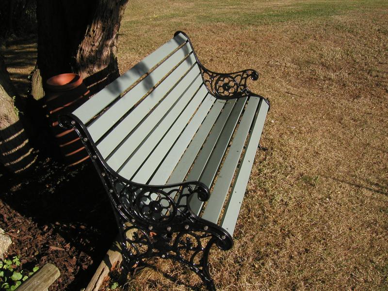

I have three 12 slat garden benches with cast iron ends.
The slats are hardwood but the screw anchors have come out of end of slats due to age, I am thinking of renewing all of the slats so it raises two questions really, do I renew with hardwood or a treated softwood which would require retreating when necessary and how do I anchor the slats to the cast iron ends which have 12 holes in each side.
Thought about just screwing brass screws into each slat end or is there some sort of anchor that is fitted in the slat end as on the original benches?
Any ideas anyone?

Ah, right now I see what you mean, your slats must be fitted differently to mine.
My slats are fitted on the ends, to holes in the side of the castings, they used wood inserts originally with round head screws screwed through the casting into the wood inserts.
So if I used coach bolts the heads would be proud of the side iron castings, so maybe I need brass screws direct into the wood or new inserts?
oh ok, we're talking cross purposes... :LOL:
can you post a pic? (of the bench... this is a family site after all lol :LOL: )

These photos show how slats are attached, you can see that the inserts have come out of the slats......
i see what you mean.... my bench is the same shape, but has a ledge on which the slats sit, so my bolts a re vertical.
You have a different problem totally. I think i would go for thicker slats... and then use the biggest screw you have.... making sure you pre-drill to the diameter of the shank of the screw....
