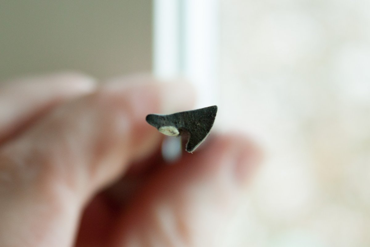

Have a go at removing a bit of the internal gasket. There will be a join in one of the corners so start there with a thin flat scraper and lever it out. You can put a thin bit of cardboard against the frame if you are worried about scratching it.
Once you have an end exposed take a photo of it and sketch/measure everything.
Then search this on ebay: wedge gasket sample pack
Find the closest one and order the sample pack, Try a bit of the sample in your windows and if it fits order as much as you need by the code.

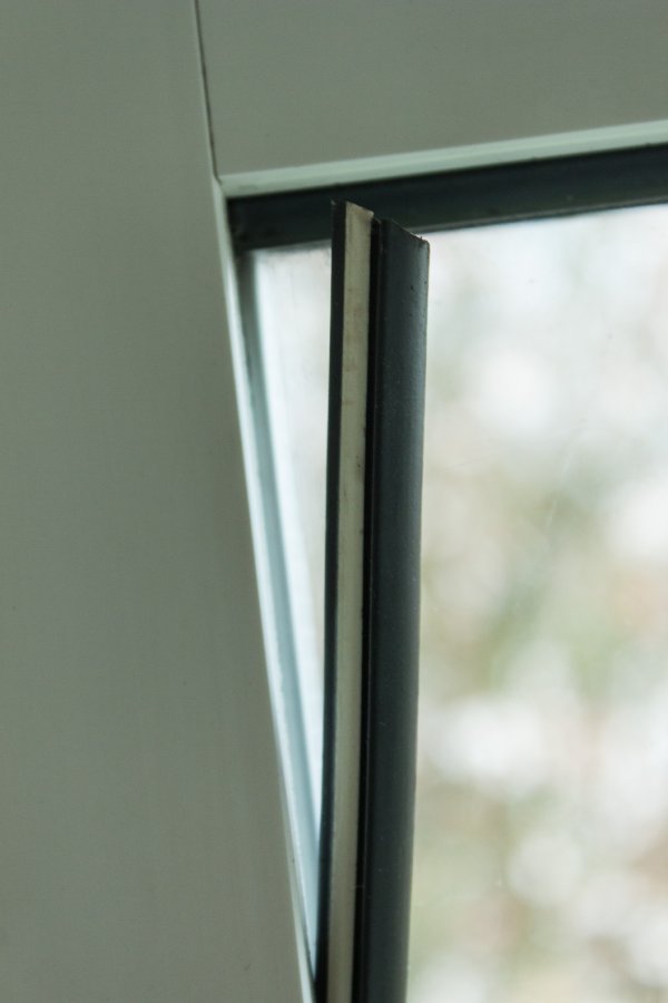

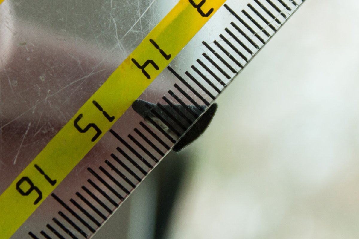

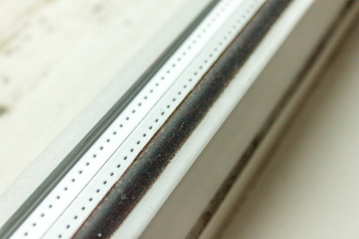

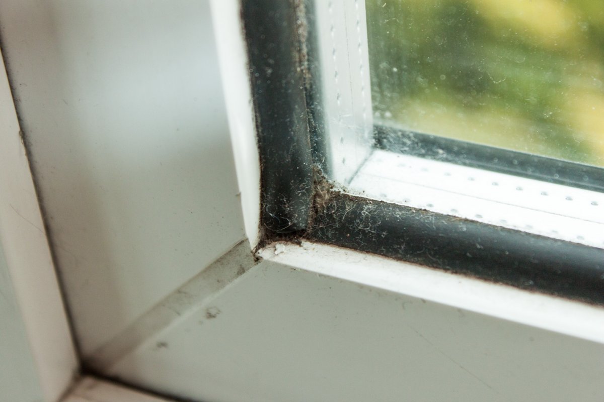

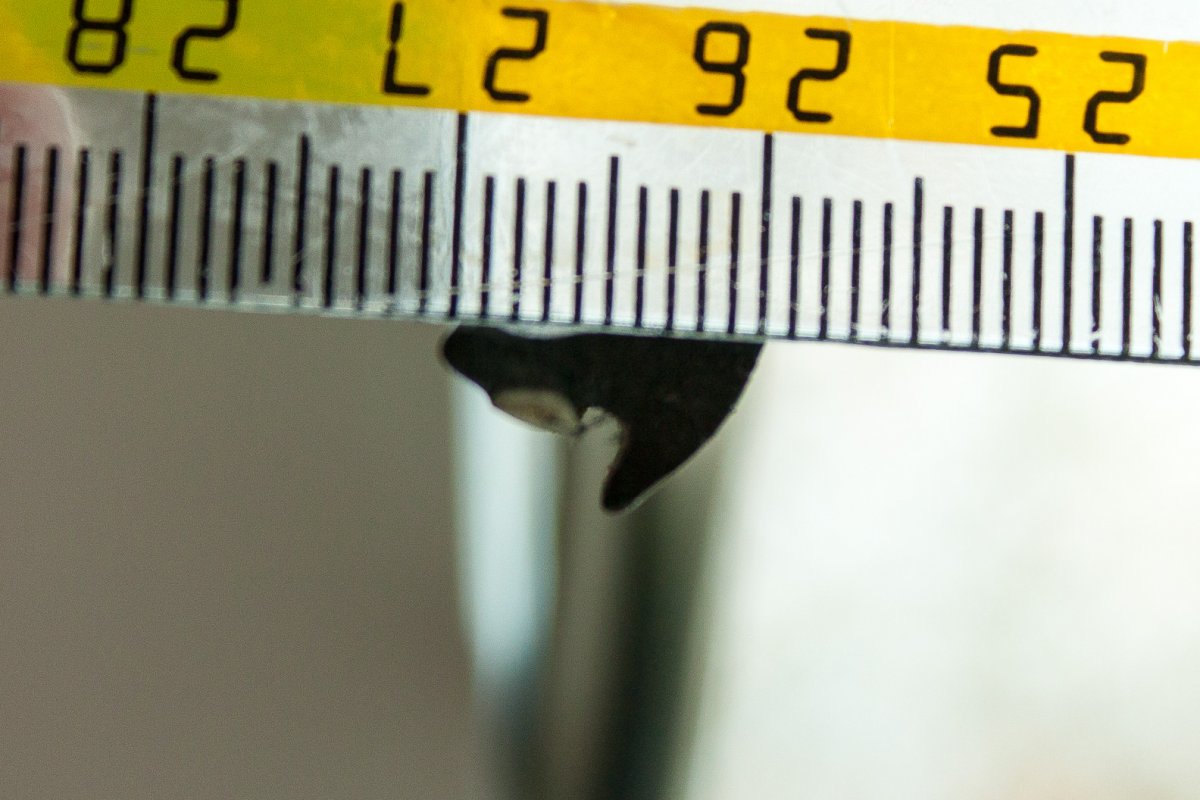

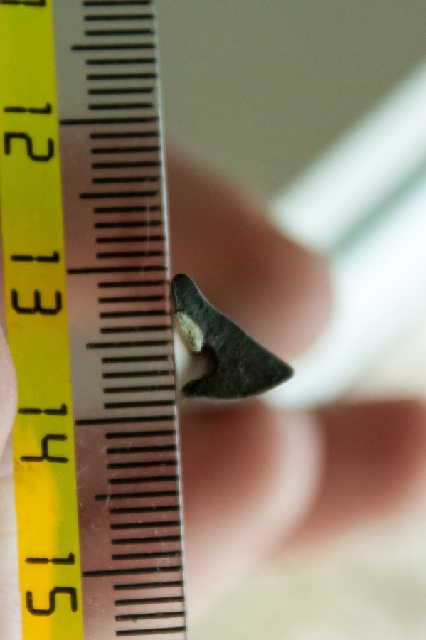

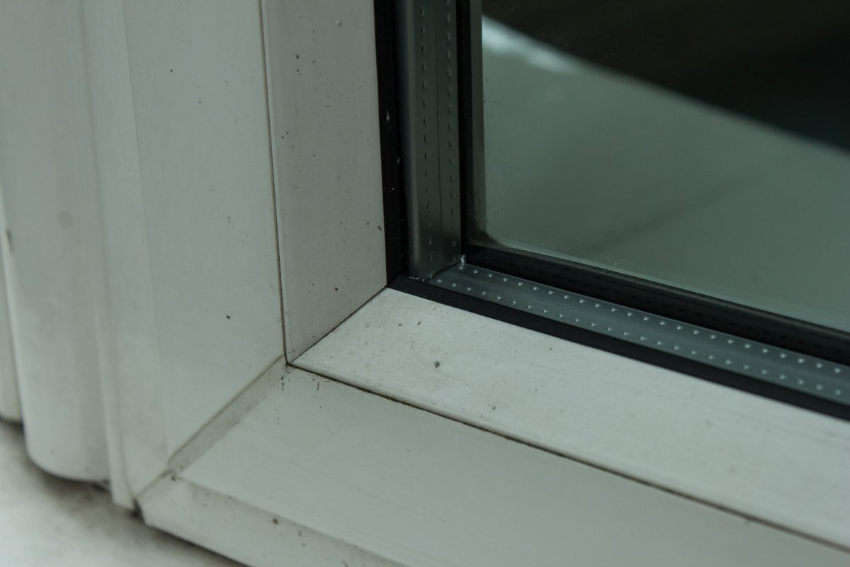

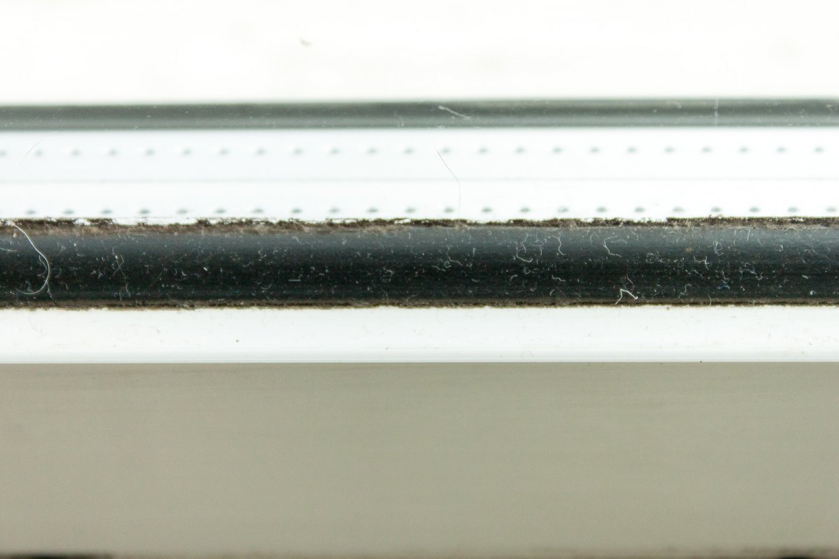

Here are some images. The wedge gaskets do not look too bad to be honest. Just need a good clean (best non-solvent cleaner?). All seem to have avoided any significant shrinkage so they may be OK for re-use. I have attempted at some measurements of the gaskets. I will have a look on ebay at the dimensions diagrams and order a sample pack. Any thoughts would be welcome.
window gasket-1.jpg window gasket-2.jpg window gasket-3.jpg window gasket-4.jpg window gasket-5.jpg window gasket-6.jpg window gasket-7.jpg window gasket-8.jpg window gasket-9.jpg window gasket-10.jpg
I think those gaskets look fine , I'd be happy to re use those, as for cleaning , soak them in a washing up liquid solution , it should loosen the grime and then wipe off...
Thank you for the suggestion. I have however read on many websites that washing up liquid should not be used as it contains solvents that will/can break down the synthetic rubber :confused: and also leave it a bit tacky (as in sticky).
I have come across a solution though...Autoglym Vinyl and Rubber cleaner! What is good enough for car gaskets and seals I assume should be just as good/suitable for windows gaskets.
