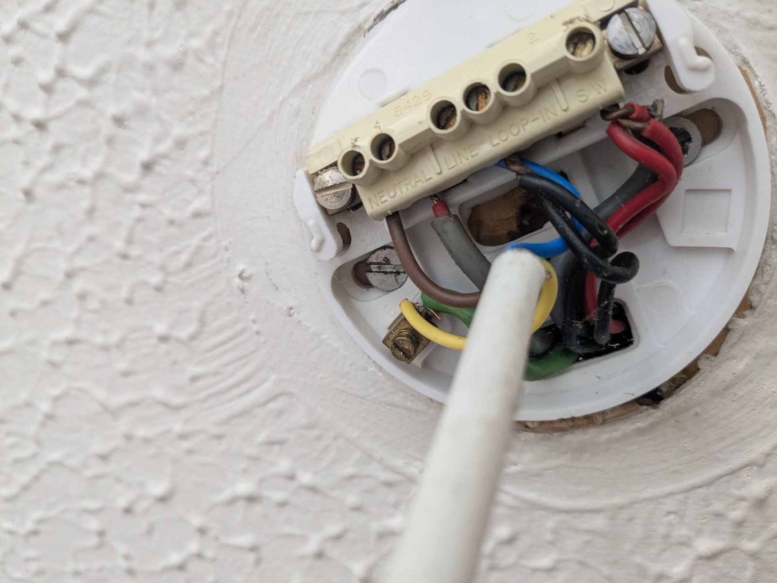

Looking to replace light fitting at voth bottom of stairs and top of stairs. Both lights are operated by both... The bottom or/and top of stairs.
This is the existing.

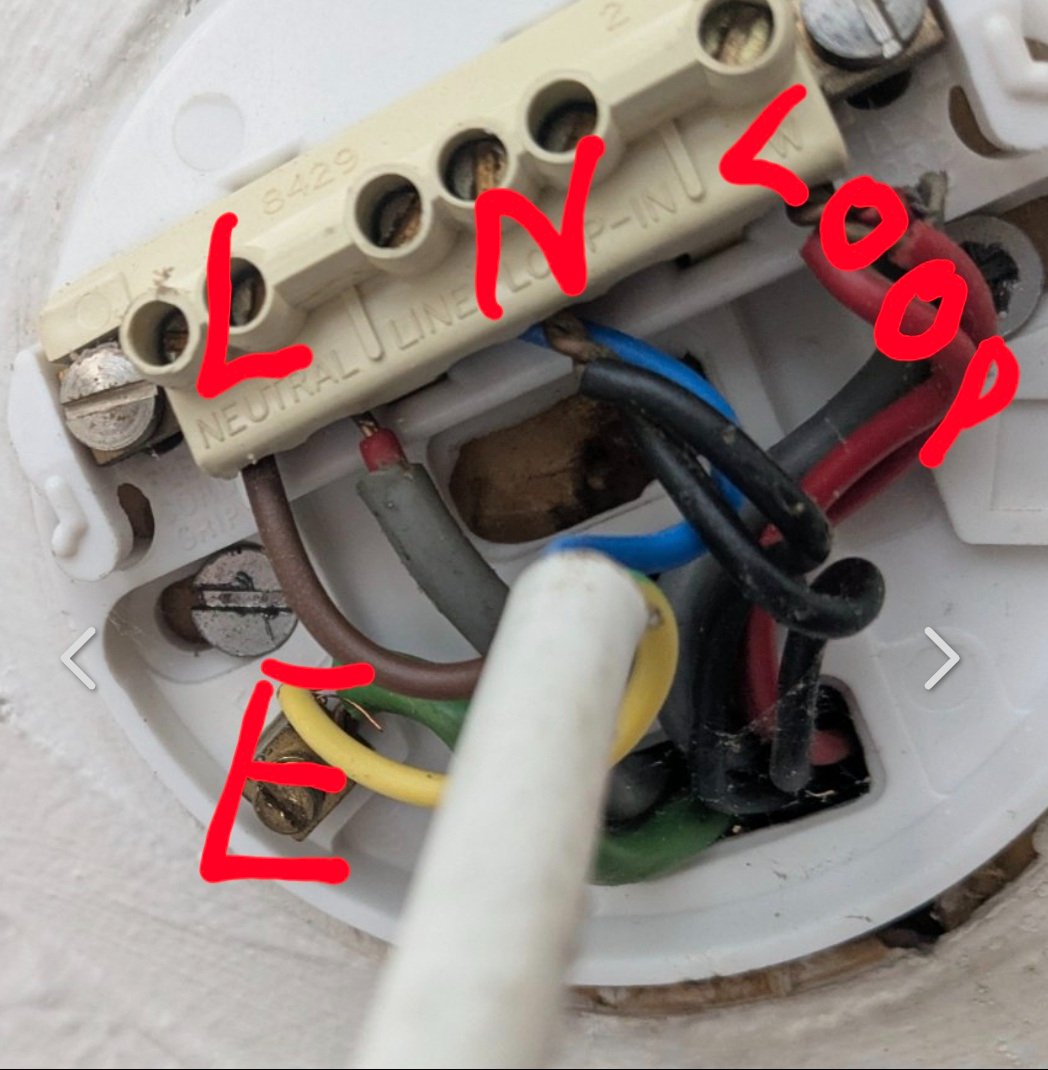

How should i wire the new light, which has N / E /L
---- how i read it is...
- the existing neutral to N
- the existing switched live to L
- the line loop in connected together. In a box
- earth.

Yep, the live and neutral are loop in and out
it looks like a straight forward ceiling rose - with Live/neutral/earth in and then a loop out for live/neutral and earth to the next light fitting
then a cable live goes to the switch and a switched live returns
not sure i follow the 2 way switch - but if they are then the connections would be in the switch somehow

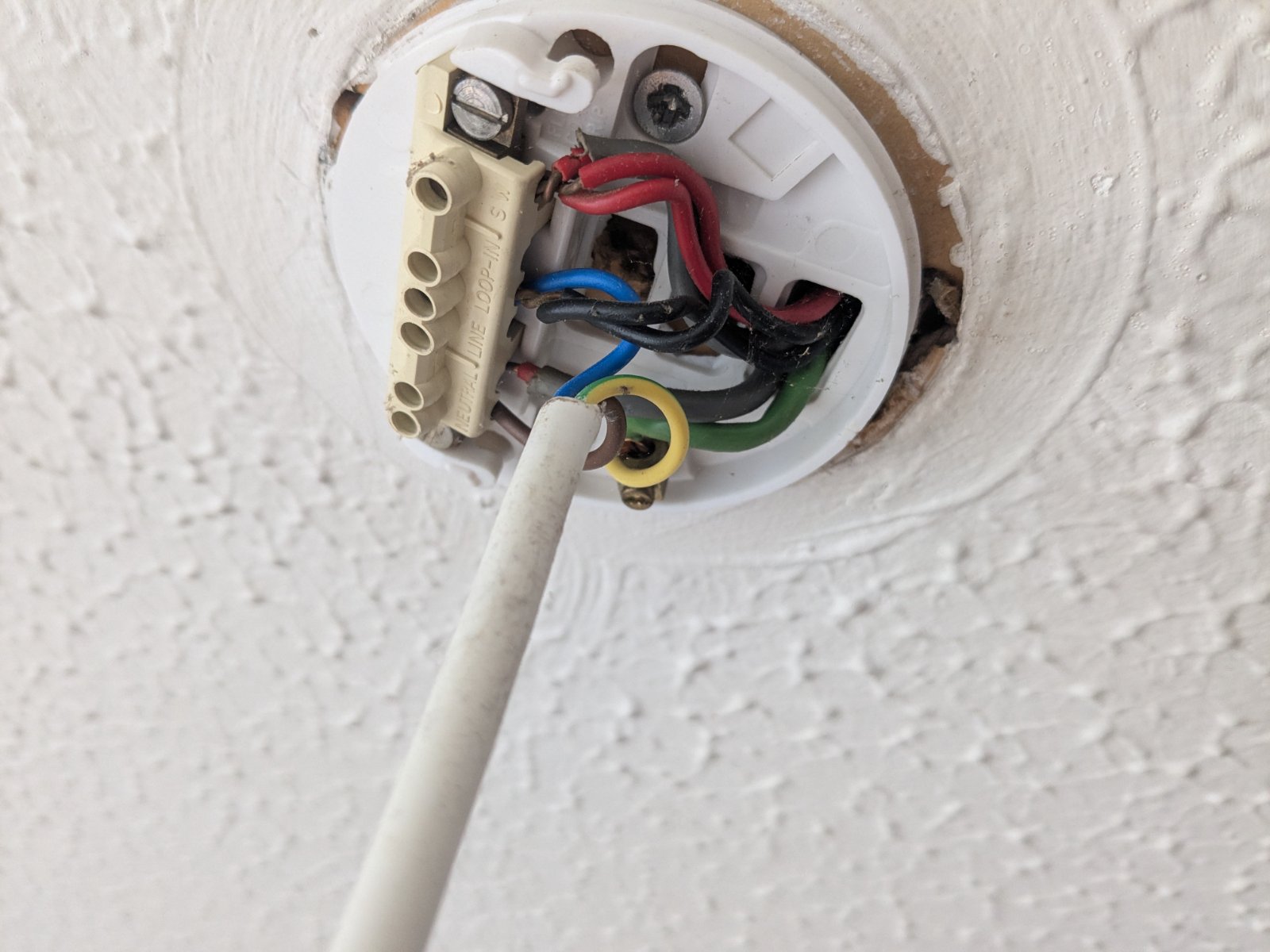

BUT for replacement - then as you suggest
looks like the ceiling rose for 2 lights are on seperate switched ???
Loop in a separate connector block.
And turn all lighting circuits off, landing circuits can have borrowed neutrals.
In the main, I use these
