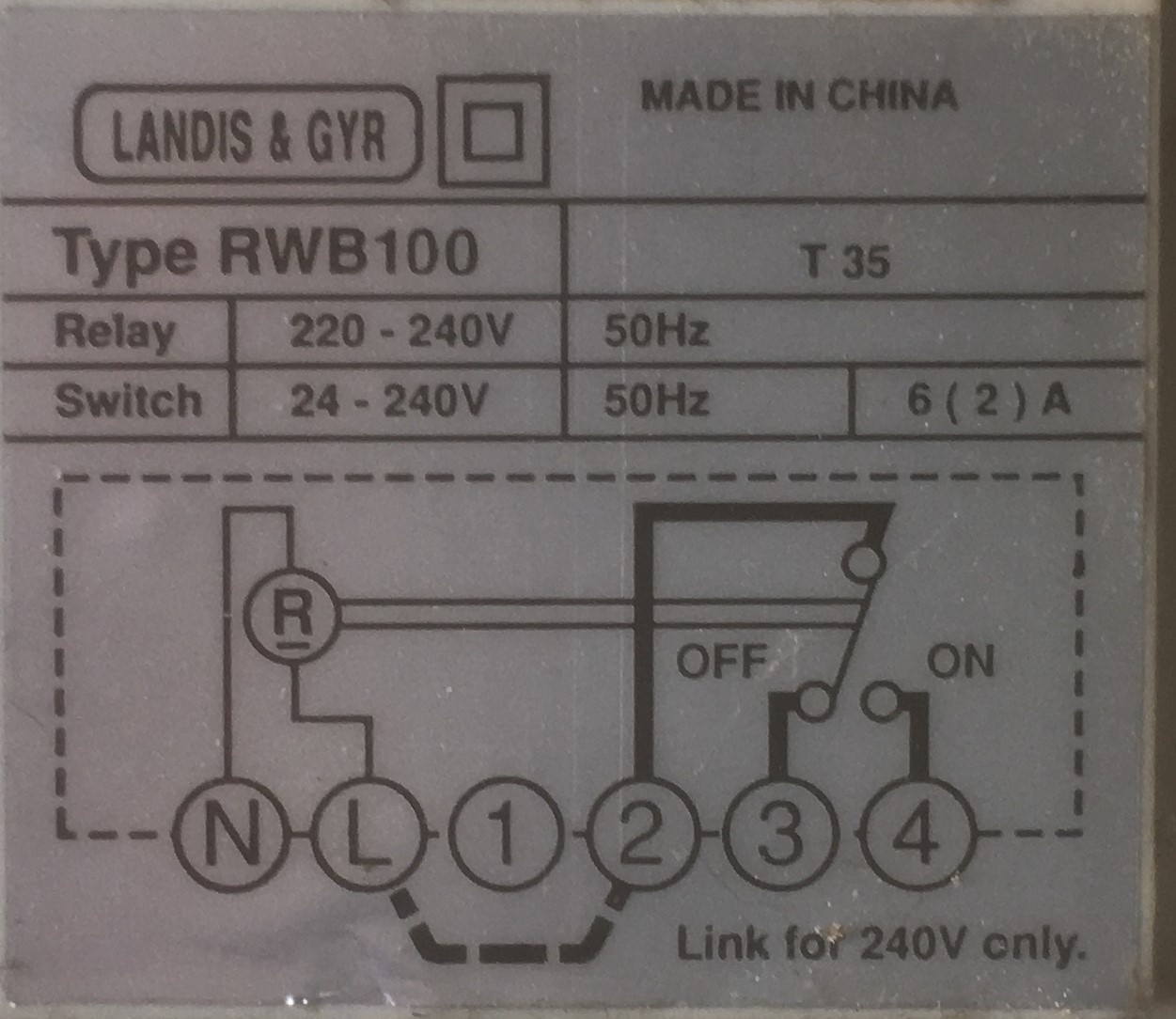

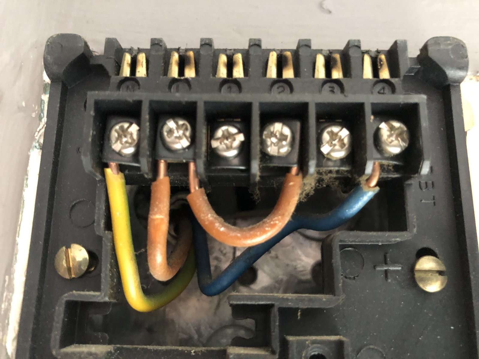

My existing Heating Controller is a Landis & Gyr RWB 100 and is only controlling the central heating with no internal thermostat.
I have the single channel Hive receiver just to control the boiler.
If you look at the wiring picture there is three wires (Earth Wire = N / Brown Wire = L and Blue Wire is in no. 4 with a link between the Live and No.2
My question is, do I just move the brown link wire from 2 to 1 and move the blue wire from 4 to 3?
Much appreciated,
Kevin.

yes ,and the yellow in N is not an earth wire, it is a Neutral, never go by wire colours in a heating system
The clue is in the terminal marked N that the wire in question is connected to. It's what a wire is connected to at each end that determines its function not the colour of the insulation.
However, someone has used a wire with yellow and green insulation for a Neutral connection. It's bad practice to do this as it causes confusion.
so technically there is no earth wire. Am I correct?
...in the installation pictured, there is no earth wire.
As above, the yellow/green wire is being used as a neutral, and should at the least, be covered in blue sleeving.
