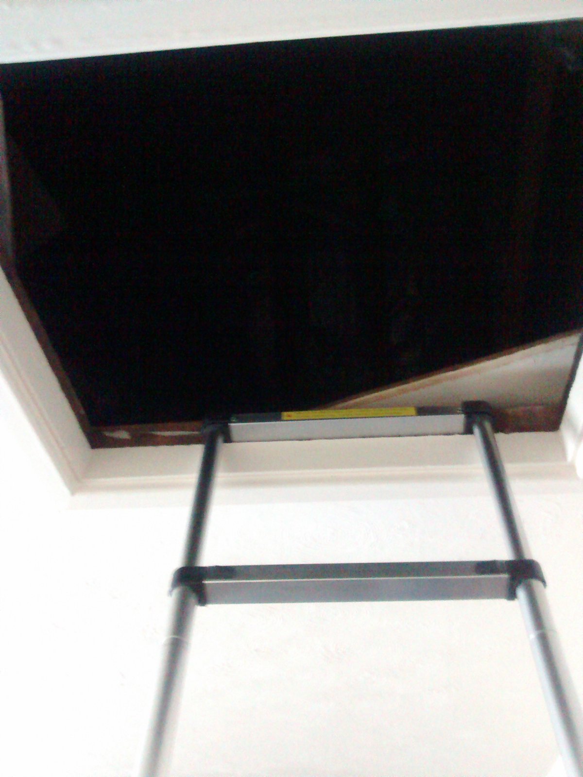

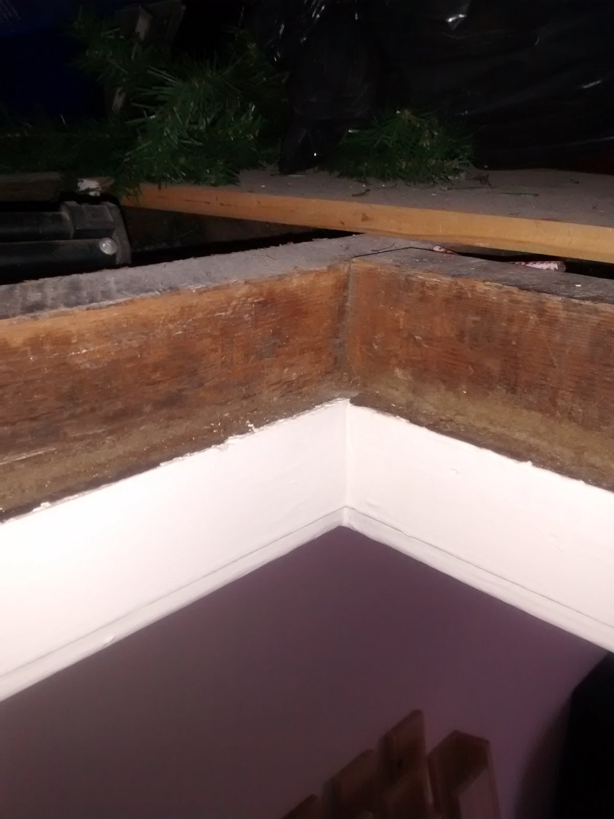

Ah, well to be a batten is a small strip of wood but I've never claimed to know much about DIY. Anyway here are some pics

The hatch already sits on a small lip, so you just need to clean it off, and put the draght prrof seal onto it, then drop the hatch back into place.
Cool, thanks. Got it. Now I just need some smallish pieces of PIR! No room for overlap above the board/hatch actual size due to surrounding joists.
