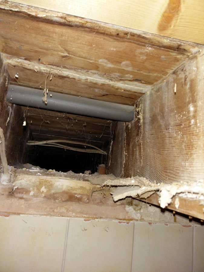

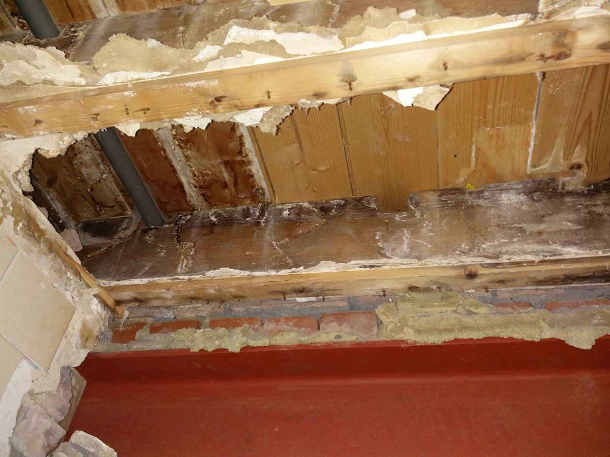

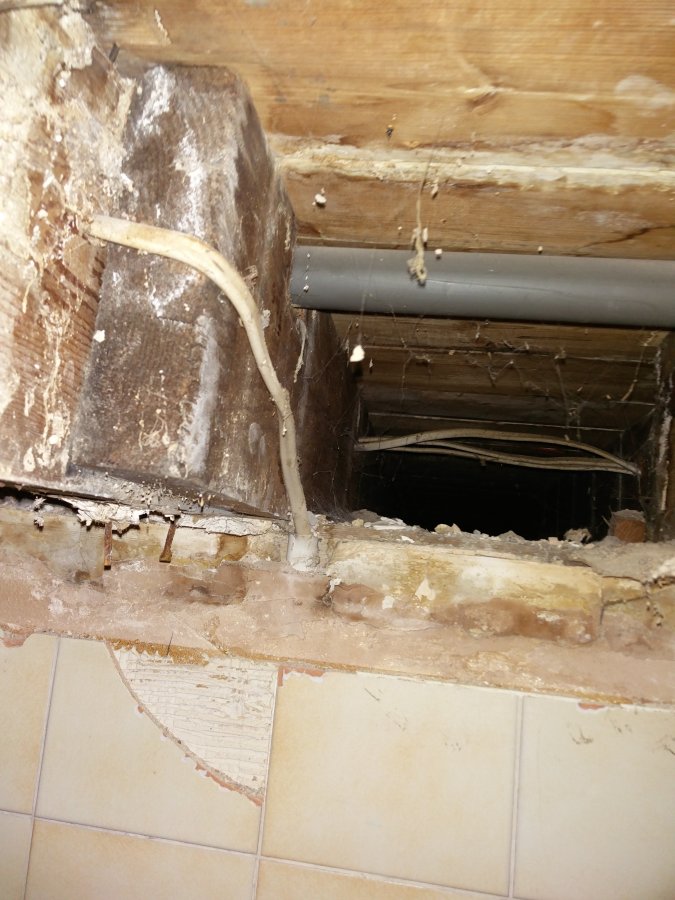

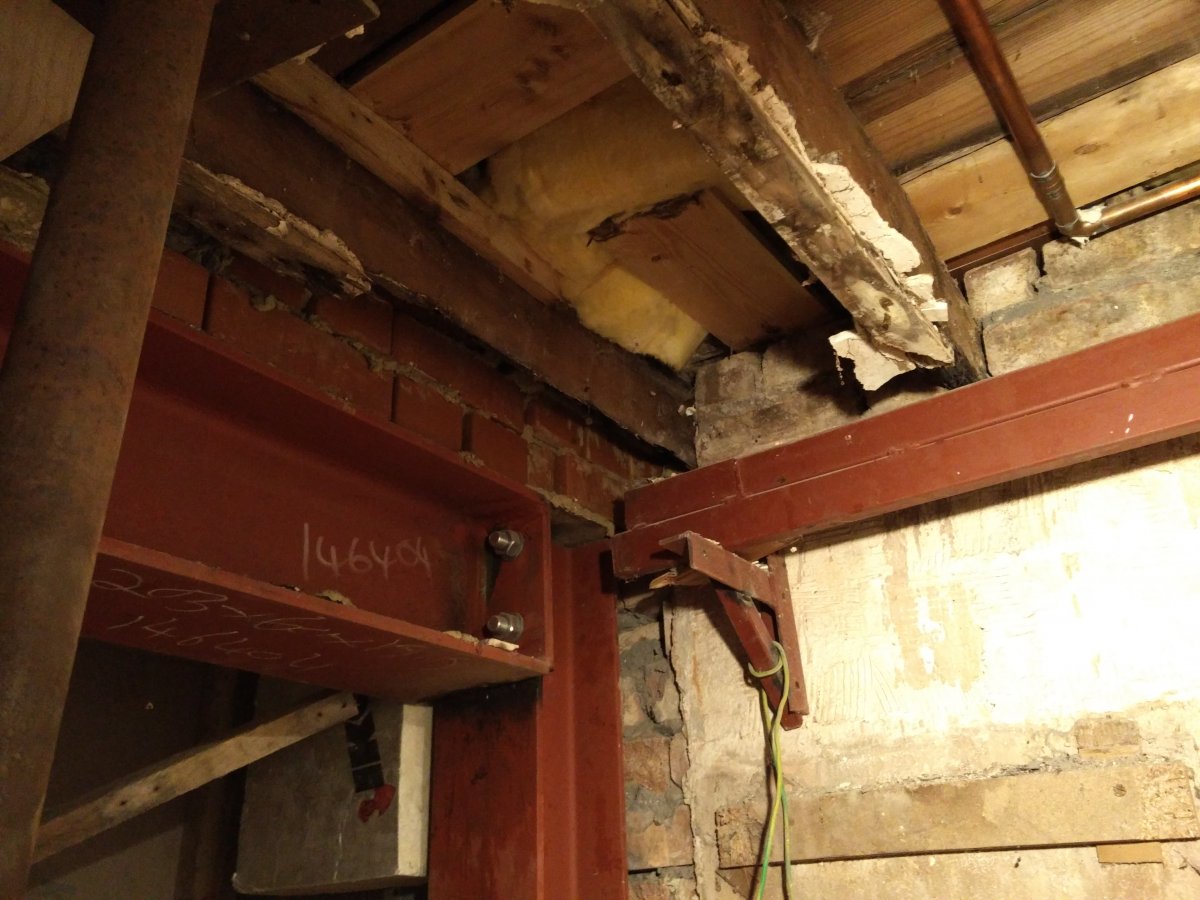

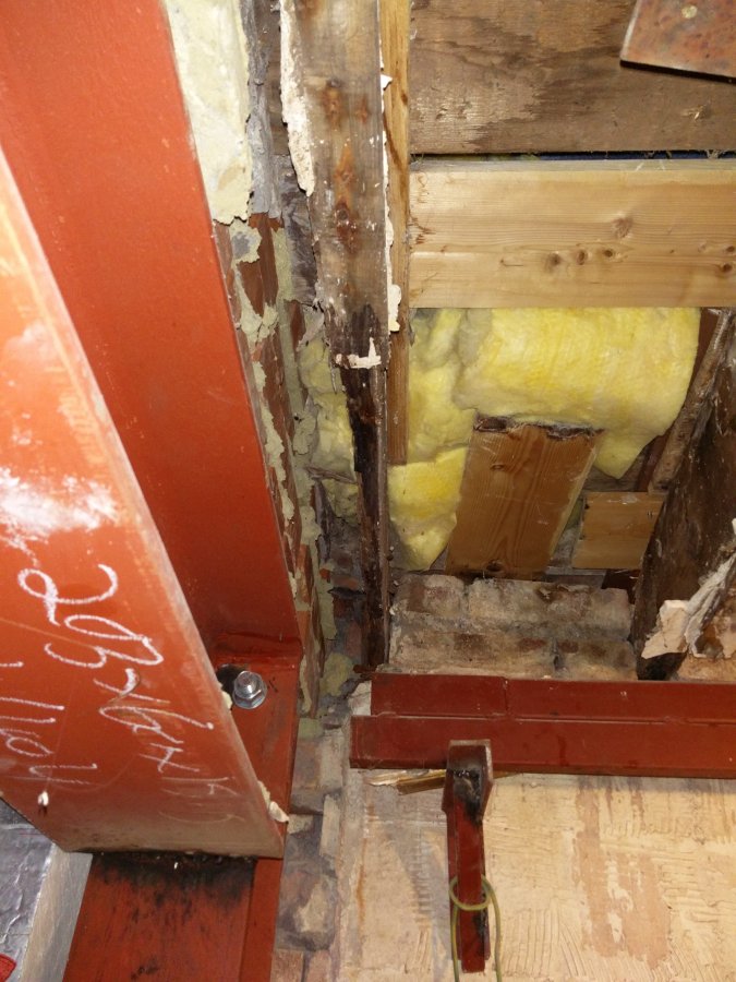

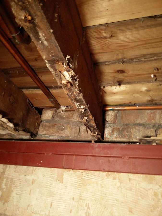

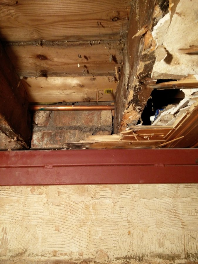

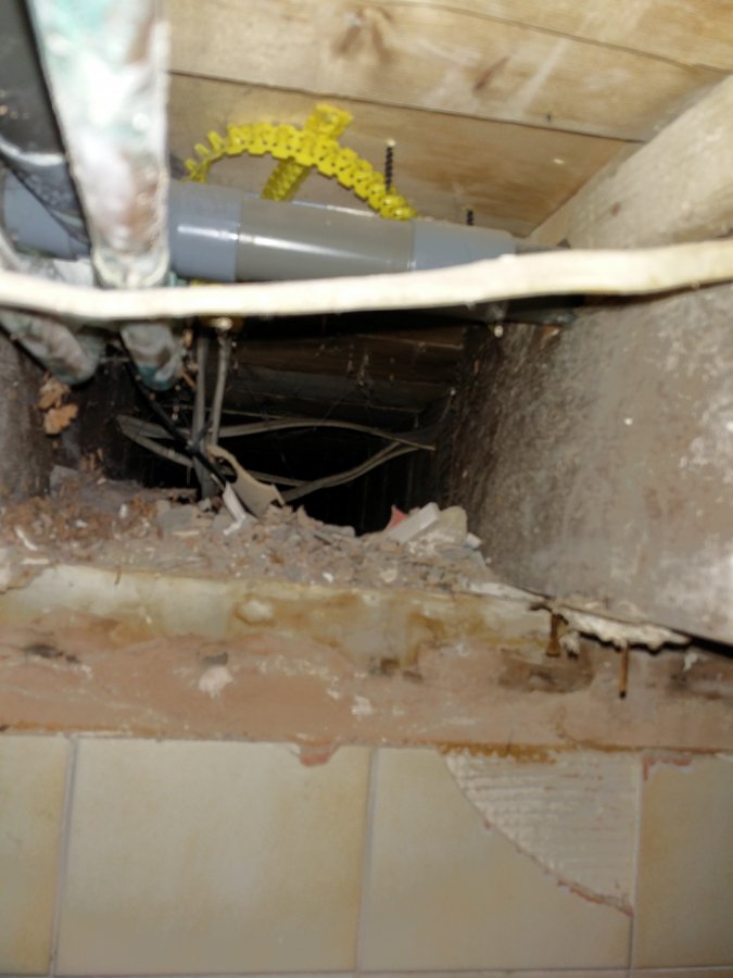

So, fast forward 3 and a half years... and the old kitchen ceiling has been taken down... and here are the pics!
IMG_20160615_061955.jpg IMG_20160615_061958.jpg IMG_20160615_062001.jpg IMG_20160615_062009.jpg IMG_20160615_062016.jpg IMG_20160615_062022.jpg IMG_20160615_062028.jpg IMG_20160615_062057.jpg
The one closest to the wall (next to the ub) seems to have suffered the most.
Access from the bottom is open (as you can see in the pics!) but the top is still covered and will remain for the time being with tiles and the bath tub!
The damage was caused by two separate damp/leak problems.
First a blocked drain at ground level soaked the wall, all the way up to the 1st floor, loosening tiles against the bath tub. The loose tiles then let water come down from the bath so the joists (and old ceiling) got a right good soaking, for a considerable time. Both were rectified when i purchased the house, however im now in a position to actually clear up the mess left behind.
Some of the plumbing will be tidied up, the water for shower currently goes under the boards to the wrong end of the bath, then a u turn abd back in the direction they came from. Once rest of the ceiling is down, they will be removed for the shortest route.
Advise on replacing the joists please? To note, if i put hangers in, there appears to be a large gap between where the new hanger would go into the brick, and the brick above! not sure if its infill of sort or if the wall has sunk... Will investigate when i get more open.
