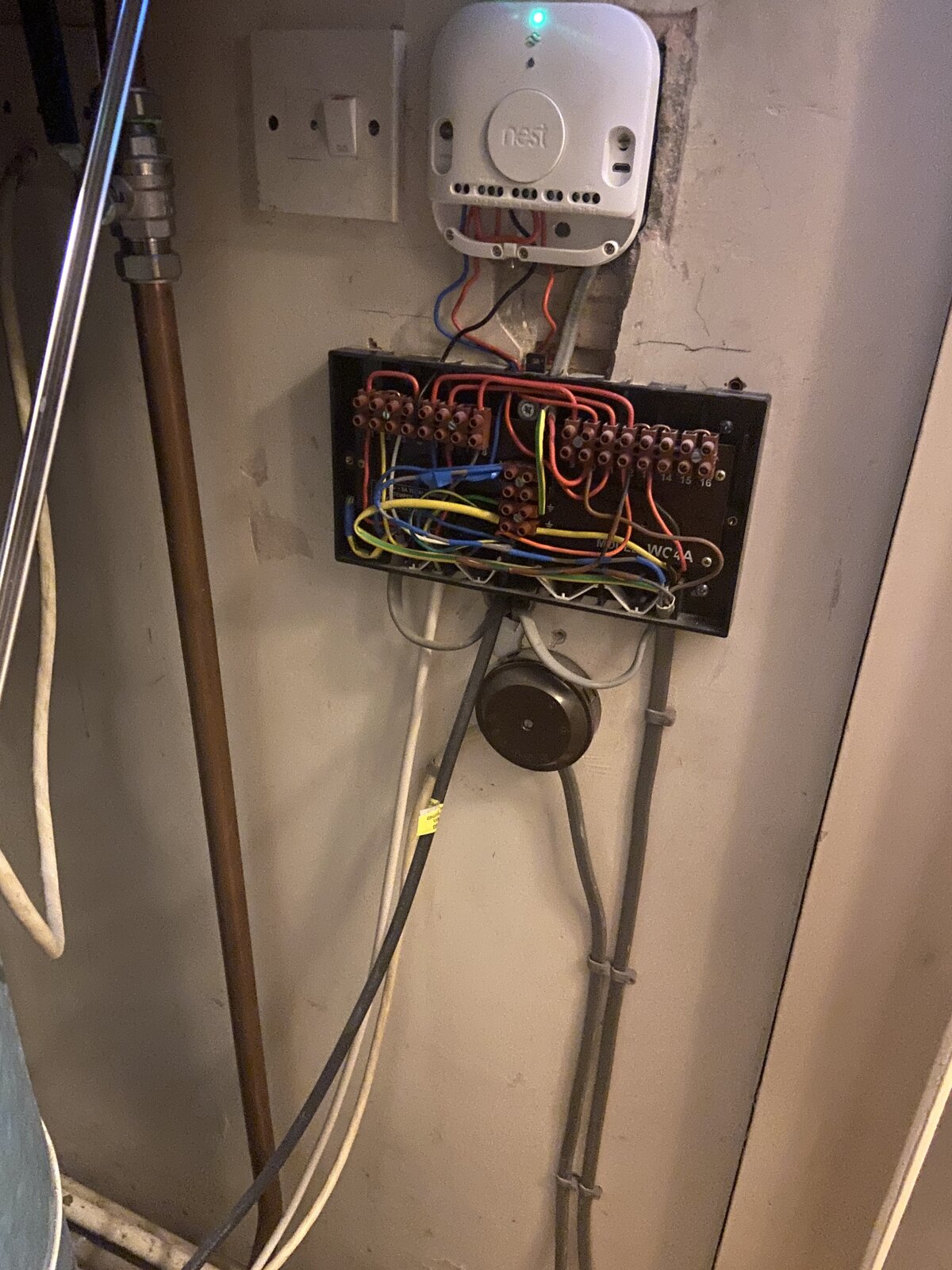

Attached are photos of:

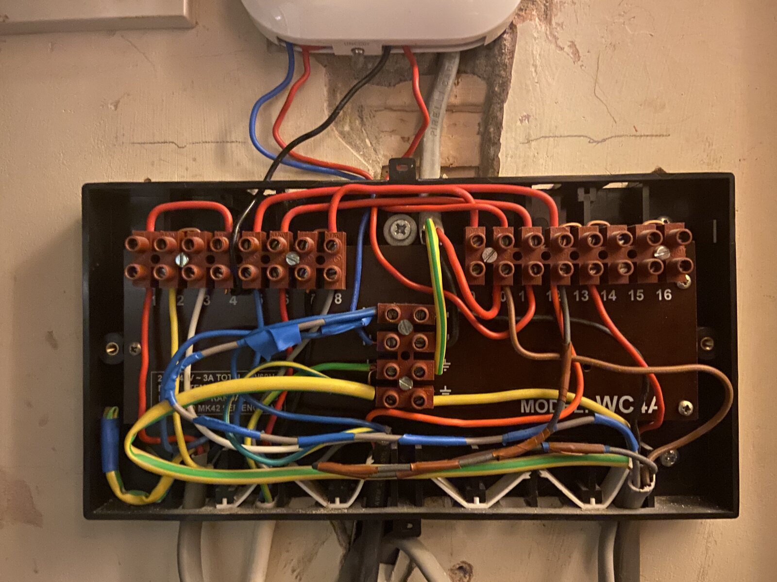

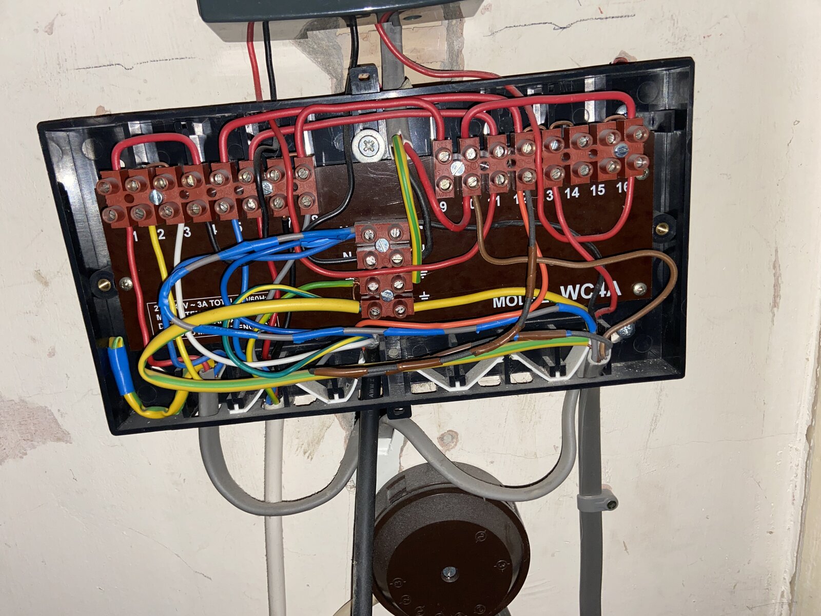

-The old and new wire boxes,

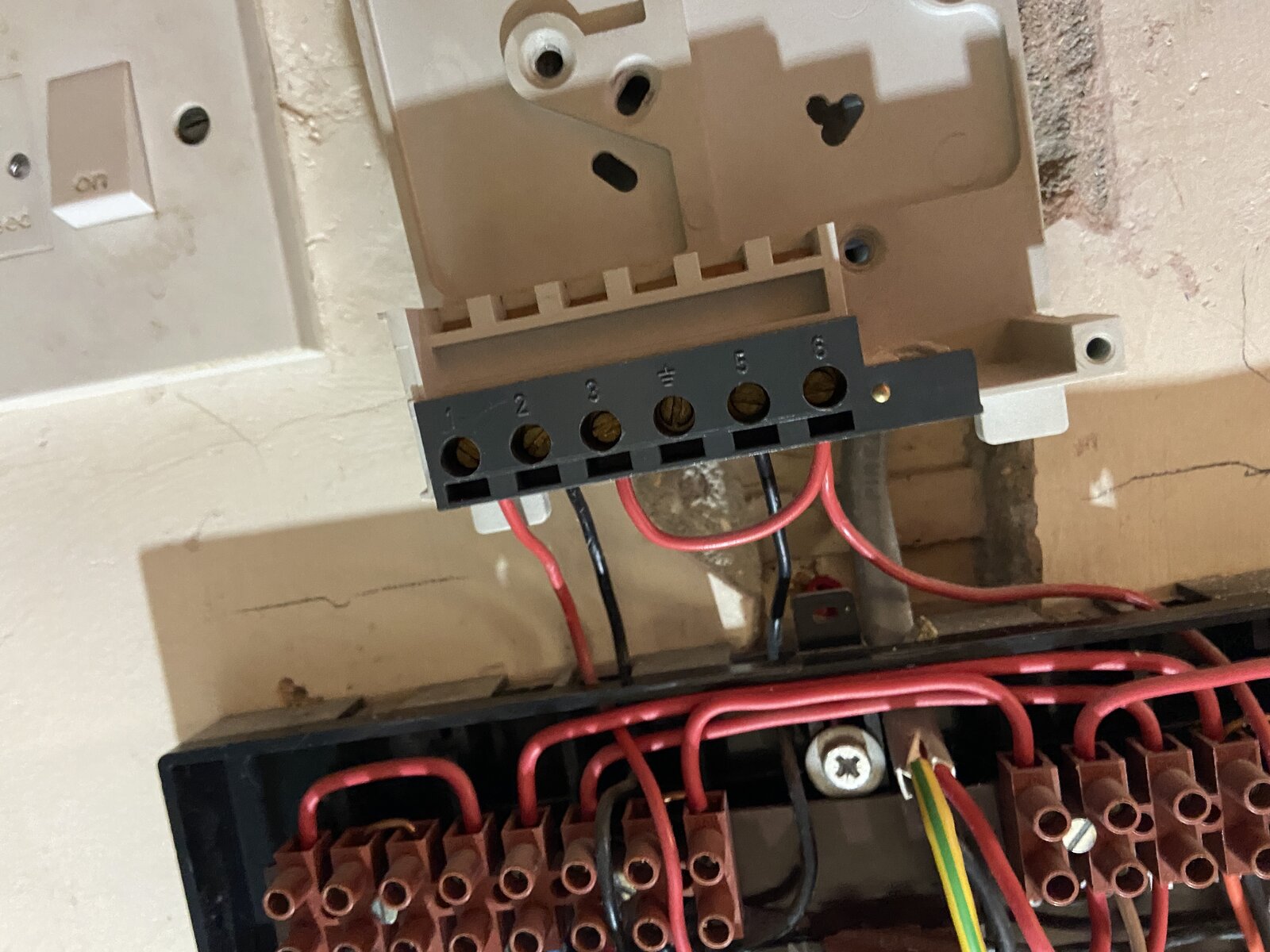

-The old randall plate (1 Water on, 2 Heating on, 3 Com, 4 earth, 5 N, 6 L)

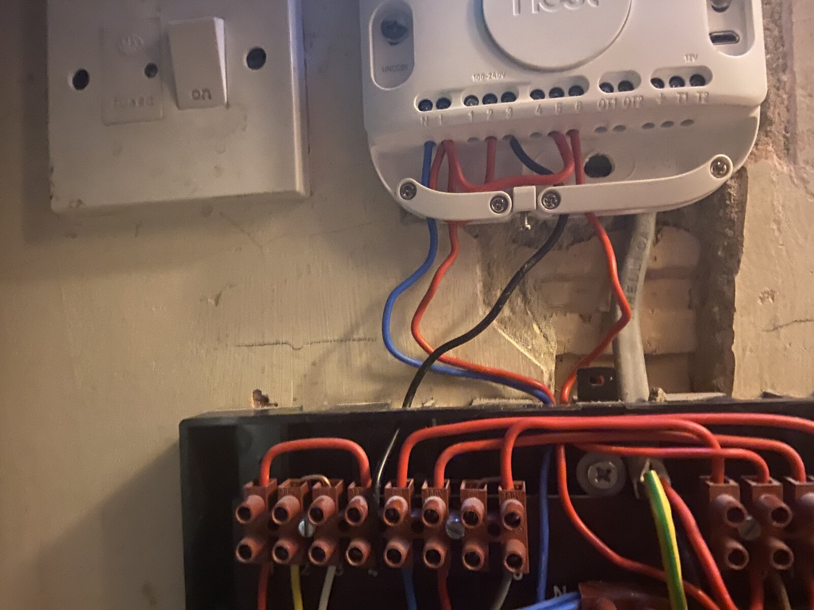

-Nest link. L is looped to pins 2 and 5
-The nest link wiring, fyi the red cable from nest 6 that's on the right comes down and around in the bottom of block 11. The red cable from nest L goes to the top of block 10.
-Other info

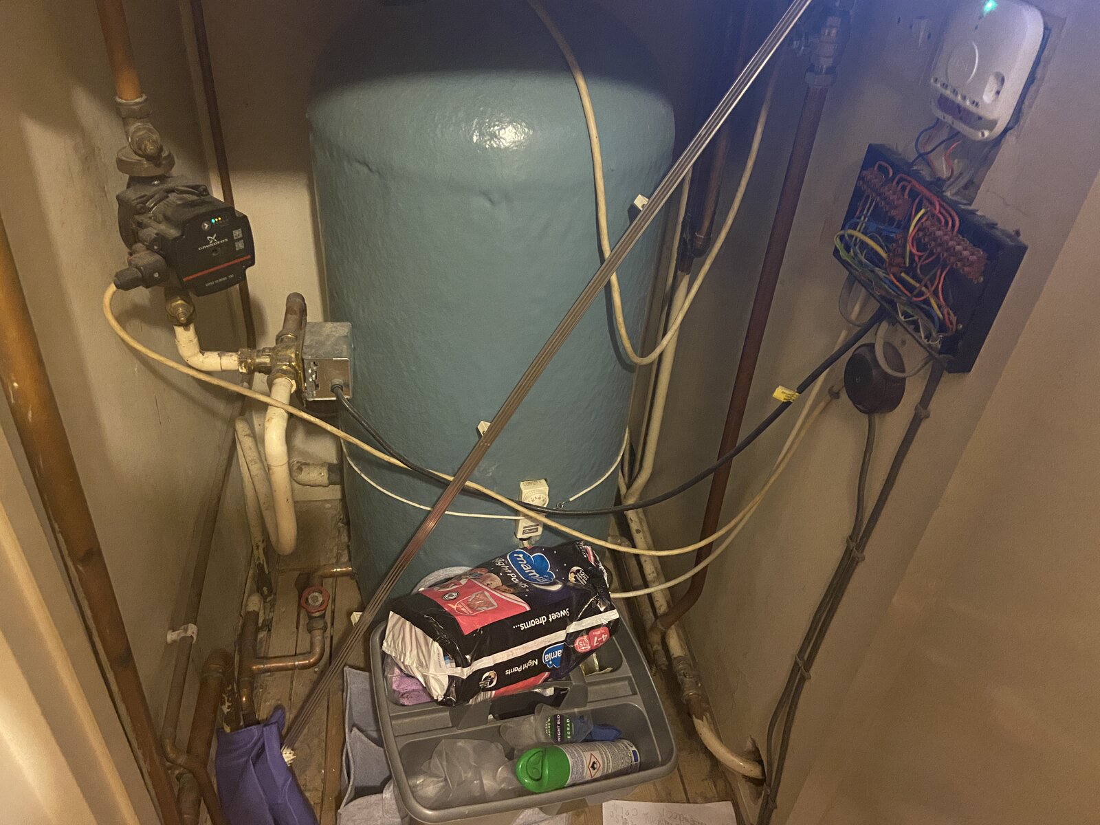

--The thick white cable on the left goes to the tank thermostat,
--The black cable (look on old wiring box for better light) goes to the valve,
--The dark grey on the right goes down to the boiler, you can see it come back up to a brown round junction box which goes off to the pump
--At the top of the junction box is a thick grey cable, this is the power from the switched spur to the left of the link
-Airing cupboard

You need a wire to connect number 4 on the nest to number 9 in your wiring centre.
But you shouldn't be using single insulated wires like you have. You should use a short piece of 3 core flex for the live and neutral and a piece of 4 core for the switch wires.
Thank you.
Just to confirm, #9 is linked to #8 which is the grey wire that comes from the thick black cable that runs to the valve.
That was the how it was previously set up. I moved a couple of wires around to make the cables reach the nest link terminal locations, but I can certainly replace those.
That is correct. It is the hot water off terminal which connects to the grey wire on the 3 port valve terminal 8 and the satisfied on the cylinder stat terminal 7.
