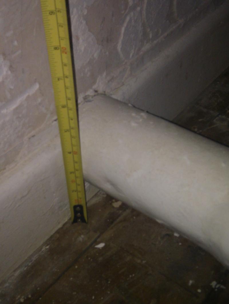

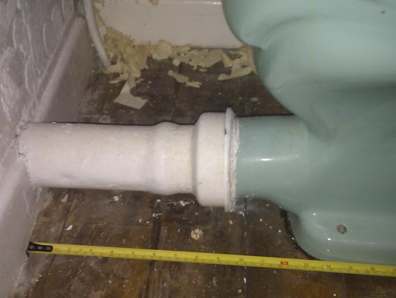

Hi,
I have decided to replace the the soil pipe coming in to my bathroom so that I can fit a new Armitage shanks Sandringham 21 toilet I have purchased.
I am looking for a bit of advice and guidance.
The soil pipe in the bathroom is 82mm 3.25, it is very low to the floor the cent diameter of the existing pipe is 4" from the bathroom floor.
The new toilet outlet is 190mm from the floor.
Would it be best to run the new soil pipe in slightly lower than this, would that be a standard height? Also I assume the soil pipe needs to be slightly angled downwards to the outside?
What is the best way to get through the outside wall inside? Can I remove some brickwork on the outside and the inside then make good the outside and inside walls? I'd rather not go down the route of a core drill. Am I right in assuming the new soil pipe should be 110mm?
Connecting to the outside soil stack... Will it just be a case of removing the old cast iron pipework? Then using an adapter put the new soil pipe work into the stack?
Thanks in advance for your help.
Photo of the outside and inside below...
Your soil pipes are 110mm, I would core the hole, you can hire them less hassle than removing bricks of internal and external leafs.
Ideally you wont a slight fall from the toilet to external elbow.
As far as height is concerned measure to centre of pan hole, then mark up on wall an pilot the hole before coring.
Likely you will need a drain connector for soil branch.
g[/net]
Not quite - you need to remove the lead pipe which is connected to a brass thimble that`s caulked into the branch of the stack - see the "lump " on the pipe , that`s a wiped joint lead/brass - you then need a fernco connector from the brass to your new 110 mm black plastic , and some bends to get you up to the new hole . It won`t be pretty , but that stack is pipenailed to the wall and if it does budge trying to remove it - it`ll be damned heavy - and it`s a b`stard size , being 3 1/4 inch

'Horizontal' waste and soil pipe runs are usually set up with a 2.5° fall - that's why many bends etc are 87.5°, not 90°.
Core drilling will be difficult, if not impossible, if the new and old holes overlap to any great extent. Consider removing a brick (looking at the pointing, that may have been done before anyway), or stitch drilling if you just need to remove a crescent shape.
