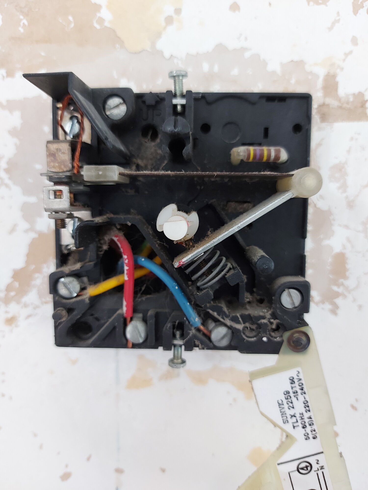

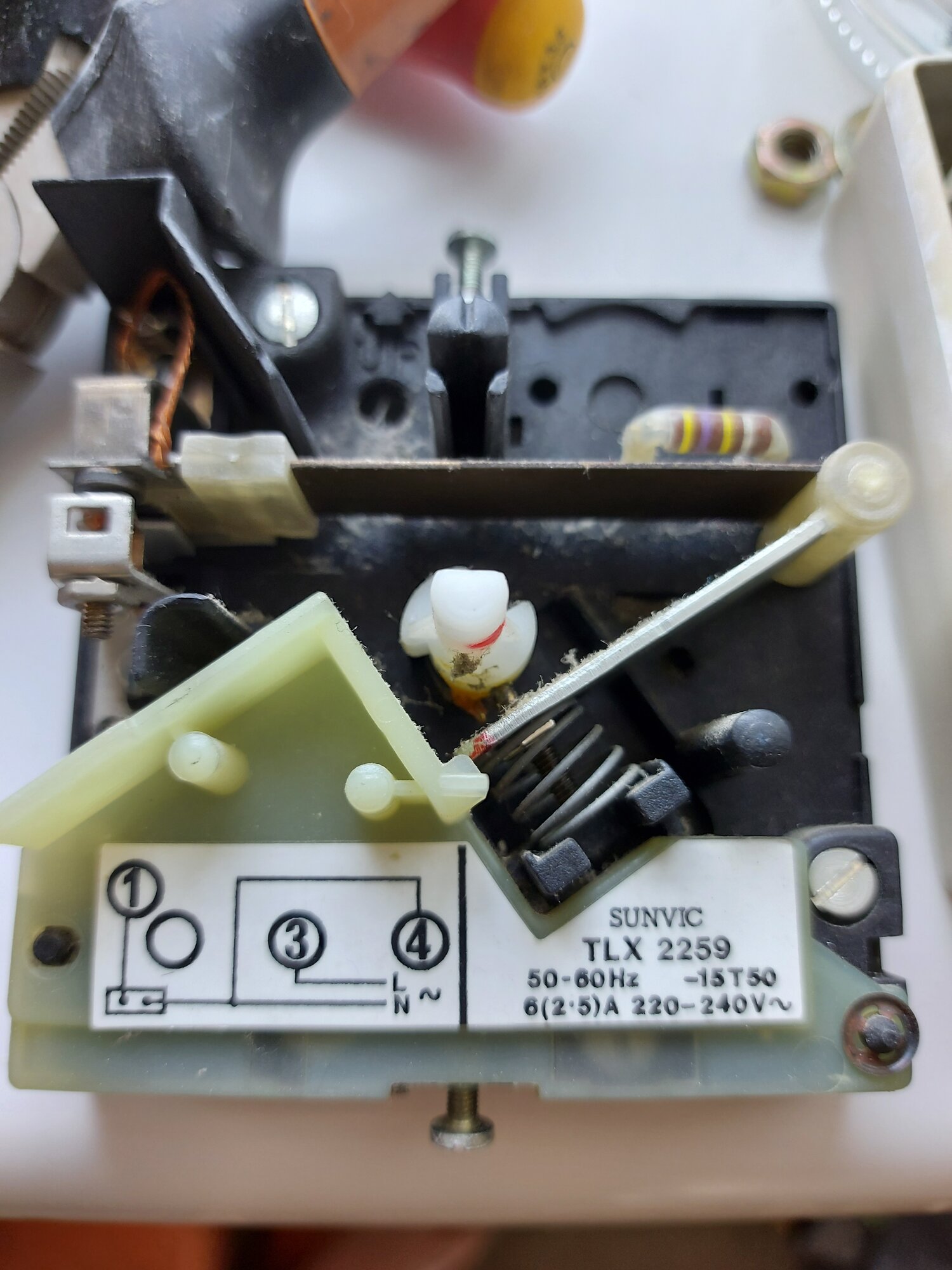

Hi I want to replace an old Sunvic TLX 2259 with a MoesGo BHT-3000.
I found similar threads for other models but responses seemed to suggest starting a new thread is the way to go.
The Sunvic was wired like this (3 wires plus earth) :

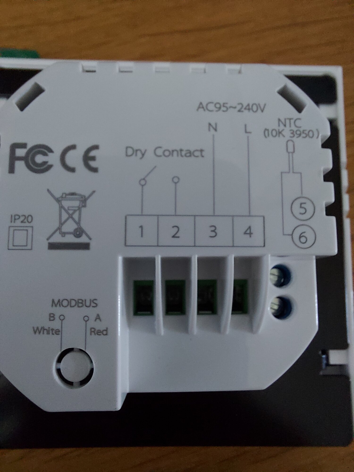

And here are the terminals for the new thermostat:
Any advice gratefully received, thanks.
Red - L
Blue - N
Yellow - 2
Fit a jumper wire from L to 1
Park earth in a terminal block
