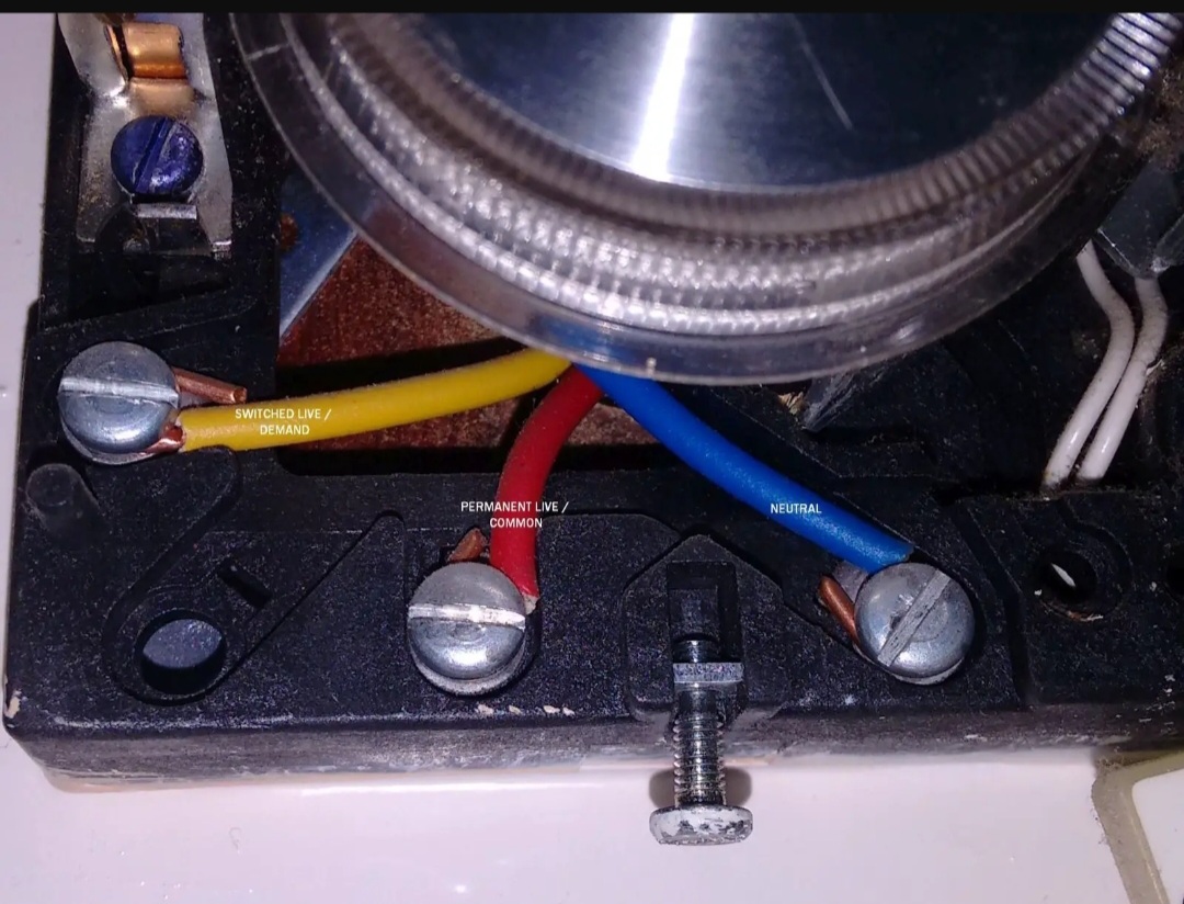

Hi I'm looking at replacing my sunvic tlx room stat with a eph cp4 thermostat the sunvic is wired like the pic posted from what I've read the live and neutral go to the L & N terminals and the switched live yellow wire goes to terminal 3 on the eph can anyone confirm this or have any input im very new to wiring

Yes, but if your Sunvic is mains switching (likely) then you’ll need a link to common (2) at the eph.

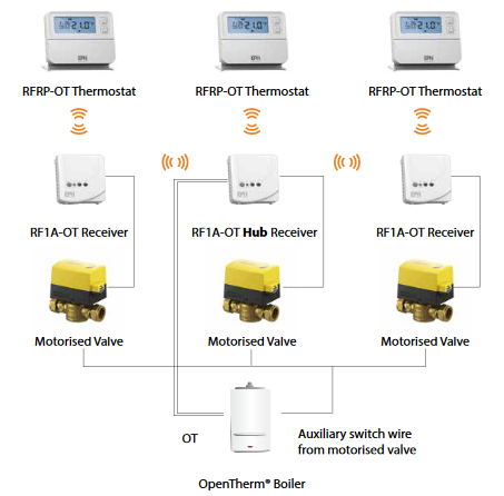

I have looked at the instructions for the CP4 and it shows the general diagram 1696312835261.png and the wiring diagram 1696312935785.png and the main point is the temperature sensing part is wireless connected to the units, and the units have connections for the motorised valves and independent connections for the OpenTherm to the boiler. So they are not direct replacements for a unit which combines all in one unit and does not require batteries or mains to power it.
I think the EPH thermostat is very good, and I am sure you could link Com (2) and L and connect to red, use ON (3) to yellow, and N to blue, but you must ensure the old Sunvic is 230 volt powered and there is a neutral. I have not looked up the Sunvic I am going by the labels you have put on the picture.
However it seems a bit daft to have such a good thermostat and then not wire it to use are the functions you have paid so much money to get.

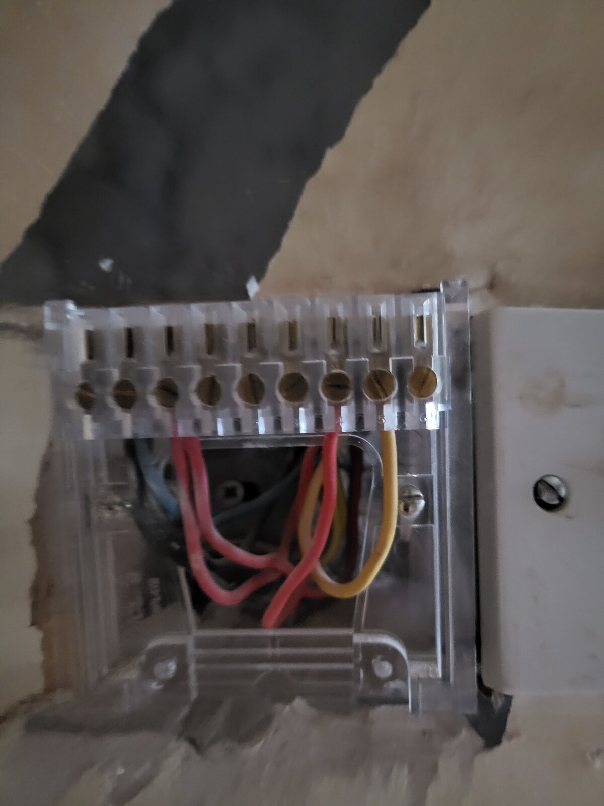

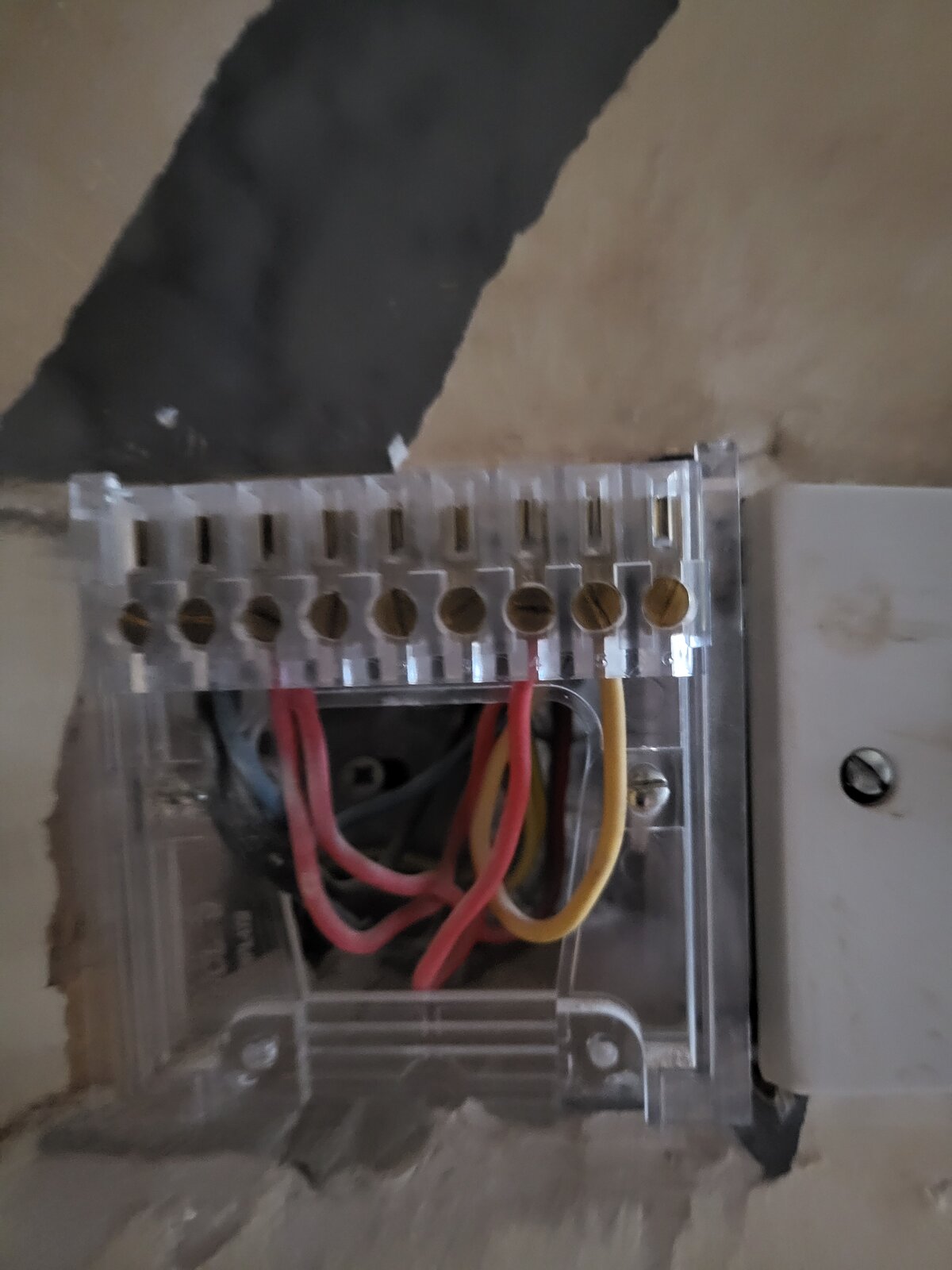

Anyone any ideas it didn't power up I don't know what I've done wrong will I need to done anything with my horstman h17xl timer
No, do not link N to 1. I take it you’ve turned it on at the horstmann?
Yes the horstman is working fine and the old sunvic worked fine also this just won't power on
Could be a dodgy unit, or maybe the permanent live isn’t permanent? Any test equipment?
What was supposed to be perm live and switched live weren't correct the yellow was permanent and red was switched and i just put the link where it was supposed to be then it worked
