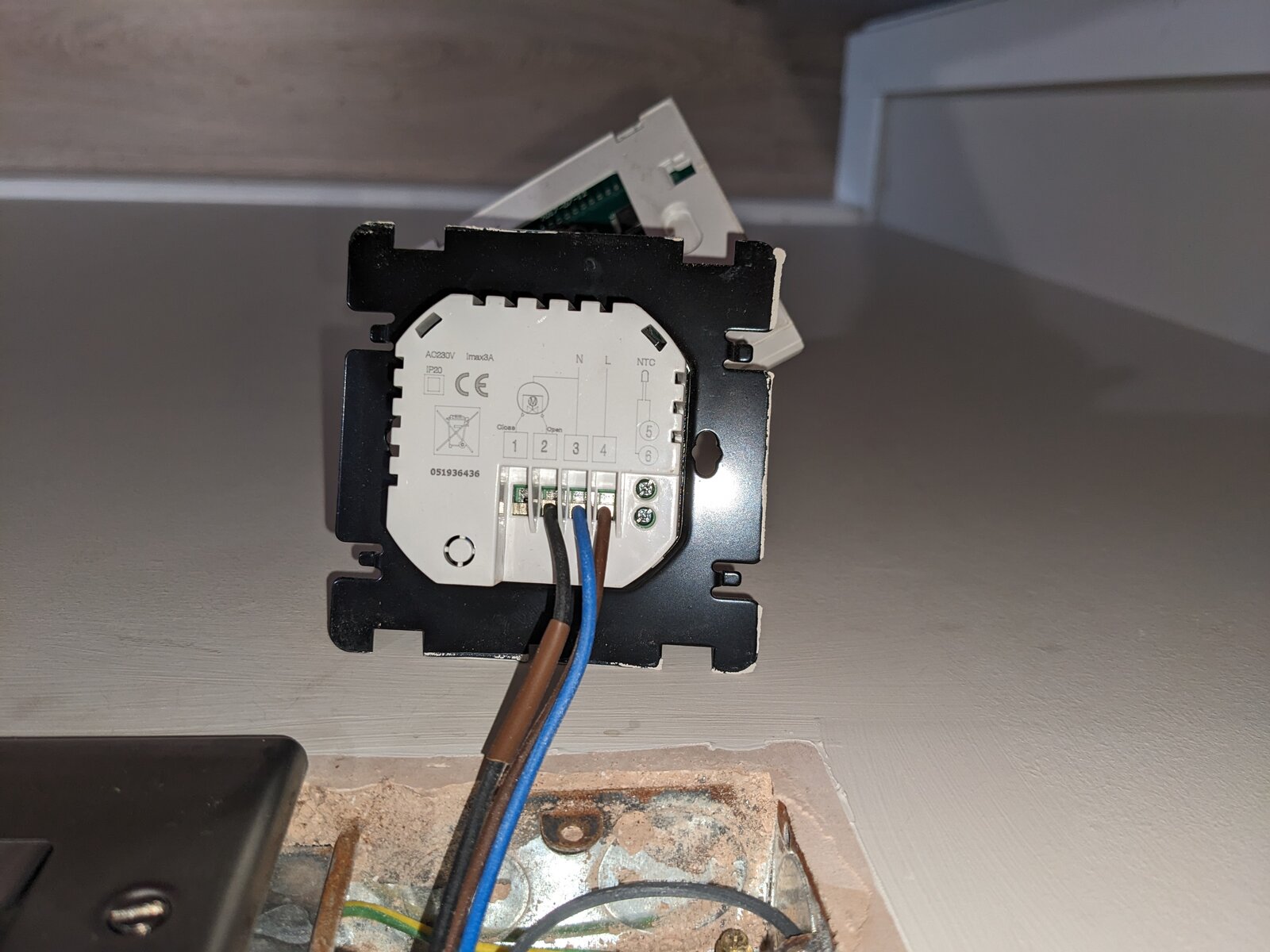

Hi there,
I'd like to swap my existing wired thermostat with a Tado Wired, but I'm not sure what configuration I need. My boiler is an Ideal ESP 1 30 which supports Opentherm modulating, so I guessed it would be 'digital'.
I've attached a picture of what I currently have on the Wengart. This Thermostat uses 3x inputs, but the Tado digital would be just 2x.
Any help would be gratefully received

Sounds like the Tado is battery operated, so only live and switched required. Safely terminating the neutral conductor in a chick block/terminal strip connector or Wago/similar. Opening up that boiler requires a critical safety check afterwards as it forms part of the combustion circuit, if you wanted to use opentherm.
Digital = on/off, analogue = up/down, so OpenTherm is analogue, but you are showing an on/off digital thermostat.
The important wires are 2 and 4, the neutral is not required with some thermostats, but Tado withdrew there OpenTherm in the UK, it is made for Europe, but not readily available in the UK. And would require new wires to the boiler.

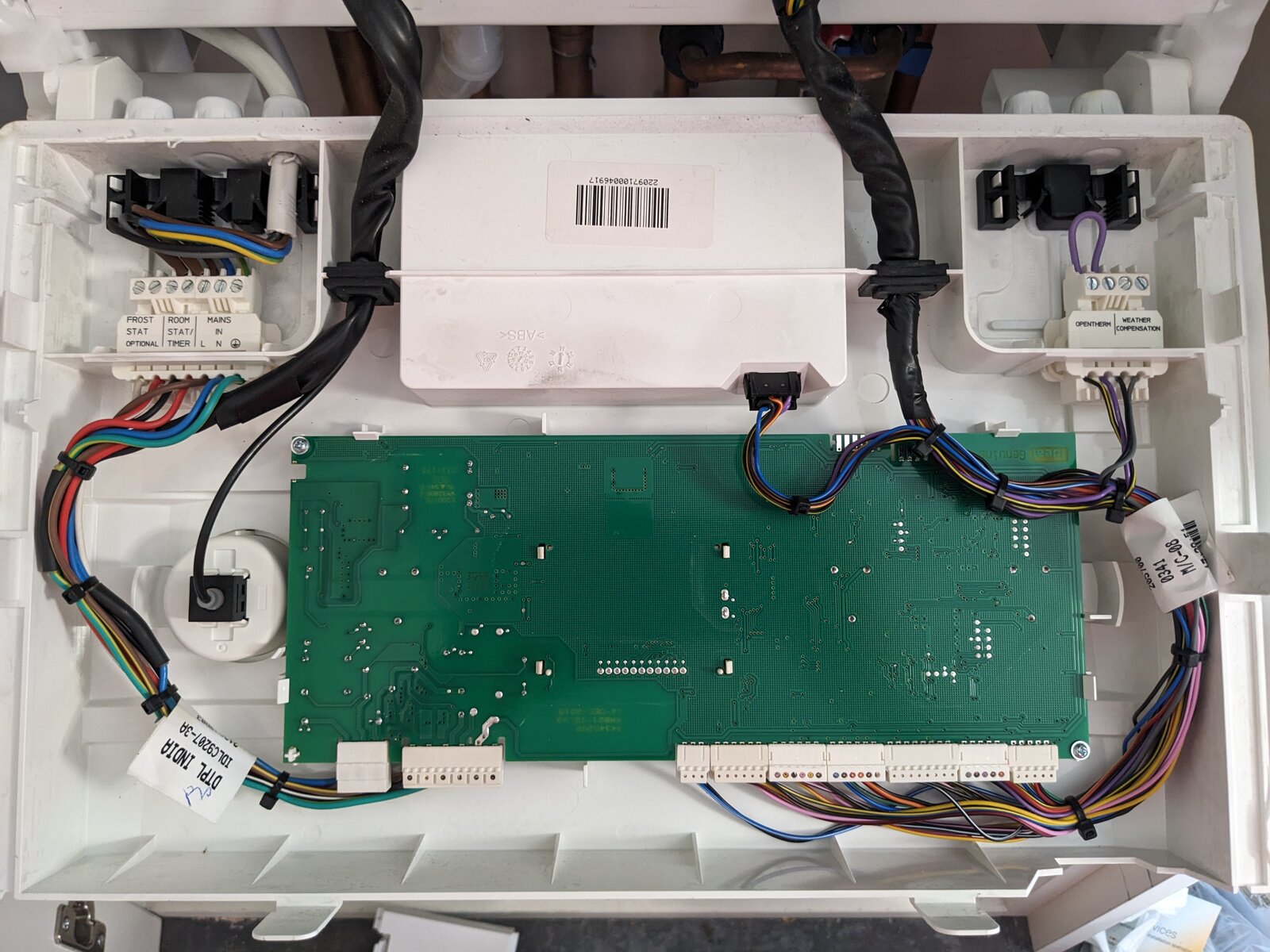

Hi Stucinarut, thanks for the reply. Do I need to enable Opentherm modulating on the boiler? Would that require rewiring? This is my current wiring setup, thank you

No it’s not to be enabled as such, the wiring would go to the opentherm connections on the pcb where the purple link is currently. So a small rewire would be needed as it’s extra low voltage, approx 5-7 volts. Please bear in mind what I said about removing the boiler cover.

One more question - I'm guessing the room stat / timer should be bridged instead when I wire to the Opentherm connector, or can I leave it open?

Looking in the instructions, it appears you leave it open.
