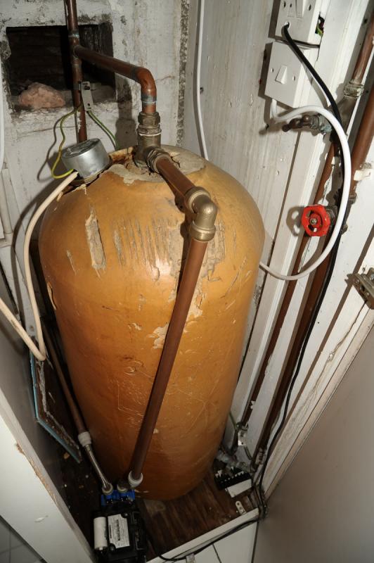

Hi. I'm new here.
Yesterday I tried replacing the element in my immersion heater, as the handyman who normally does it (the element tends to burnt out every couple years), is having problems keeping appointments.
I followed instructions on the internet, and I thought I had completed the job successfully, but now the shower pump that powers hot water from the heater cuts out after about 2 seconds. I've undone the pipe that feeds into the shower pump and there's only a very weak trickle of water.
This is a 2 bed flat in a tower block. No central heating. A cold water tank (head height), feeds the immersion heater, and then a shower pump takes hot water to kitchen and bathroom.
I didn't drain the tank when replacing the element. I just removed the old element and caught about a pint of leaking water with a towel.
Is my problem an air pocket? If so, is there a trick to remove it? As I said, the handyman has done this procedure regularly without apparent difficulty.
Thanks for any tips.
Elliot
poss an airlock.
have you checked the gate valve is fully open first on the feed to the cylinder ?

poss an airlock.
Hmm, gate valve? Before replacing the element, I turned a red knob on the inlet pipe to the immersion heater. It only turns a quarter of a turn. I've now tried turning it one way and the other, but it seems to have no effect. (This plumbing is ancient).
Regarding the pump working for 2 seconds. I think the trickle of water coming out of the immersion gradually fills the outlet pipe, giving the pump about a pint of water to work on before it gives up.

1/4 of a turn for a gate valve is not much they useally take half dozen turns to open/close one.
i would look in to the valve first if not change it.
Probably time to call a plumber. (The knob that turns just a quarter of a turn is the red one on the right.)
yes thats called a gate valve.
i useally replace them with a full bore lever valve.
gate valves tend to seize or shear off inside.
Many thanks for your help. I think you've diagnosed the problem. I'll get a professional in to replace the gate valve.
that particular make of gate valve always bloody brakes off so replace with a Pegler gate valve or as said before a full bore lever valve
