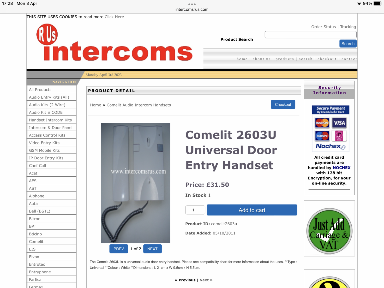

Hi,
Apologies for bumping a VERY old thread but I have the same issue.
According to an electrician friend who has checked all the wiring, everything seems to be working EXCEPT the handset actually buzzing when the doorbell is pressed!
Unfortunately the replacement Bitron handset you linked to looks like it's discontinued as well... what would be a good current replacement?
Thanks!
Would be my go to universal handset
