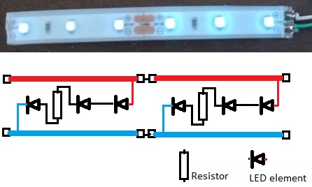

LED elements convert electrical current into light and heat. The amount of current that flows through the element determines how much light and heat is produced. Too much current and the LED element over heats and is destroyed.
An LED element cannot control the current that flows through it. The current has to be controlled by a driver that drives the correct current through the element.
The simplest driver is a resistor in series with one or more LED elements together with a DC supply of a controlled voltage.
This is two modules cut from a 5 metre strip that requires a 12 volt DC supply.
Using more elements in series allows for higher supply voltages. This method, with about 80 elements in series, can be used for mains voltages in cheaper lamps.
