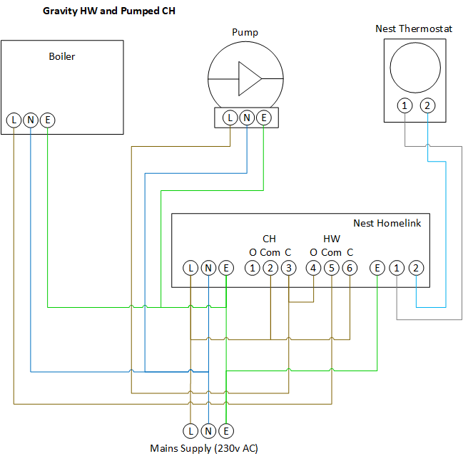

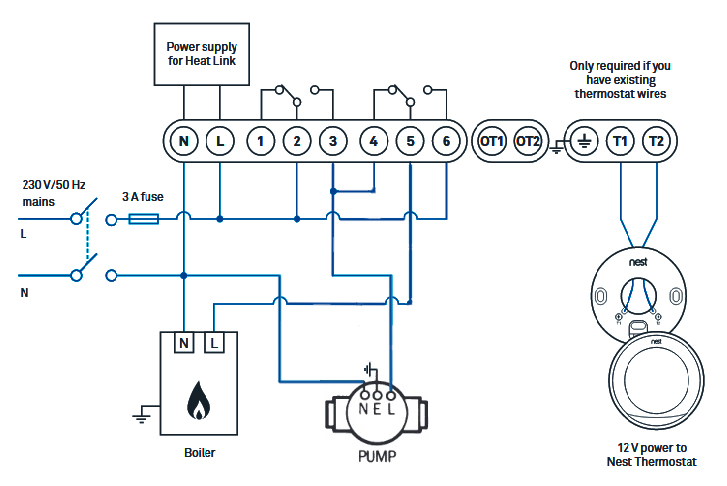

A clever way to wire up the Tado, is like this example with a Nest...
Where ignoring the Nest thermostat connections,
Randall L would connect to L on Tado
N to N
HTG to CH NO
HW to HW COM
A small link wire added between L and CH COM and CH COM and HW NO
And a small link wire added between CH NO and HW NC
This layout has the benefit of switching on the hot water automatically (i.e. boiler), when only the heating is called for.

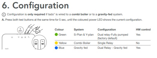

The Tado manual says the blue LED activates both relays (for CH and HW) whereas the yellow setting omits the HW relay.
Leaves me wondering what the difference is between the Green and Blue configurations, presumably this has to be the wiring configuration for the pump?
Then you have to wonder why Tado don't offer up a wiring diagram for gravity fed systems. I can only presume it is internal pumping versus external pumping CH feed? Leaving a need somehow to get power to the external CH pump in a gravity system when CH mode is active. How the external CH pump is presently switched should become clearer when I take the cover off the Randall timer, hopefully.
The Blue LED mode mentions dual relay switching - i.e. it will (presumably) automatically switch on HW NO, if only central heating is called.
This would mean Randall HTG would connect to Tado CH NO
And DHW connects to HW NO
There would need to be links added between L, CH COM and HW COM.

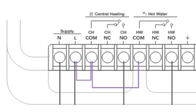

I've found a suggested gravity wiring recommendation on the Tado community forum that looks OK to my untrained eye.
Randall HTG to CH NO
Randall DHW to HW NO
Bridge Live to CH COM
Bridge CH Com to HW COM
Combine all neutrals on N
Mains feed to L
Pump live to CH NO
Combine all earth on Earth
I will need three cables running to the Tado. Plugged mains feed (L, N and earth), Pump cable (L, N and possibly earth) and Boiler cable (HW, CH, then I'll need to figure out the boiler neutral from the current Randall wiring setup). I've checked and there are 3 cables running into or out of the Randall.
So, I should end up with:
3 leads in the N
1 mains lead in the live and one bridge
2 bridge in the CH COM
The boiler CH and Pump live in the CH NO
1 Bridge in the HW COM
The boiler HW in the HW NO
2 or 3 earths in the Earth
Does anyone see a problem with this wiring setup?

As @RandomGrinch has pointed out Nest Gen 3 the output is on the Com C-Plan_basic_Nest.jpg but with Hive you can't connect to Com, so they use an internal configuration or software fix where one contact does boiler and the other does the pump, both work equally as well as each other.

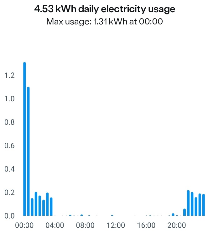

I can only quote British Gas prices for electric, standing charge 62.21p per day single tariff, with 29.57p per kWh used. With the EV tariff and with BG you do not need an EV to get the tariff the standing charge drops to 59.14p and the peak 31.31p per kWh and off peak (5 hours) at 8.95p per kWh. Our dish washer, tumble drier (heat pump) and washing machine all have a delay start option, so can run over night. I can also run during the day when loads of sun shine, but this requires my solar panels and battery to work. So only looking at cost electric v oil and clearly to have off peak you need to use it for more than DHW.
I use peak power in the evening as shown here 1724756472555.png but most of my electric is used 1 am to 5 am at cheap rate.
So is it really worth heating the hot water tank in summer using oil? It is a lot of messing around, working out when to run the boiler, if the hot water tank had a thermostat then may be worth using oil, but without, is it worth it? I have pressed the button on the iboost+ and it says saved today 0.24 kWh, this equates to the power used to maintain the DHW temperature, by end of day may be 0.5 kWh so at 8.95p per kWh looking at 5p a day to heat DHW with off peak power, if no off peak then 15p per day.

This wiring configuration on the Randall does work with the ability to run water heating only or central heating which heats the water at the same time.

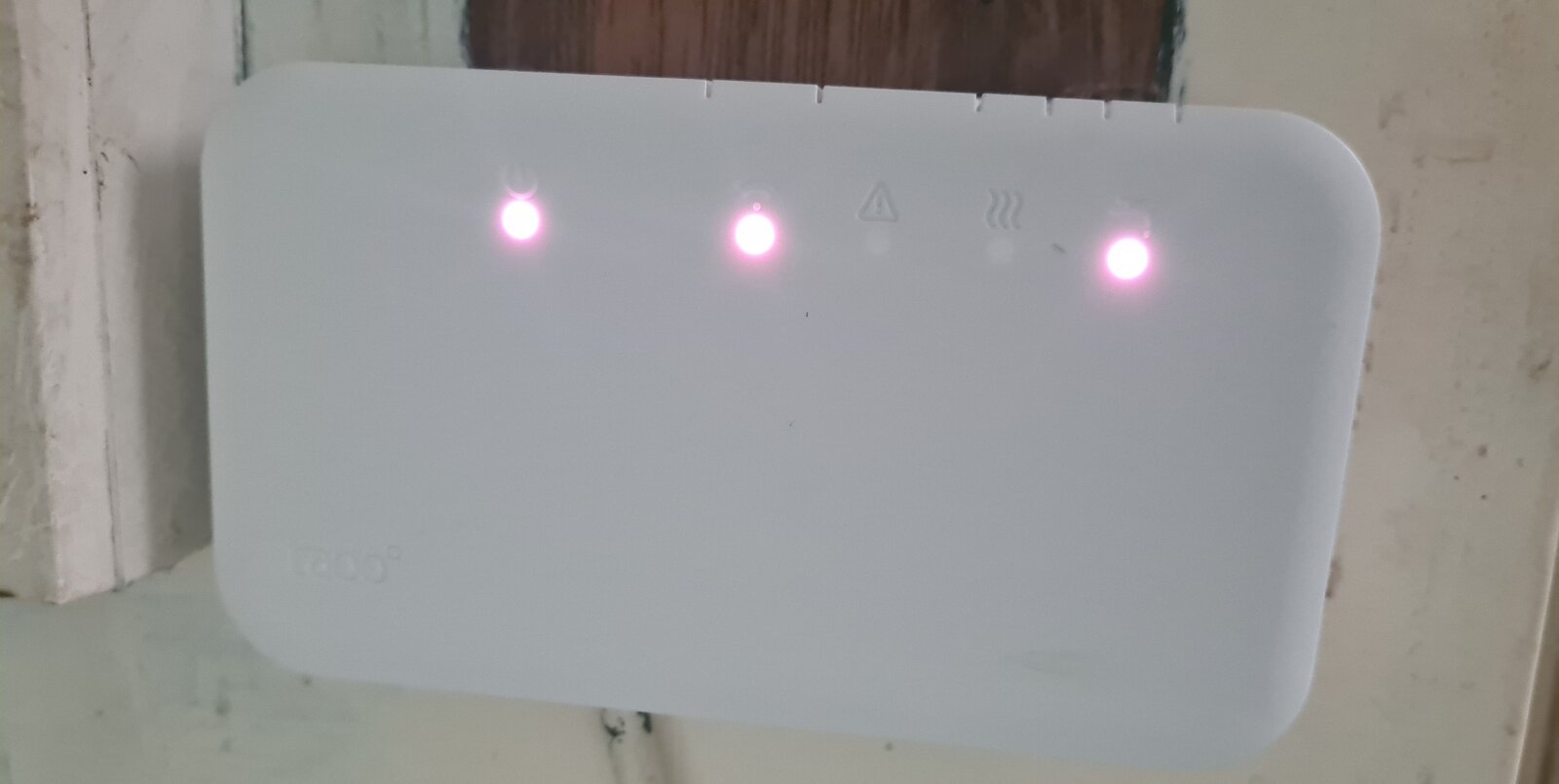

Wired up as per last post with two common bridges to live and the HW plus CH wires labelled up and fitted to their respective NO terminals; and it is functioning. The only thing I have noted is that the boiler cycles on and off more often than it did with the Randall controller. The cycling occurred even with cold water in the tank and a request to heat the radiators. Still, it is heating the water and it is heating the radiators separately.
The initial water heater ON from the phone app.
The subsequent request to also heat the radiators from the phone app.
Thanks to all for their input, it was a quick fit only made a little difficult with the access to the mounting board, peeking, fixing wires and tightening screws around a corner.
