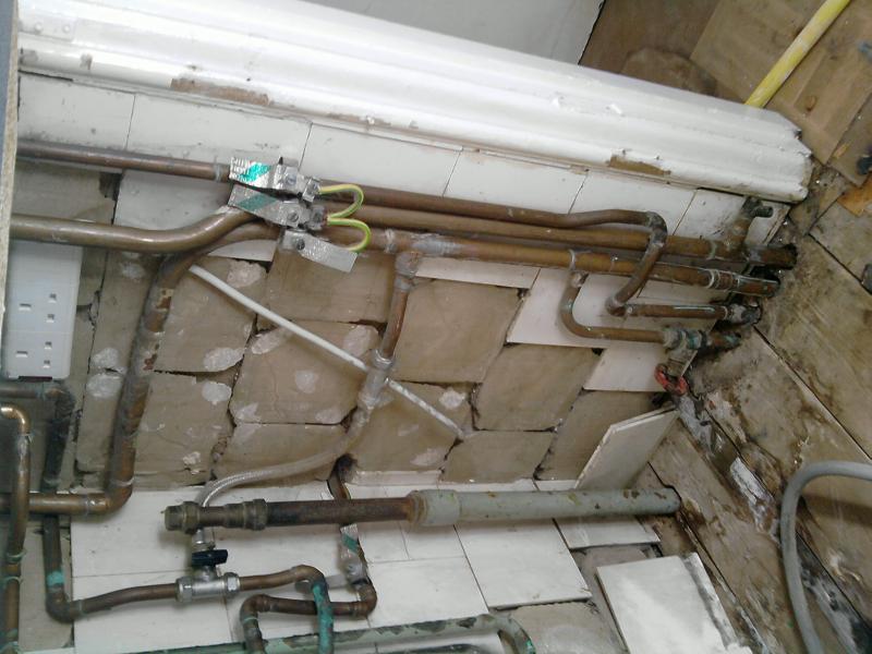

replacing a rusted gate valve

Hi: I discovered a rusted gate valve (red handle on 15 mm pipe coming up through the floor and then going at right angles) with the handle shank rusted away so it won't turn (on the bottom left of the larger diameter pipes leading up to the central heating boiler - picture needs turning 90 degrees to be upright !)
Presumably in lets water into the central heating system - there are no leaks from it, but because the handle is rusted I don't know if its on or off, but probably on.
I would like to replace it, and can do basic plumbing with compression fittings, but would like to know if there are any precautions I should take, or things I should check before doing the job.
Any advice welcome !
I would say that was a by-pass valve.
Replace it with a Honeywell DU144 valve with compression reducing sets.
You will need to drain the heating system to do that.
Thanks Dan. The rusted valve looks like a bog standard 5 quid gate valve with the circular red shut-off handle you find under sinks. Its 15mm pipe as well and not 22 mm like the Honeywell.

Loosening the gland nut might allow it to be turned.
