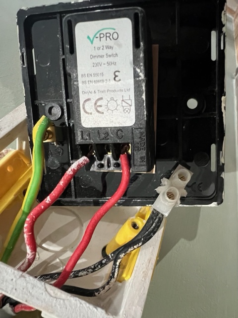

I currently have a single gang dimmer, operating a set of 4 downlighters in the kitchen, wired as follows and as shown -
RED live supply wire going into C
RED feed coming from light into L1
BLACK wire from circuit & light JOINED
EARTH wire from circuit & light JOINED to back of switch

Yes that will work. But L1 or L2 would be the supply, and common is the lights. Doesn't matter often, but smart dimmers need it that way.....
You pretty much have it correct.
Permanent live looped to each switch ,and switched live ( and neutral) to each fitting ( or group).
Earth conductors together at switch plates earth terminal.

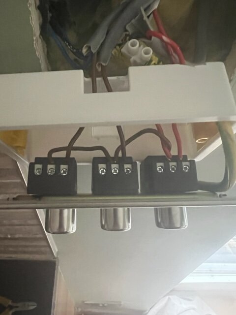

Hi ELF, or anyone else
everything now fitted as described above, however, wondering if the new 3 gang dimmer may be faulty
wiring as shown in the diagram left to right as follows
dimmer 3 far left dimmer 2 middle dimmer 1 far right
L2 empty L2 empty L2 empty
C, looped with C on dimmer 2 C, looped with dimmer 1 C, permanent live in & looped to dimmer 2
L1 switched live to light 1 L1 is switched live to light 2 feed L1 is switched live to light 1
All Nuetrals connected together at rear, and all earths connected to rear of socket
all lights are working, getting a live signal on all L2's when switches are off, and then a live signal on all L1's when switches are on - which im sure is correct, but im getting a slight cracking sound from dimmer one when turning the dimmer
Re check all connections at dimmers ,and neutrals.
If still the same , swap dimmers 1 and 3 positions on the faceplate.
If the same dimmer is crackling in a new position it's likely to be duff.
Are all dimmers and respective lamps/ bulbs/ LED's compatible ??
hi Terry, checked all connections, haven't swapped dimmers yet, but I can see the dimmer module is sparking inside
