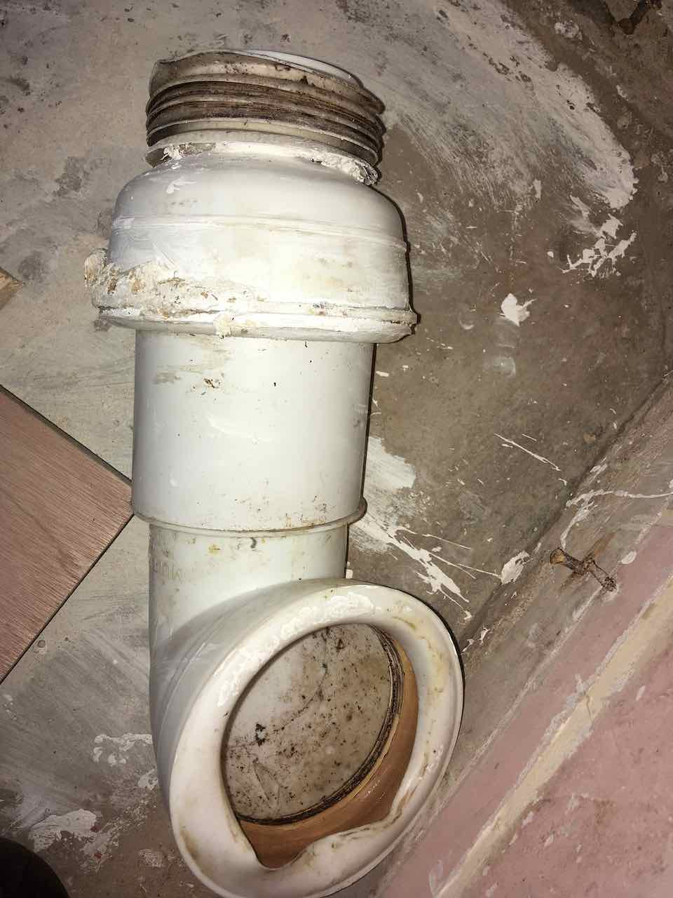

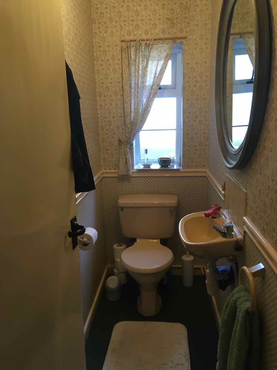

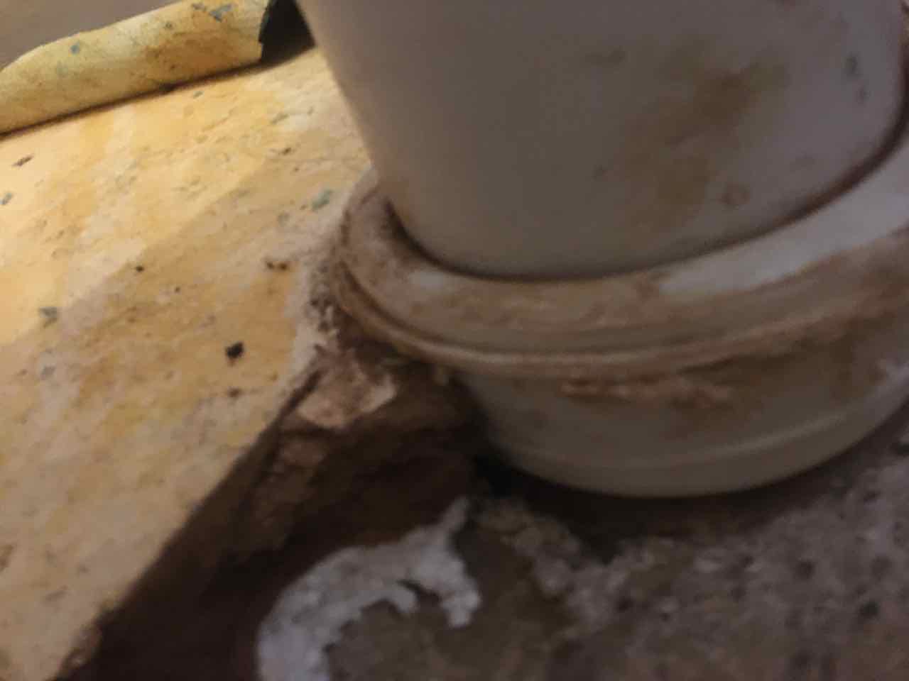

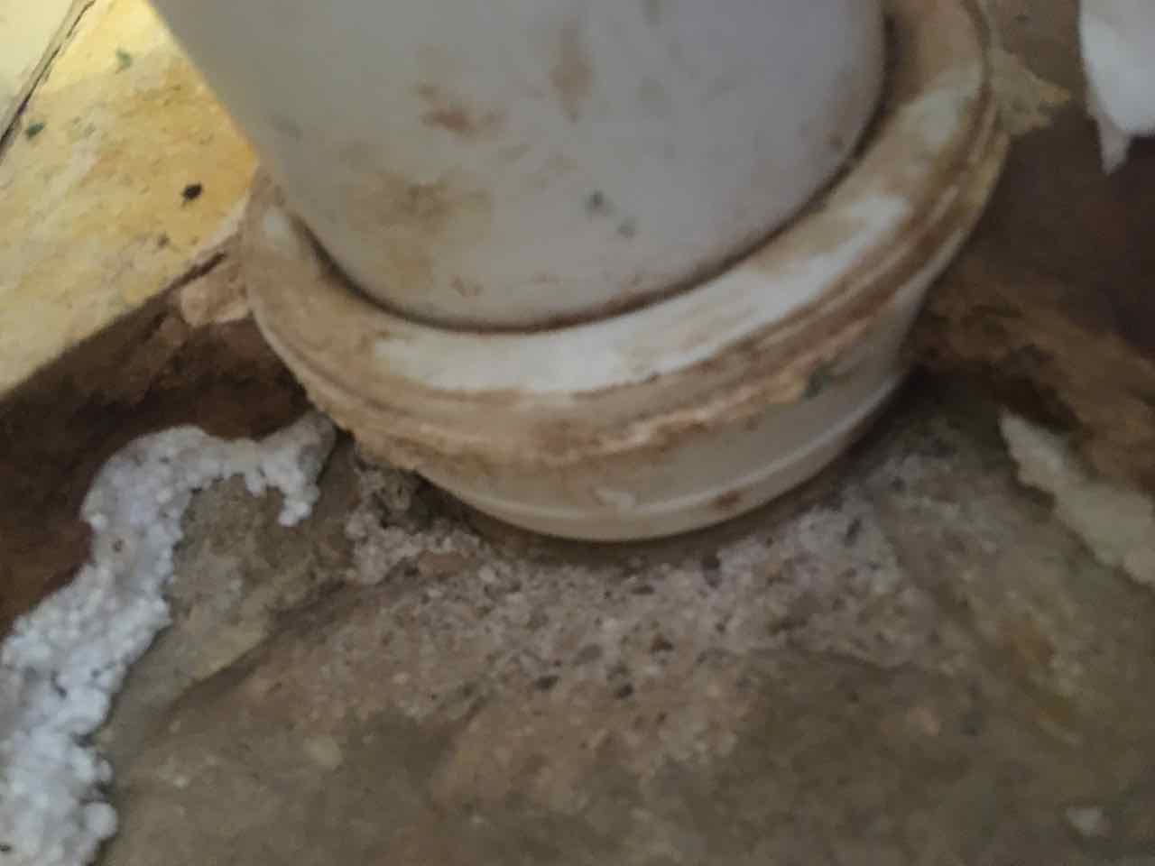

I'm about to start work replacing the floor and toilet etc in our very small cloakroom.
Suspended Chipboard floor, on concrete
my local Aylesford Timber yard
I will be putting down Eco-Versal Insulation PIR Board , with some 6mm marine ply on top
at at least thats my thoughts - Maybe ply/board under the new toilet for fixing

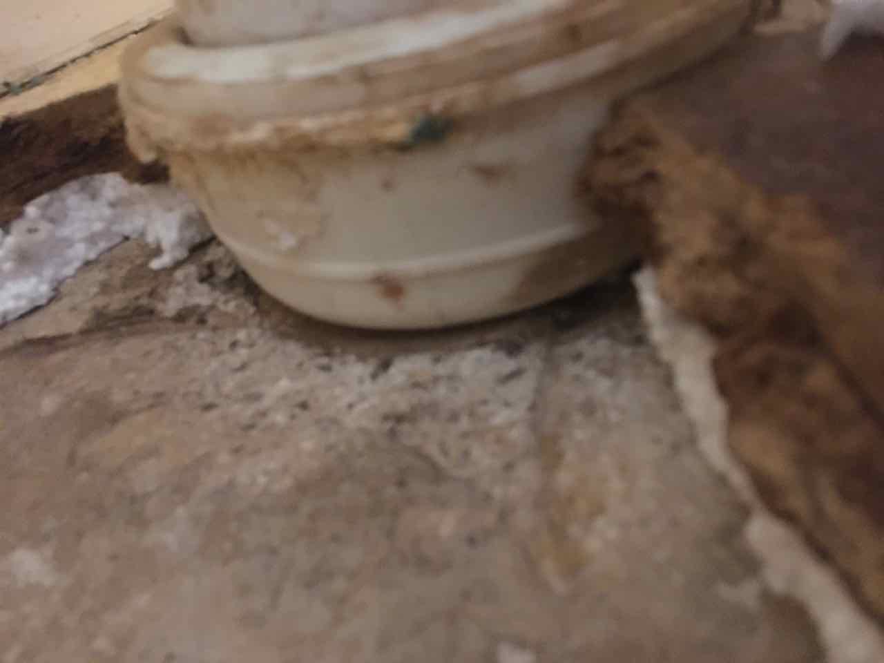

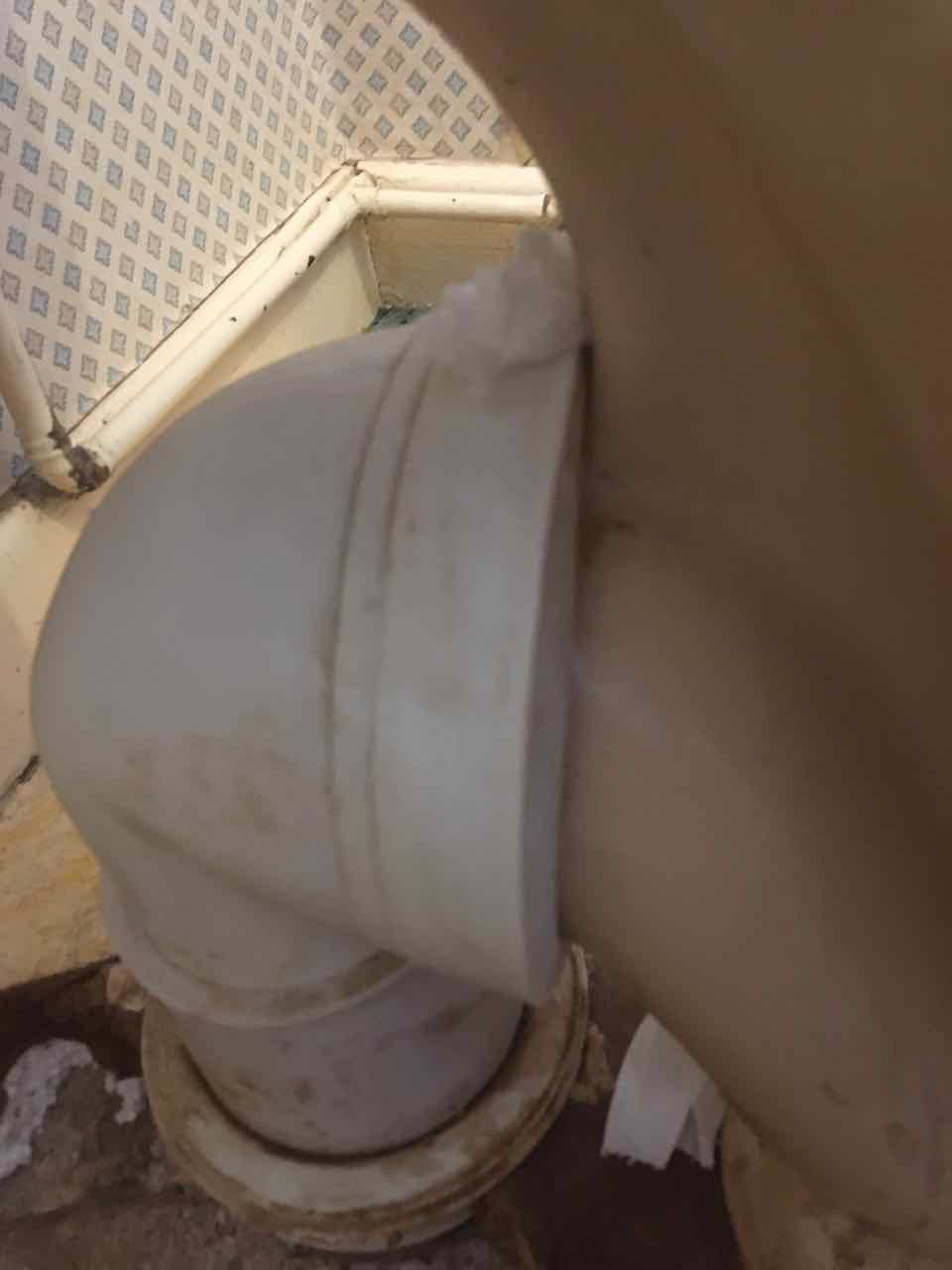

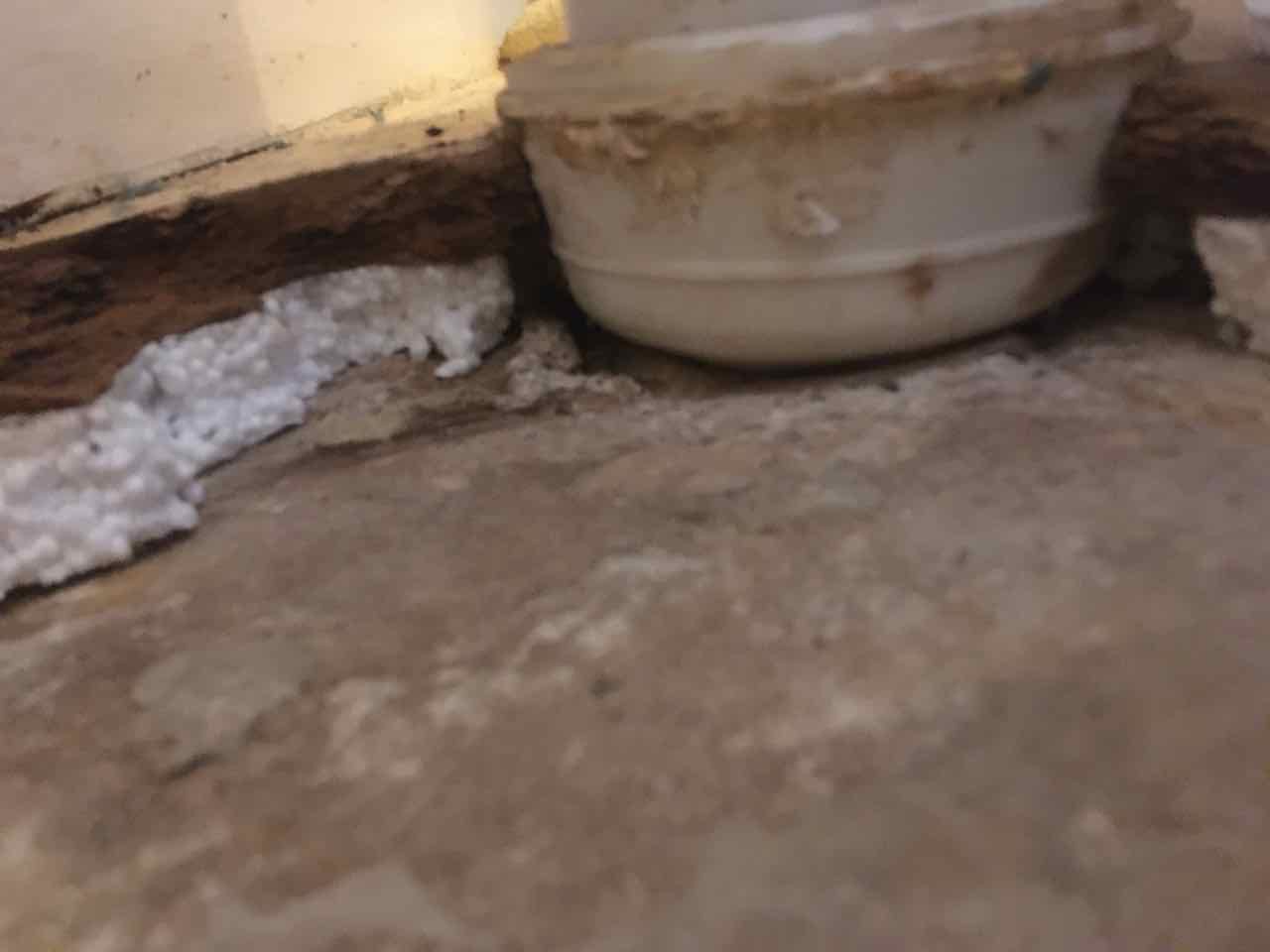

I wondered what the connection for the toilet waste is, I was expecting to see a Ceramic/china clay hole , which i had in the other house and the waste just pushed into that
Just not sure what i have here , having taken a bit of floor up to investigate
I will be replacing the toilet , with a victoria/edwardian maybe a backto wall , close coupled rimless unit
or may put a cupboard in
anyway, photos attached, advice on what I need to replace all for new
Not sure when the toilet was installed , before 1997 for sure
house is a 1932, but the. cloakroom was part of an extension , probably 60's

It looks a little bit like a white soil pipe connection (like a 90 degree bend) with a 90 degree pan connector.
Thanks for the reply.
I'm expecting all the supplies to arrive during next week (Toilet on Thursday), and will check they are all OK and then probably stripout weekcommencing 17th - so will send some photos then

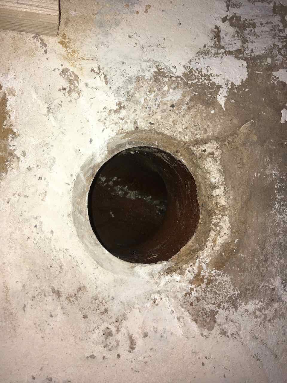

I'd say the original WC would have been a S trap, so collar in the drain to accept the outlet spigot from that. New WC installed later 80's/early 90's at a guess, (whisper cream/grey/peach/etc was all the rage when I was an apprentice, along with the Horizontal Outlets that my Gaffer used to curse), so 90° on 'new' pan outlet, straight into existing collar from old pan. If you pull that old collar out the floor, you'll find the drain.
If i can then , I hope to take the collar Out to reveal the drain. Then put another collar back in for the new floor level , height from concrete floor to new raised floor is 42mm (will be the same as old level). and a new 90 connector
Is that the Best plan, or try and keep the existing old collar , amd clean up all the silicon and reuse the collar and a new 90 connector
Replace the collar, if it doesnt seal again you will be in trouble. If you find the 42mm is too much, look at a McAlpine DC-1 drain connector, fit that in the floor, then a stub of 110mm pipe into that, with pan connector into the 110mm pipe to make up the difference.

Which will go direct into a drain 4" clay Drain Internal Diameter
