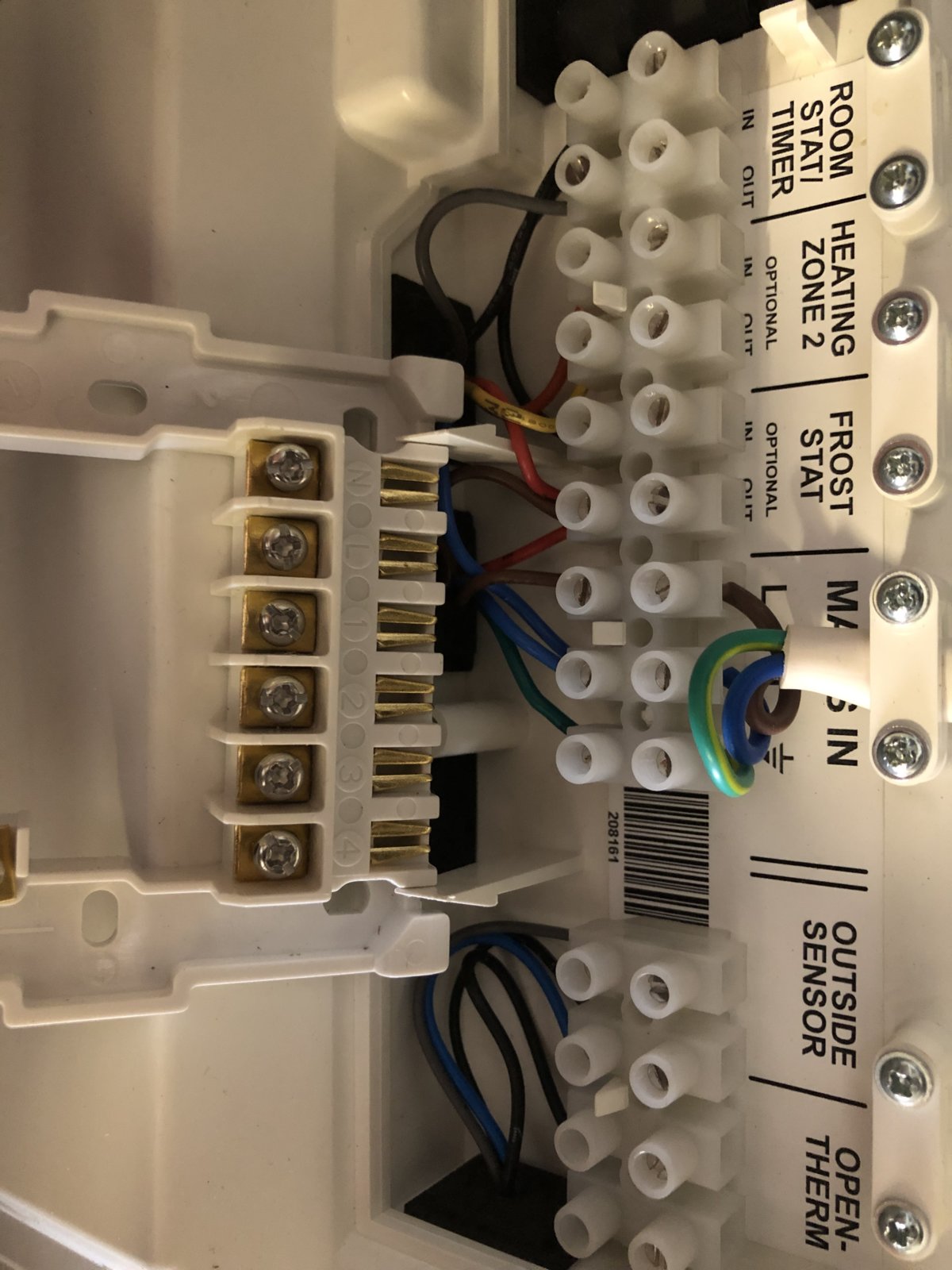

Hi guys,
I am relatively new home owner and working on my electric DIY skills. I have recently bought a HIVE central heating unit and want to replace my built in wireless thermostat with the hive one. However, opening up the Ideal Vogue c32 boiler the sea of wires has stumped me. Is someone able to confirm, really simply, which wires go from the old theremostat to the new one? Pictures below. Thanks I really appreciate any help!
the sea of wires has stumped me. Is someone able to confirm, really simply, which wires go from the old thermostat to the new one?

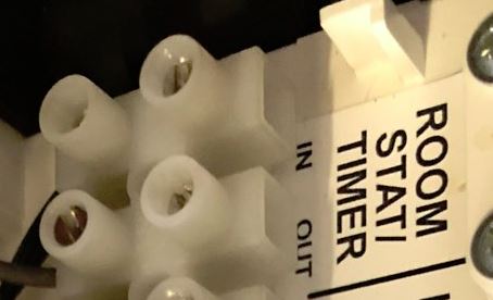

The wires in the terminal marked 'Room Stat'
They go to the Hive (you need the single channel version) terminals 1 (Common) & 3 (Heating on). It doesn't matter which way around.
Then a 230V supply fed via the same 3A fused spur that supplies the boiler go to the L and N
On some Ideal Vogue boilers, to access those terminals it is necessary to open up a room sealed compartment to access them. If that is the case it is not a DIY job and should only be done by a RGI (Gas Safe Engineer) who can make sure that the boiler is properly sealed up again afterwards.

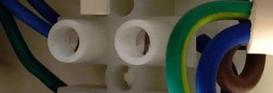

Thanks Stem,
Two wires feed into the Room Stat In, assume both go in 1/3?
A couple of N coming from the other side of the supply line, does it matter which?

Thanks Stem,

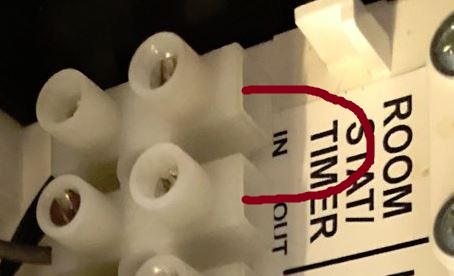

Do not remove or alter any of the existing wires, they stay exactly as they are. The Hive wires are additional.
The terminal marked 'room stat in' needs a new wire to Hive (3) heating on
The terminal marked 'room stat out' needs a new wire to Hive (1) common
Sorry not sure I understand that and to be honest, it worries me slightly that you don't understand what you are doing. There is only one N terminal and there are actually 3 wires in it.
The neutral wire to the Hive will be a fourth.

Ok so now I am confused, sorry! I thought I was replacing wires that go to the current internal theremostat to the new hive one.
So from your latest post I need 4 completely new wires...
-1 new wire from the bottom of the Room Stat In terminal into Hive 3
-1 new wire from the bottom of Room Stat Out terminal into Hive 1
-1 new wire coming out of the bottom of the N terminal into Hive N
-1 new wire coming out of the bottom of the L terminal into Hive L

I look at the picture of inside your boiler and question why there is no loops on the room stat /timer, heating zone 2, and frost stat? I would have expected to see a loop of wire which needs removing at least on one of those.

However I would want to read the instructions for your boiler, and work out why there is no loops in the room stat /timer? Maybe there is a dip switch, or it needs a computer plugging in and configuring? Normal is you remove loops to fit room stat /timer to fit an external timer.
The wires on the left of the terminals in your photo are connected to the boilers internal circuitry they should not be moved or touched under any circumstances. The internal thermostat / timer will probably be connected to the boilers printed circuit board, and not to those terminals anyway.

Yes. That is what the terminals are provided for.
What happens regarding the internal boiler controls, will depend on how it is configured. There are several variants of Ideal Vogue, I know of at least 3. If you haven't removed a wire link between the Room Stat terminals as per below, and it is working as it should. You should find that setting the internal boiler time controls to be permanently 'off' will be all that is required, and the Hive will take over control.
