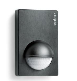

Best to use a lamp and a separate PIR. This allows the PIR to be located where it will be more effective at detecting people. When the PIR is part of the lamp people walking straight towards the lamp may not be detected by the PIR. PIRs are much more sensitive to people walking across the field of view than they are to people moving towards or away from them.
Steinel PIRs are more expensive but extremely reliable
https://www.tlc-direct.co.uk/Products/STIS180W.html
There are other suppliers of quality PIRs
