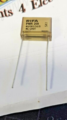

I found with my electronic switches that some bulbs worked, and others did not, these G9-comp.jpg bulbs caused my problems, with the small one, tried a load-capacitor.jpgload capacitor which stopped them staying on dim, but in the end fitted the larger bulb which cured the problem of shimmer as well as staying on dim.
One of the larger bulbs failed, so I opened to see what was inside, the smoothing capacitor was nearly as big as the whole small bulb.

LEDS will light dim if an electronic switch allows some small current to pass. They can also light for other induced voltage reasons. So the LED load(make/designs) may also be relevant.
I 'inherited' a decorative 5-led luminaire in this house that glowed in the dark when off and needed a 'snubber' to stop it doing so. Probably voltage induced from nearby wires passing?
